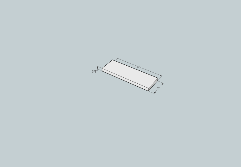

I don't know if I understand the problem so I created an object to your specifications and have printed it to see. Is this what you hope to get or is this an example of what you are trying to change?JPG40504 wrote:Anybody know how to get a small(6"x2"x3/8") part to print out at a realistic scale on the paper?? OR how DOES one set the print scale????
I get a very small set of lines in the middle of the paper. Attempts to change size, also shifts it away from the center of the paper?????? What am I missing????
sketchup
- Scale Test.png (20.43 KiB) Viewed 6332 times

Tell me how you got from sketchup to attachment(xxxx.png) and I will post a sample of what I WAS trying to print. Thanks to shydragon, I finally got printer output as desired!dusty wrote:I don't know if I understand the problem so I created an object to your specifications and have printed it to see. Is this what you hope to get or is this an example of what you are trying to change?

JPG40504 wrote:Tell me how you got from sketchup to attachment(xxxx.png) and I will post a sample of what I WAS trying to print. Thanks to shydragon, I finally got printer output as desired!
It don't know exactly when the conversion to .png (Portable Network Graphics) occurs but the process is as follows:
With the sketch that you want to print selected (in Sketchup)....
Select File/Export/2D Graphic....Select the destination where it is to be stored and name it.....and Export. It is now saved as filename.png.
This file will likely have to be resized if you intend to transport it to the forum (800x600) but it can be printed without resizing.
