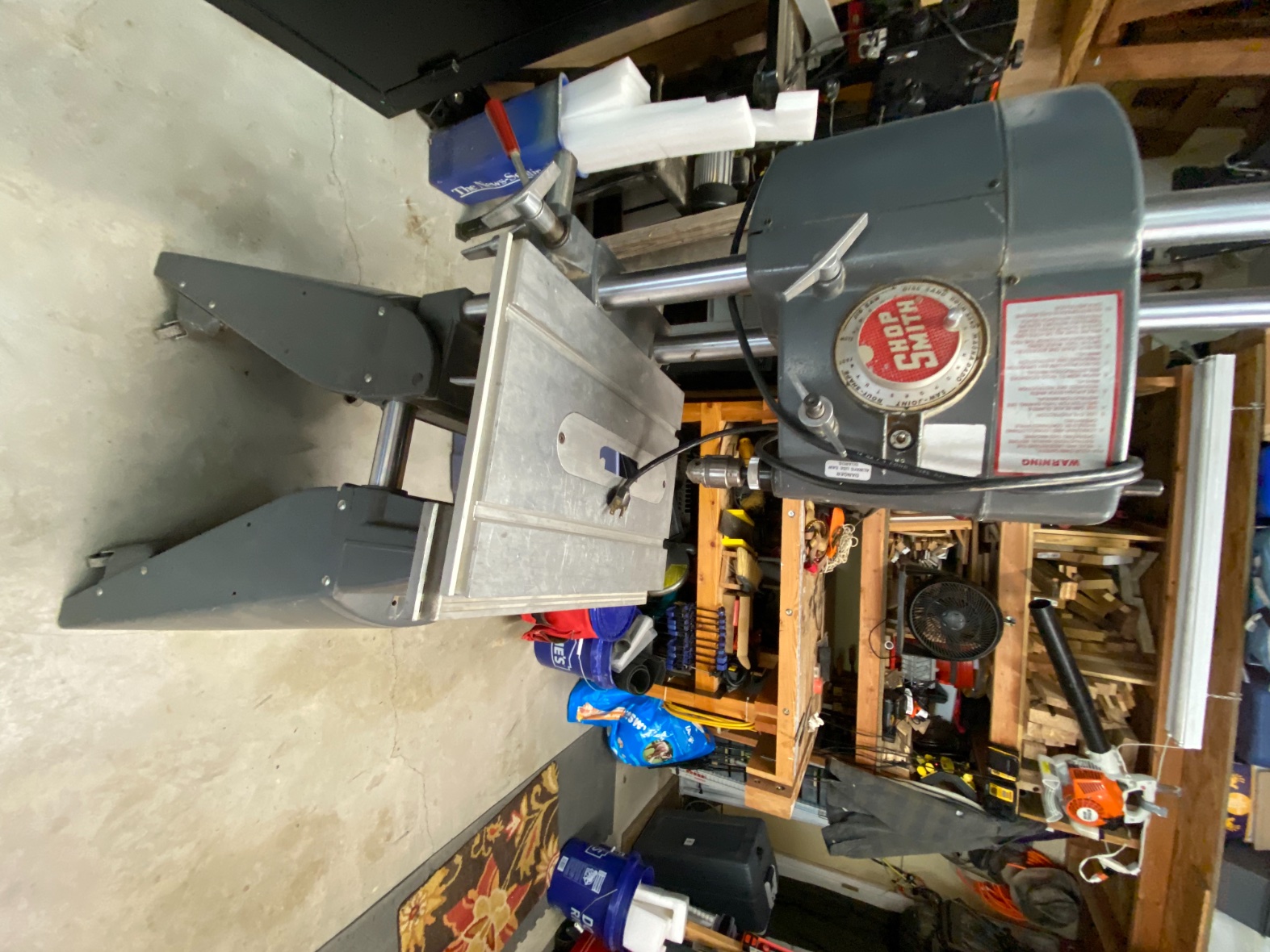

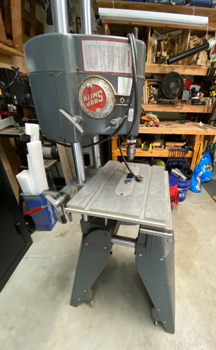

Did you cut the tubes at 9.25 also? Whatever you did turned out looking great. Nice work.
edma194
Posts: 2206
Re: Shorty dedicated drill press
Post by edma194 »
Yes, 9 1/4". You can see how short they appear in my picture and the picture from benmcn. It really is all that is needed for the smaller table.

Thanks for all your advise! I think it turned out great.
Posts: 4233
TPat23 Drill Press.jpeg (140.71 KiB) Viewed 2831 times

Looks good

Indeed! Interesting choice of table insert.
