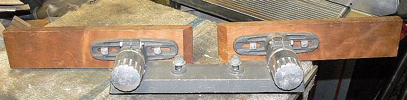

I hope you found the Shaper Fence for the Mark VII. There have been three different fences made over the years. The first is for the Mark 5 with the original table system aka Mark V 500 and will fit the Shopsmith Model 10's also. The second is specifically for the 1960's Mark VII and is show in the picture below. It has been out of production for a very long time. The third is for the Mark V 510, 505, 520 and Mark 7 all with the larger table system.
_
Mark VII Shaper Fence.jpg (67.67 KiB) Viewed 42086 times
_
Note the attachment bolts are in between the fence adjustment knobs and go through holes in the table.

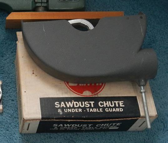

Stay with the lower blade guard you have currently. The original one made for the Mark VII is a cast aluminum guard that wraps around both sides of the blade and is not extendable. It is in the picture below.
505705 Saw Dust Chute.jpg (50.84 KiB) Viewed 42086 times

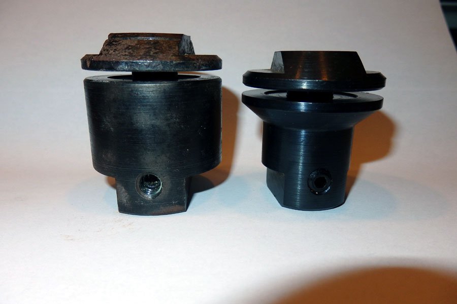

I am not very familiar with Mark VIIs from the 1960's, but based on my experience with my Mark V (500), the difference in length between a 555321 and a 555608 is about 5 mm. I know this because I mistakenly purchased a 555608 arbor before I understood the differences. The 555608 worked and I used it for several years before getting the 555321. I simply had to use the quill extension to get the blade to be more or less centered in the saw table insert. I don't recall, but I was probably using it with a spacer in my lower guard. Whether the previous version of a 5/8" arbor for the 505/510/520/Mark 7 (P/N 555118) is also 5 mm longer, I don't know. And whether or not the 555608 or the 555118 are even an option for your Mark VII and your lower guard, I don't know.
(NOTE: My overall length measurements are approximate, with a gap left for approximately a 1/8" thick blade on both arbors.)
555608 left, 555321 right
555608 length 57mm
555608 length 57mm
555321 length 52 mm
555321 length 52 mm

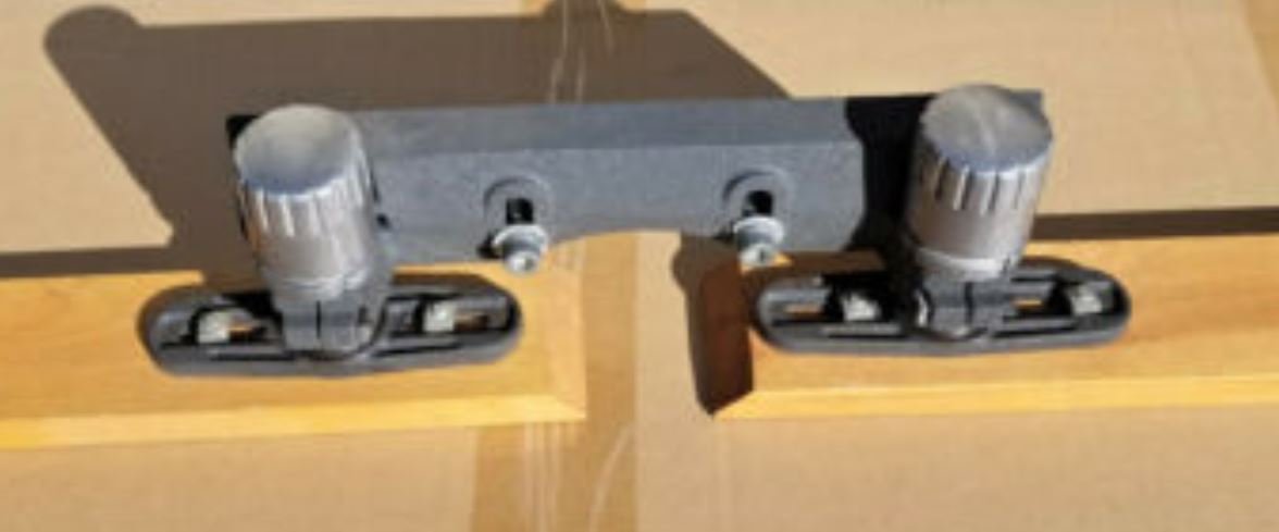

chapmanruss wrote: Tue May 04, 2021 12:16 am I hope you found the Shaper Fence for the Mark VII. There have been three different fences made over the years.
This is a picture of the one I bought. I had holes already drilled in my table. I measured the distance between them at 3 3/8" center to center and had the seller confirm the same spacing. I am pretty sure it is correct, and looks like your picture. It was an impulse buy. I already have a separate craftsman router and table. ;)
Thanks for the info, really appreciate it.

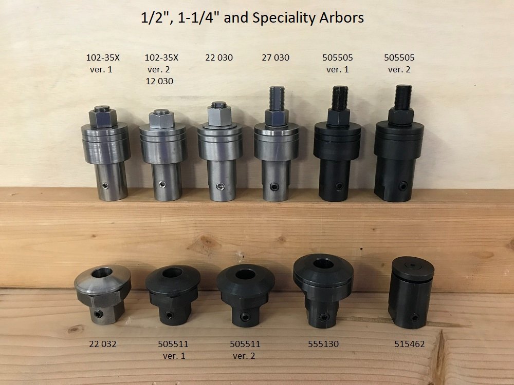

If you checked out the link br549 provided in a previous post you should have found two PDF's in my post. Scroll up from where the link takes you to that post. One has a picture of many of the Arbors from over the years and the other is a listing of the Arbors with additional information. The pictures below are more complete than the one in the PDF. Use these pictures as a reference to the PDF with the listing of the Arbors. These pictures do not include the Shaper Spindles, Router Chucks or SawSmith Arbors.
_
Arbors page 1 - labeled.jpg (150.85 KiB) Viewed 42061 times
There was an error in the labeling of 12 031 and 22 031 in previous postings of the above picture. Anyone having saved it should replace it with this one.

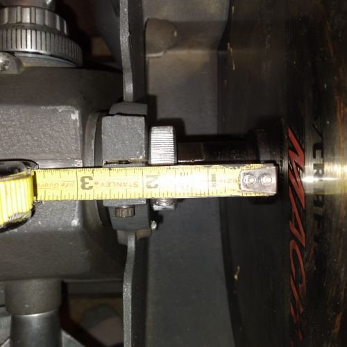

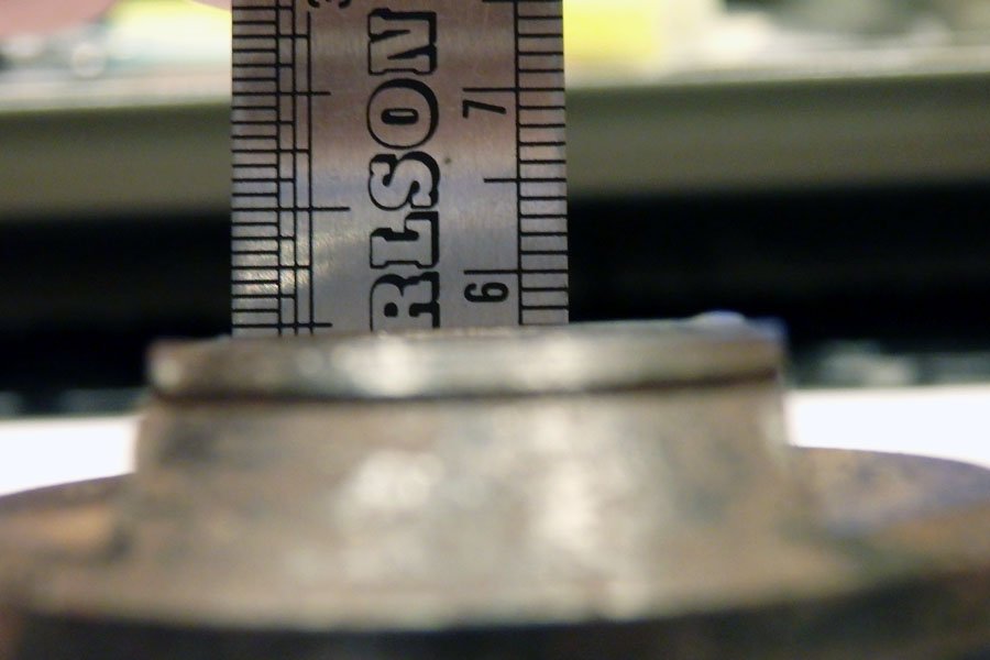

Yes I do need the guard spacer. The arbor looks like it sits back further on the 10ER than the VII. See my picture below as compared to yours above.
chapmanruss wrote: Tue May 04, 2021 1:07 pm The 5/8" Arbor P/N 555321 puts the blade 1-1/2" out from the base end of the arbor.
Yes, I know the picture below doesn't show it well, but 1 1/2" basically will put my blade where the first washer (arbor spacer) is now. If it does fit in the guard, it would be uncomfortably close. I may just stick with what I have. I don't see a real benefit to switching to the 555321 after all.

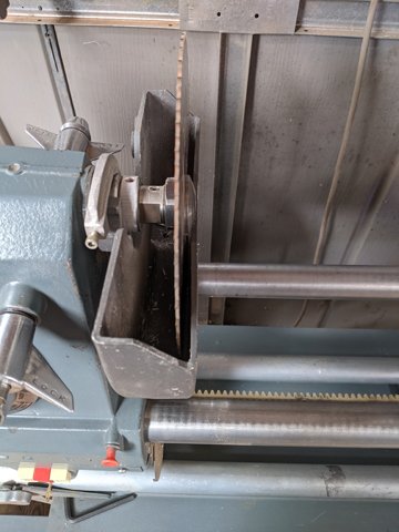

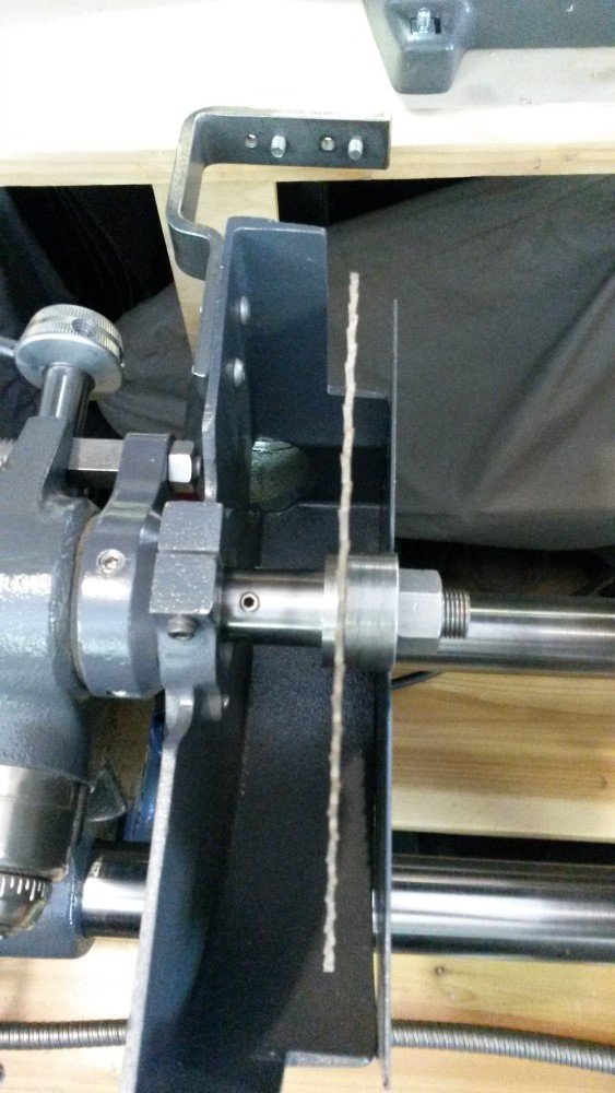

An idea that hasn't yet been explored in this thread is blade choice for the Mark VII. To use the original system (aluminum guard as pictured below, carriage lock aligning the blade to the table slots), you'll definitely prefer to use the original short arbors and 9" blades by Magna. Those blades come available frequently on Ebay and such for not much money, they're of high quality for their time and sharpen up well. I haven't seen any carbides, but having the standard blades sharpened is inexpensive too.

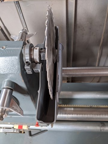

The second photo is of the same setup (also 9" blade) using a 3D-printed guard I recently purchased through the Facebook Shopsmith User Group. It will take the 12" sanding discs, whether cast aluminum, flat steel or conical, and uses a set of bolt-in spacers to provide for whatever arbor you need. This allows me to use the 10" Magna blades (including carbides) in the Mark VII system. If you like another blade, your sharpening service can probably bore it out for the short arbor.
Mark VII blade setup.jpg (33.35 KiB) Viewed 41912 times
Mark VII with all-purpose guard.jpg (28.73 KiB) Viewed 41911 times
