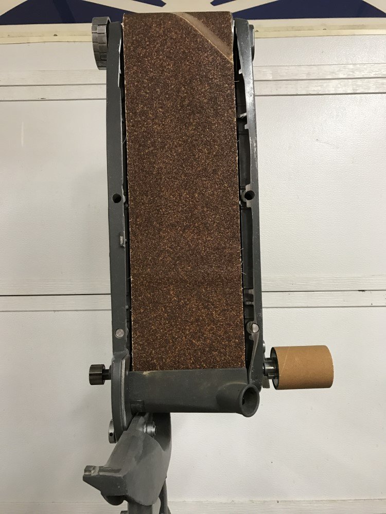

If the Belt Sander has a manual with it, it will guide you through set up and use. If it does not have a manual with it you can and should buy one from SS or a used one. There are operation instructions in the manual that are very helpful in using the Belt Sander. Belt tracking and how to adjust it is an important part of learning how to use the Belt Sander. There has been little change made to the Belt Sander since it's introduction in 1955. The real difference is the change to eccentric mounting posts and the dust collection port changing from a 1-1/4" port to a 2-1/2" port which is an easy upgrade. I did it on my 1977 Belt Sander. The one below has the 1-1/4" dust port. As with all Shopsmith Manuals a newer manual will have more detailed instructions than older manuals. The January 1989 Manual I have has 38 pages compared to early manuals with only 8 pages.
In the picture below notice the right side frame where it is worn away by the belt because of poor tracking. A costly mistake since to replace the outside frame is currently $56.05 plus shipping not to mention damaging the sanding belt and it's cost. This is a Belt Sander I purchased with a group of Shopsmith SPT's and a Mark V that I restored and resold.

Another feature of the Belt Sander is the ability to mount is on either side of the headstock since the drive shaft goes completely through the drive drum. It also allows mounting a drum sander for a multi function sanding station as shown above.

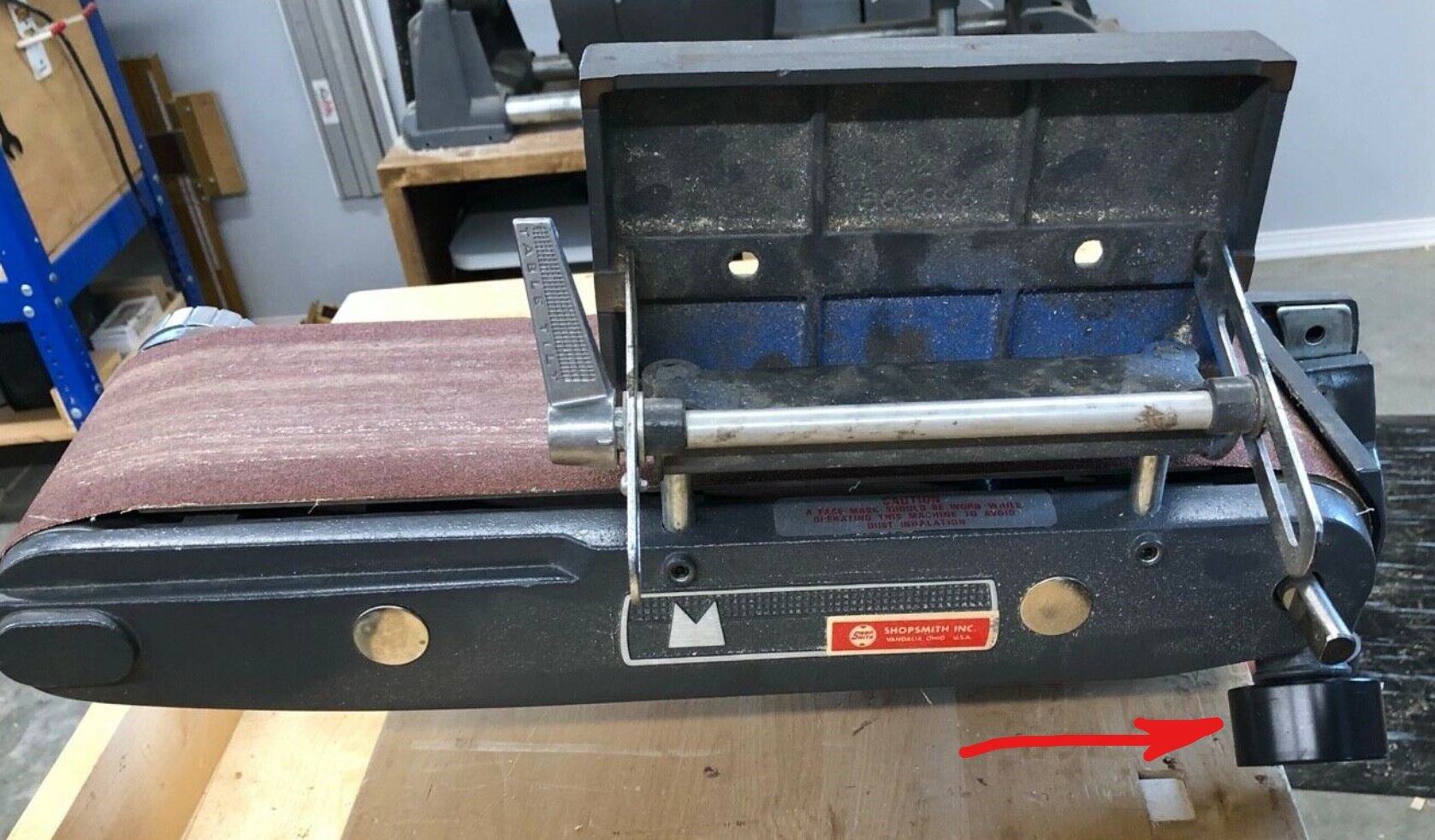

Thanks for the great info. I was able to find a 38 page pdf manual and I am thinking this will good to use as I hear not many changes over the years. To be honest, I'm not exactly sure what the exhaust port size is, looks small. Below are some screen capture pics of it. I think the red arrow is pointing to the exhaust port? It does not appear to have the damage you mention unless the damage is on the other side? I am hoping it's in decent shape and not missing anything. I asked the seller if the bearings were good, hopefully they are as he stated. I don't mind putting in some time and money to repair it if needed. I like the small sanding drum you have mounted to the side.

Yours has an adapter attached to the dust port.

I should have noted that the picture is the back side of the Belt Sander that is showing where the belt wandered off track and ground down the back side of the Outside Frame. As JPG noted the one you are looking at has the original 1-1/4" Dust Port with a 2-1/2" adapter. Before I changed my Belt Sander to the larger 2-1/2" Dust Port I used an adapter like it. The thing I did not like about having the adapter I was using on it was the end would contact the belt inside the dust port. I believe I get better dust collection with the larger port too.
It is common to find extra parts with used Shopsmith Tools. The Hub for the Belt Sander is the one for the 5/8" shaft. Other SPT's have a 1/2" Shaft. There is a cover that normally comes with the Belt Sander to go over the shaft end when not in use like having a sanding drum mounted. I did not see it in the pictures. It is part number 5030049 called the CAP-SHAFT and is $4.95 from SS. The larger Dust Port is available as an upgrade and is 300002 Belt Sander Dust Collection Retro-Fit Kit for $22.85. I think you would find the Dust Collection retro-fit a worth while upgrade.
