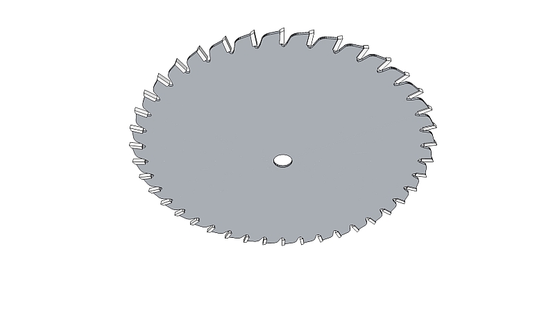

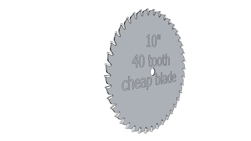

Must be learning a few things... Presenting a 10" 40 tooth blade, 5/8" bore.
[ATTACH]2421[/ATTACH]
[ATTACH]2422[/ATTACH]
Radial hey???
Radial hey???
- e-blade.jpg (35.94 KiB) Viewed 6959 times
- e-blade 2.jpg (45.28 KiB) Viewed 6957 times

Very nice Ed. The more you learn, it's really a pretty productive tool, isn't it. It has it's quirks, but...

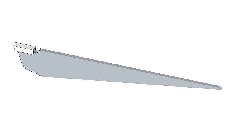

Hi Dusty,
BTW the key here was to make one tooth segment then put 39 more together to make the blade... and well hidding some lines.
[ATTACH]2423[/ATTACH]
- 1 segment.jpg (20.33 KiB) Viewed 6944 times

Ed, That's the trick with constructing something like that, work smarter, not harder. BTW, you mentioned hiding some lines. You can DELETE those lines instead of hiding them, and it turns the resulting surface into one surface. There are some free plug-ins out there that can perform that task (Delete coplainer lines) automatically which really simplifies your model.reible wrote:BTW the key here was to make one tooth segment then put 39 more together to make the blade... and well hidding some lines.

I keep working with the fact this is not a solid modeling tool and I miss a lot of the features I have worked with on other 2D systems. Some of the tools are very new to me like the follow me tool... haven't used it a lot yet but from what I have done and seen this is way cool.
Actually the hiding lines was not very hard in this model but since I didn't know about the tool (until I read about it) the model looked like a mess when I first created the other 39 teeth. At least it wasn't bad to go back to the one segment and hide the lines and see it clear up.
