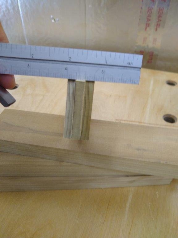

Alright - attempt #2 . I dug around and found a 1/4 router bit that needed sharpening but should provide thre 1/3, 1/3, 1/3 dimensions Ed mentioned above.
I did the tenons this morning - with a 3/4 depth. 1/4 spacing all around.
m+t v2.jpg (37.35 KiB) Viewed 1941 times
m+t v22.jpg (70.04 KiB) Viewed 1941 times
Is this the standard dimension ...now that i made those huge tenons the first time-these look kind of dinky :)
b

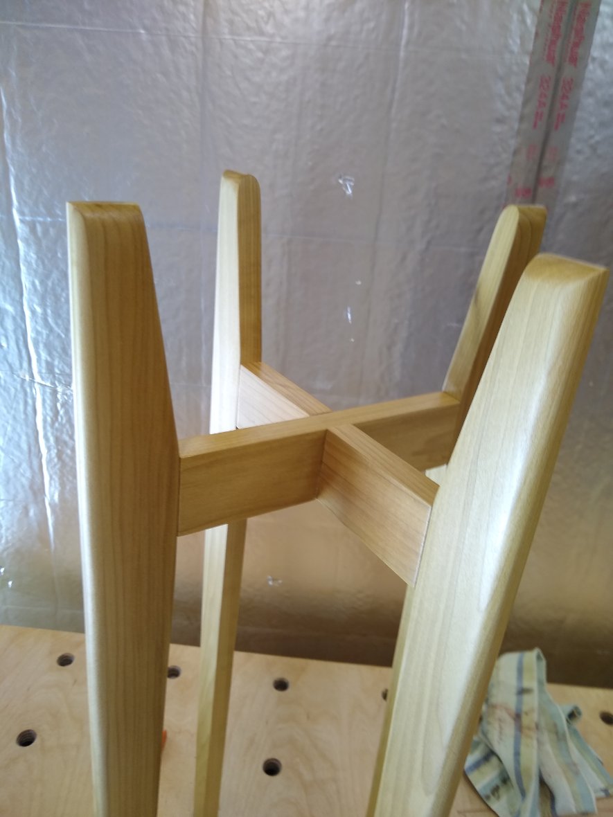

Alright-I'm getting a bit better at this now..burning thru the poplar though !
I think they are good enough to gift some now.
