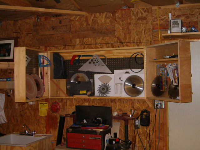

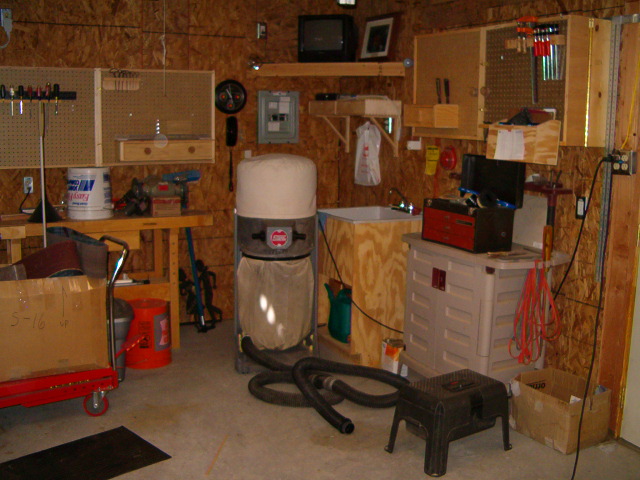

The two cabinets you see in this photo are each hung with 2 boards mitered edges like Ed showed us. The boards are each 3/4" by 2" and almost as long as the cabinet is wide. The backs of the cabinets are 1/4" peg board, mounted into grooves on all 4 sides. The top of the cabinet cleat is flush with the top of the cabinets.
The smaller of these cabinets have been moved from Texas to Calif. then again in CA. The neat thing is I hung a sign on the cabinet telling the home buyers the cabinet did not stay. It is not really attached to the wall other than resting in it's cleat.
Second photo is the inside of the smaller cabinet.

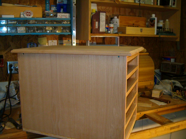

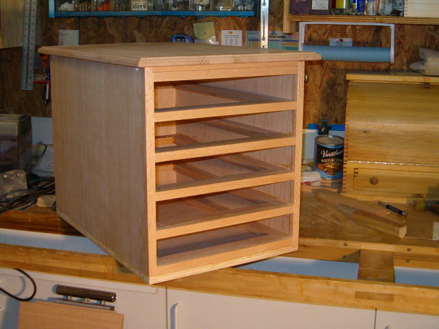

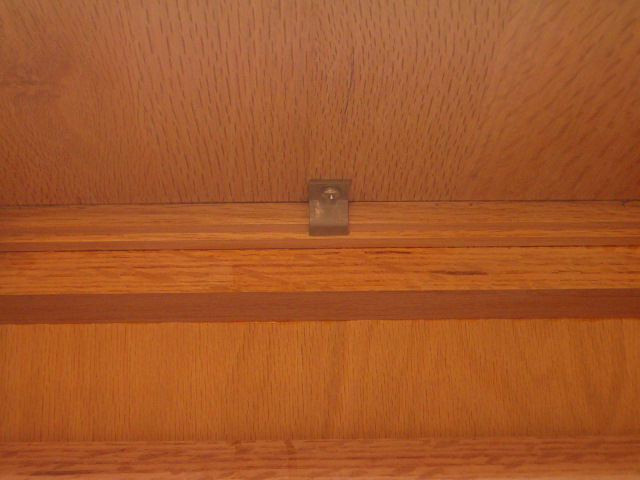

Here are a couple of photos taken this morning. The first photo is of the front, the second the side (shows the #8 x 1 1/2" screws screwed into the 1.2" top cleats) (The cleats are also glued to the top web/drawer frame) The 3rd shows the table top clips I chose to use to secure the top to the cleats.

charlese wrote:Here are a couple of photos taken this morning. The first photo is of the front, the second the side (shows the #8 x 1 1/2" screws screwed into the 1.2" top cleats) (The cleats are also glued to the top web/drawer frame) The 3rd shows the table top clips I chose to use to secure the top to the cleats.
LOOKS good!!! Are those retractable bench top extenders in pix 1,2? NEAT!:cool:
Thanks for some pictures Chuck!
It looks deeper then what I was guessing from the squint images on the web... How deep is it, as in front to back?
