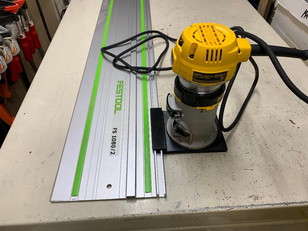

There are rubber strips under the track to help hold it in position and there are clamps that fit in the bottom channel of the track for alignment when cutting. There are a couple of companies that are making router adapters for the different tracks. Festool has an adapter for their router to be used with their track but it does not work with any router. Makita also has one for their router but again only works with their router and is hard to find. Woodline has what they call a Dadoright https://www.woodline.com/collections/dadoright that will allow any router to work with specific tracks. There is a company on Etsy that is 3D printing adapters for specific routers and the domino to different tracks https://www.etsy.com/shop/ToolCurve?ref ... =955226532. Some of the accessories that work on the Festool style track have to be slightly modified to work on the Makita track because the track has a small lip for the anti-tip feature that is not present on the Festool track. I do not know if this lip is on any of the other Festool compatible tracks.

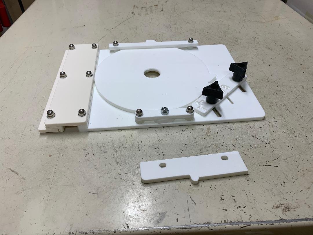

Brenda much have been checking out my shop:
BTW the router attachment needed a little tender loving care to fit...... and a set of screws to mount it.
