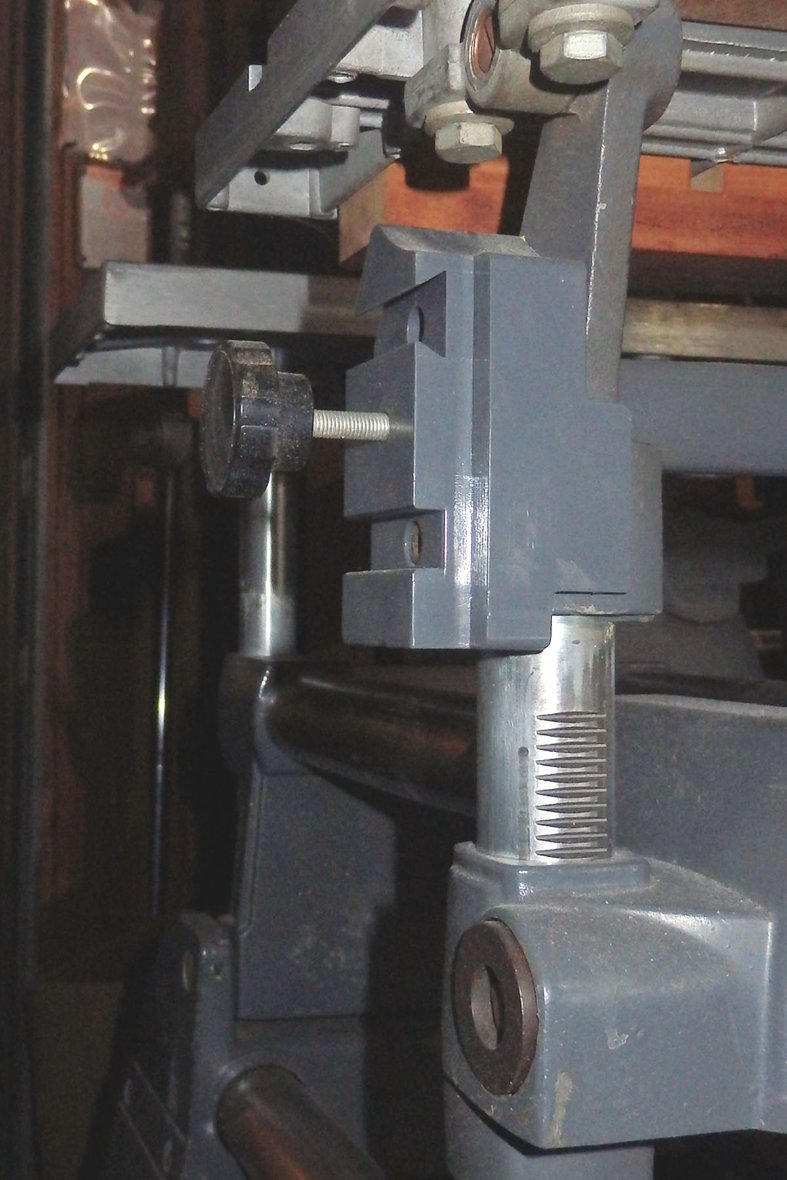

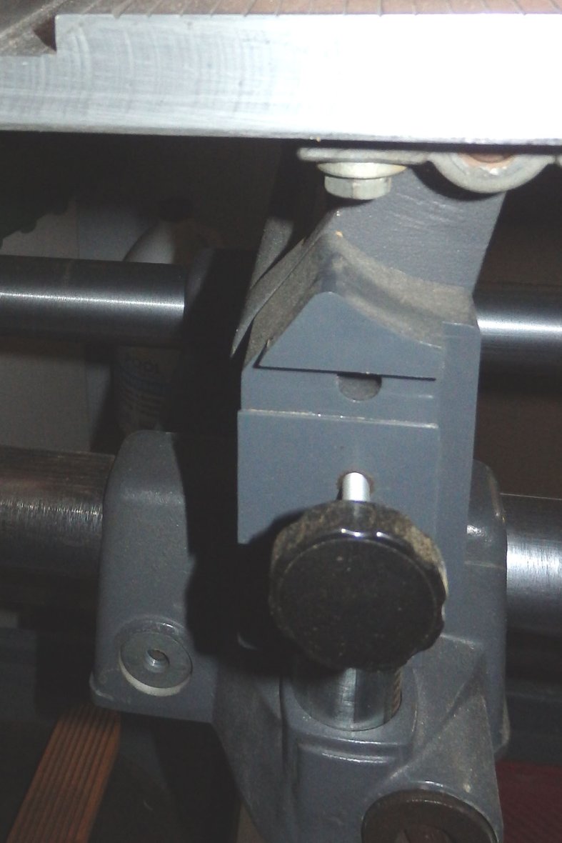

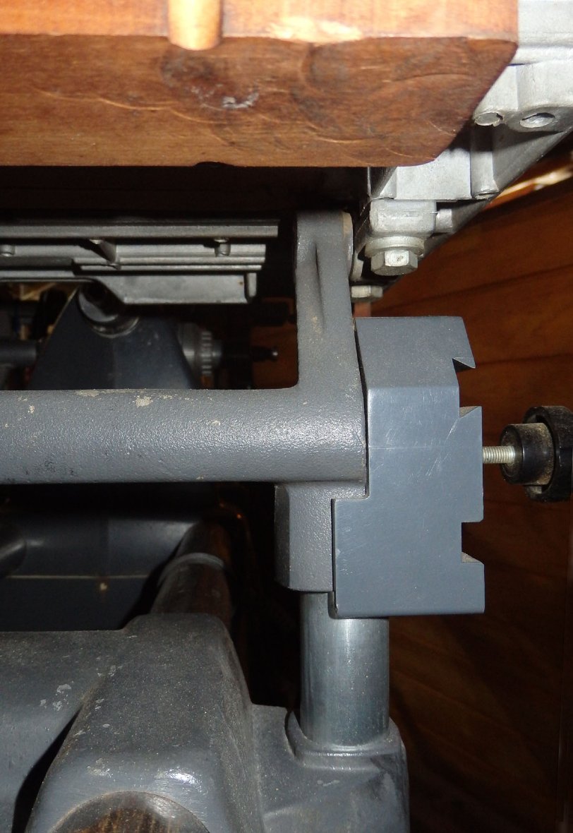

Here are a few better pics
- P7050100resized.jpg (139.99 KiB) Viewed 1818 times
- P7050101resized.jpg (127.19 KiB) Viewed 1818 times
- P7050102rersized.jpg (88.04 KiB) Viewed 1818 times

Manual for the guard.eagspoo wrote: Mon Jul 05, 2021 1:11 am
I got the exact upper guard you pictured (looks identical) however it unfortunately didn't come with the mounting block. Even so, it isn't clear to me how it is supposed to mount directly to the table. Can you share a clearer picture of the attachment with the mounting block to the back of the table?
Thanks!
www.lhdigest.com/SS/MANUALS/OTHER%20TOO ... 505875.pdf
Re: Best upper and lower guard option for Mark V 500?
How to the block actually attach to the table? Is it just friction/squeeze fit? I see there are two holes that might be for screws but my table doesn't have holes to accommodate those and the diagram in the pdf you shared also doesn't show any screws.

- Posts: 4541
The 505875 Saw Blade Guard set has the upper guard mounting block that uses two screws which go in the 2 holes shown in pictures 2 and 3 in br549's post above into the table tie bar and post. For older Mark 5/V's that requires drilling and tapping holes for that. In addition 2 holes have to be drilled and tapped in the tie bar for the part of the lower guard that attaches to the table tie bar. Some require removing a part of the edge of the table tie bar next to the rear post. The lower guard in this set cannot be expanded in width.

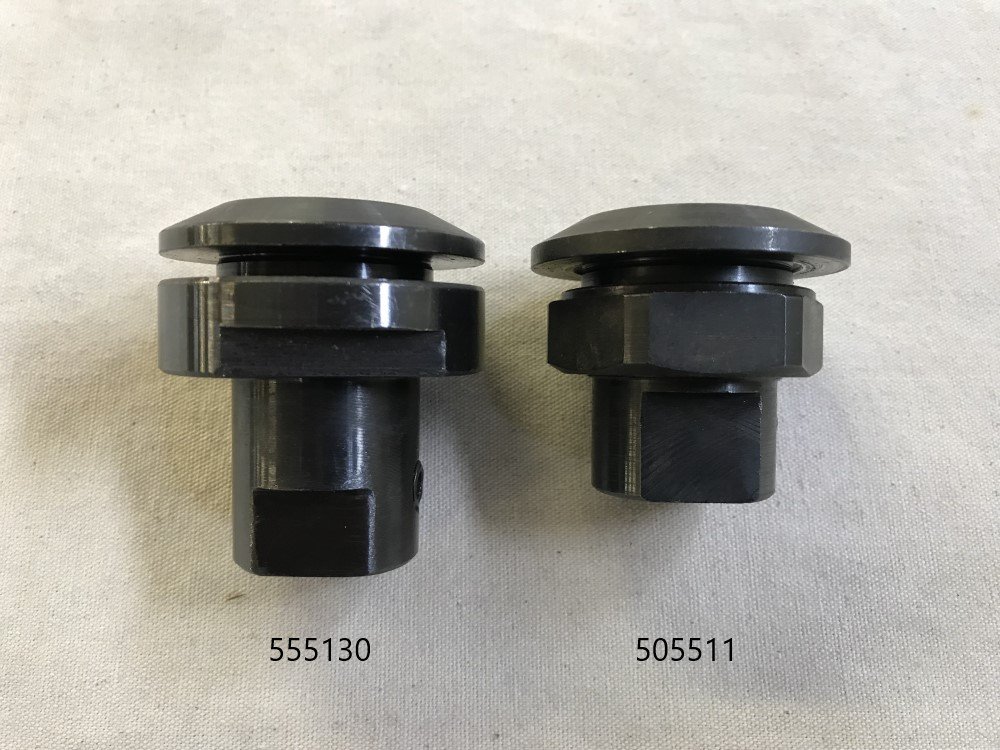

eagspoo, you said
_
That comment has me wondering if you have the correct arbors. As John pointed out above the Saw Blade Guards sets are different for the Mark 5 and Mark V 500 than the Mark V 505, 510, 520 and Mark 7. Because of that there are different length saw blade arbors and if you are using one for the Mark V 505, 510, 520 and Mark 7 it is longer and will cause clearance problems in the Mark 5/V 500 lower Saw Guard. In the picture below is the 1-1/4" Saw Blade Arbors. 555130 is for the Mark V 505, 510, 520 and Mark 7. 505511 is for the Mark 5/V 500 with the original table system.I'm worried it will have the same issue as my current lower guard (without the spacer I just bought) that it is too narrow to accept the arbor and blade safely, except that it will be worse because there is no way to put that spacer on it.
_
