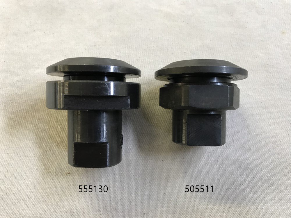

eagspoo, you said
I'm worried it will have the same issue as my current lower guard (without the spacer I just bought) that it is too narrow to accept the arbor and blade safely, except that it will be worse because there is no way to put that spacer on it.
That comment has me wondering if you have the correct arbors. As John pointed out above the Saw Blade Guards sets are different for the Mark 5 and Mark V 500 than the Mark V 505, 510, 520 and Mark 7. Because of that there are different length saw blade arbors and if you are using one for the Mark V 505, 510, 520 and Mark 7 it is longer and will cause clearance problems in the Mark 5/V 500 lower Saw Guard. In the picture below is the 1-1/4" Saw Blade Arbors. 555130 is for the Mark V 505, 510, 520 and Mark 7. 505511 is for the Mark 5/V 500 with the original table system.
