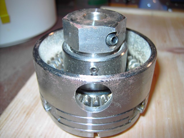

I don't have the Talon chuck, but I bought the G3 from SS and here is the chuck with the adapter. I couldn't get the adapter loose from the chuck, but they all look the same except for size.
George
Ft. Worth, TX.

How does your adapter connect to the G3?
