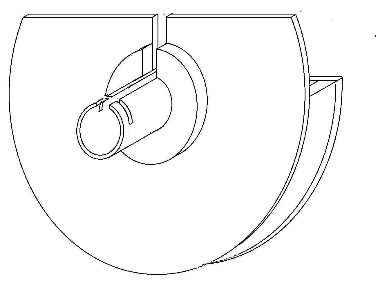

That's what I started out planning on. I was going to do something sitting on the way tubes as shown here: viewtopic.php?p=283508#p283508
I thought something mounted on the spindle would be ideal but there was the issue with the different hub lengths, and also finding easy to work lightweight materials to use. I found some 1/4" PVC panels that I think should be lightweight enough so I began to rethink this.
Below is a crude drawing of what I'm looking at. A piece of plastic pipe will slip over the quill and be held on with something as simple as a band clamp. The whole assembly is slotted so sanding disks can drop in and the pipe can slide along the quill to account for the different hub lengths. I'll use 3/4" and thicker PVC boards for spacing and reinforcement. I think I can toss together a first pass at this quickly and make sure it will be stable with this construction. If the 1/4" PVC material seems to heavy I also have some of the corrugated plastic stuff that is extremely light.
small disk shroud 3d.jpg (78.66 KiB) Viewed 1115 times
Ed from Rhode Island

I see nothing wrong with your concept; sizing the various pieces being the only obstacles.

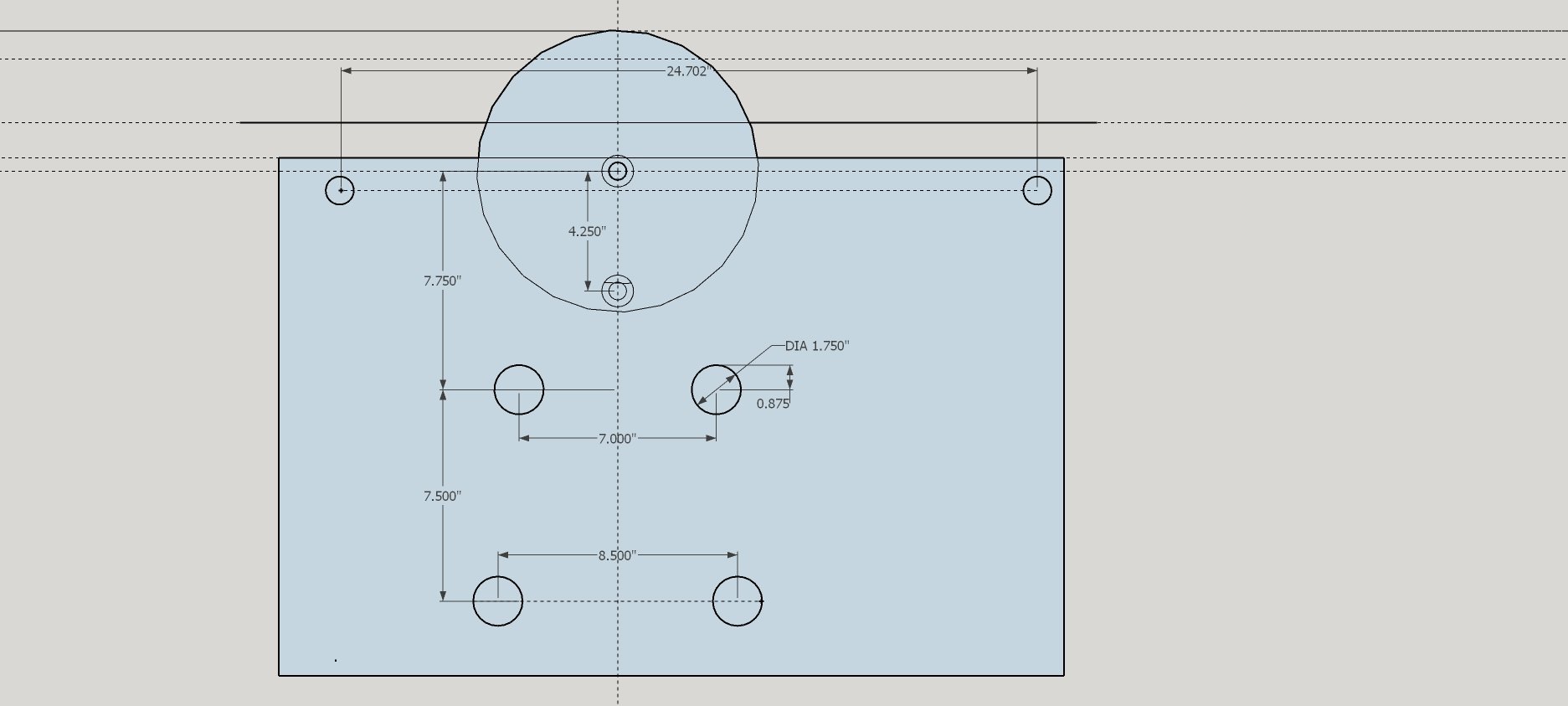

Maybe this will be of some help in sizing the project.
Shaft and Tube Relationships.jpg (93.49 KiB) Viewed 1109 times

That chute was high on the list. The one in the other thread has the advantage of simplicity, just rest it on the way tubes and there's room to move the disk in and out on the quill too. This one is attractive mainly for being interesting, kind of fun, and now it seems slightly easier to do than I thought before.
Anyway, if I have piece of pipe that will fit well on the quill I'll work up something quickly so I can see if I'm heading in the right direction.

dusty wrote: Mon Jun 07, 2021 1:32 pm Maybe this will be of some help in sizing the project.
Thanks Dusty, that's a great diagram to have on hand. Looks like the dimensions show a 510/520 table with extension tube locations and a table saw blade.
Re: Conical sanding disk thickness
edma194 wrote: Mon Jun 07, 2021 1:58 pm
Correct interpretation.
