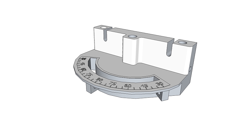

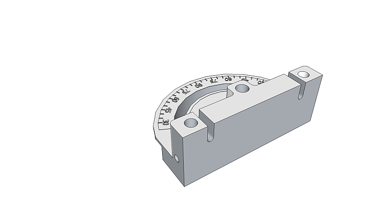

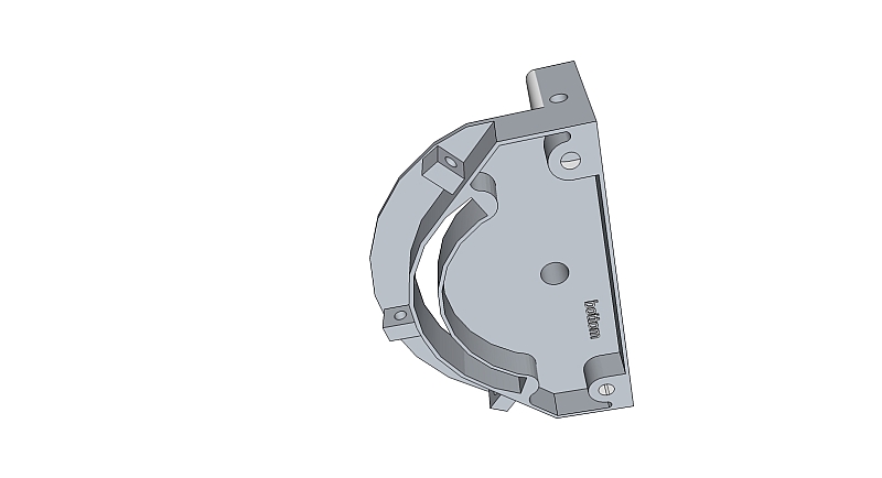

Even with all that I was able to get something done and this is what the miter head looks like.

I spent time trying to get the numbers to be indented like on the real thing but I guess I don't know how to do that without it taking a very long time... So the numbers are up instead of down.... I also couldn't find a good way to make the tick marks so I went back and found a type style that had the right "I" look and used that.

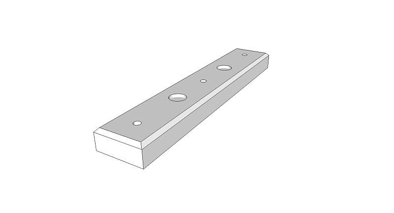

As far as those bases, I have only one. Most of the stuff works well with a 2 x 4 or 2 x 6 screwed down. I don't have the planer, which I'm guessing is the heaviest of the add-on's or the band saw, but the belt sander, jig saw, scroll saw and strip sander are all happy with this simple holder.
I even just now modeled it:

Ed, there's 2 methods of "flowing shapes" in SketchUp that I know of, the first is called the Sandbox mode, and is used for "organic" shapes like meshes and terrains. Here's an example of what you can do with Sandbox tools.reible wrote:I like the base! I think I had better learn the method of doing those flowing shapes... what is that called? Any videos or instructions I should look for? ...
The mesh on the left is "raw" and the one on the right is a direct copy of the one on the left that has been smoothed. There are tools that let you project onto the mesh surface, drop to the surface and push/pull into the surface. An interesting tool, but not what I'd use for something like the base.
To make the base, I used the Intersection tool. I first drew two shapes, the size and shape of the side view and top view of the base. I pushed these two shapes as shown here.
I then moved the two shapes so that they were on top of each other, selected all entities and did an Intersect Selected... (make sure the two objects are NOT grouped or combined first). It's then a simple matter of deleting the pieces you don't need. I then created a shape to match the front view profile, pushed that and did another intersect operation to finish the rough shape. Then drew a square, pulled it up and inset that into the front legs and did another intersect to get the recess for the front bolt heads. It really didn't take that long.
