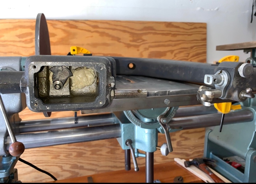

A-34 Jigsaw clamped onto the SS table to keep it from sliding while working in the crank box.

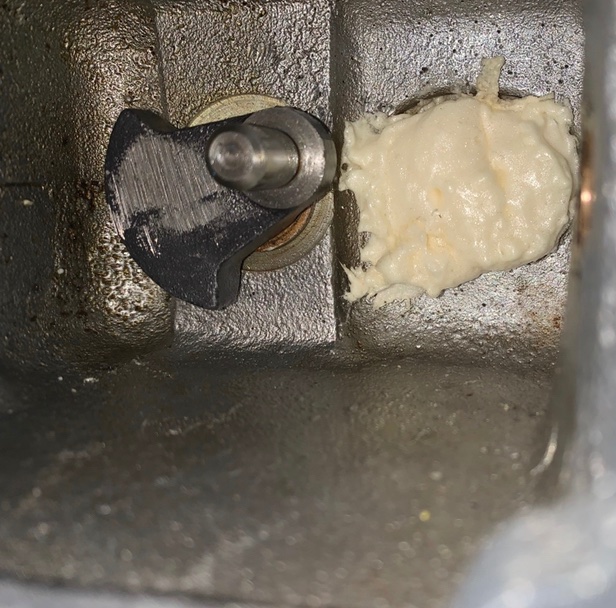

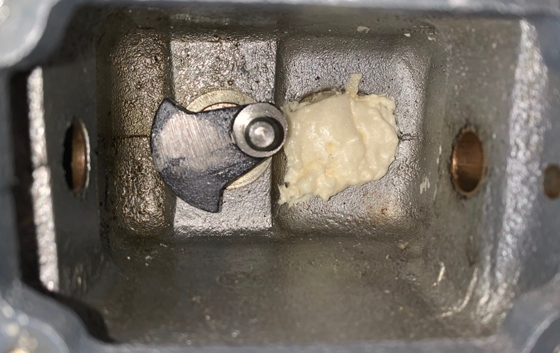

Close-up of foam filler in hole between lower base arm and the crank box.
Close-up showing how filler was trimmed to avoid the rotating crank.
