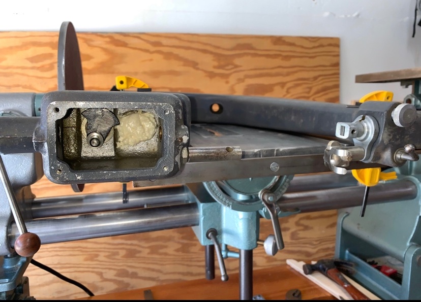

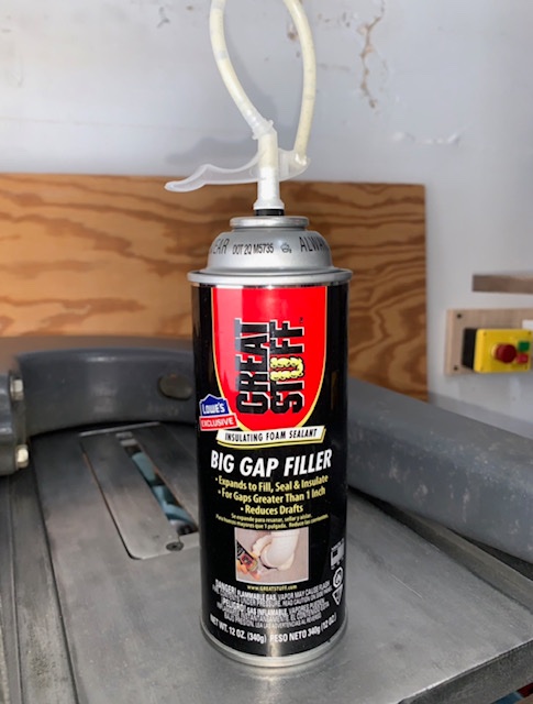

chapmanruss wrote: Tue Jul 06, 2021 1:25 pm Adding something to the base frame to keep dust out of the gear box area should not be a problem.
On a recent trip to Lowe’s I found they had two different types of foam fillers that plumbers use to fill the gaps created when routing pipes through walls; one type is for gaps smaller than 1” and the other for larger gaps. Since the hole between the A-34 Jigsaw crank box and the lower arm of the base frame is around two inches I used the latter type of filler.
“Great Stuff” is Lowe’s store-brand big gap filler

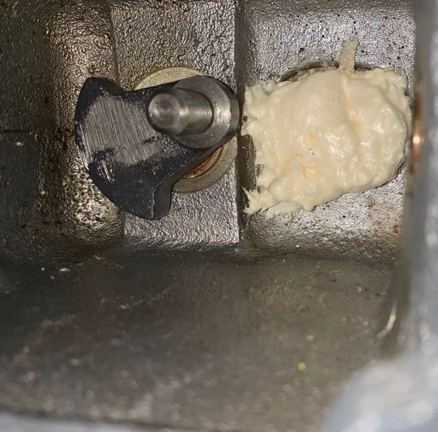

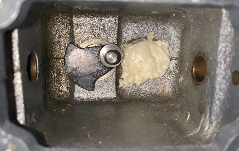

It did a great job filling the hole, but since I did not follow their directions that said to practice first, I ended up slightly overfilling the hole and had to remove a few of the components in the crank box to clean a little bit of foam from the lower chuck rod and crank link assembly. I also trimmed a small bit of foam that was rubbing against the crank when it rotated. This simple fix should keep sawdust from collecting in the crank box and prevent problems that might be caused by that over time. Before closing up the crank box I took the opportunity to add a little oil to the moving components. It’s ready for another 70 years.
A-34 Jigsaw clamped onto the SS table to keep it from sliding while working in the crank box.
Close-up of foam filler in hole between lower base arm and the crank box.
Close-up showing how filler was trimmed to avoid the rotating crank.
