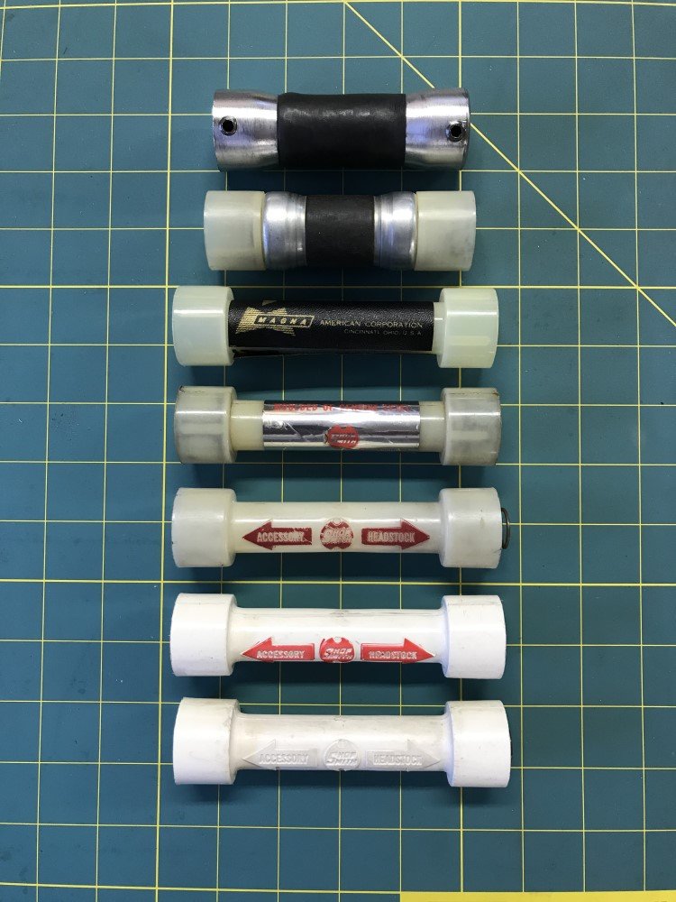

SPT Power Couplers
The Original Power Coupler attached directly to the 5/8” Drive Sleeve or Idler Shafts and the ½” shaft of the Jointer and the Jig Saw. It did not use hubs. This coupler could not be used on the Model 10E and 10ER to power the Add-A-Tools using the Power Mount Adapter kits 11-800 or 11-920. That and the introduction of additional Add-A-Tools (SPT’s) coming out required a change on the Power Coupler.
By 1955 and the introduction of the Belt Sander and Band Saw with 5/8” shafts the Coupler changed to include the use of the hubs. Hubs for the SPT’s come in two bore sizes, ½” and 5/8”. The Headstock hubs are different for the Drive Shaft and the Idler Shaft but both are a 5/8” bore. The Headstock hubs have 4 ribs and the SPT hubs have 5 ribs allowing the Power Coupler to only go on one way. The Headstock end of the Power Coupler has a spring which doesn’t allow the coupler to stay on the Headstock without pressure between it and the SPT side. This is a safety feature of the Power Coupler.
I have found 9 different Power Couplers that have been made over the years. Some are redesigned, some a change in materials and others just a labeling change.
EDIT:
New picture below shows 8 of the different Power Couplers. The second picture shows the other Power Coupler which would be either the 4th or 5th one made and 1 of the 2 made by Magna American. It has a part number that is previous to the number change in early 1964.

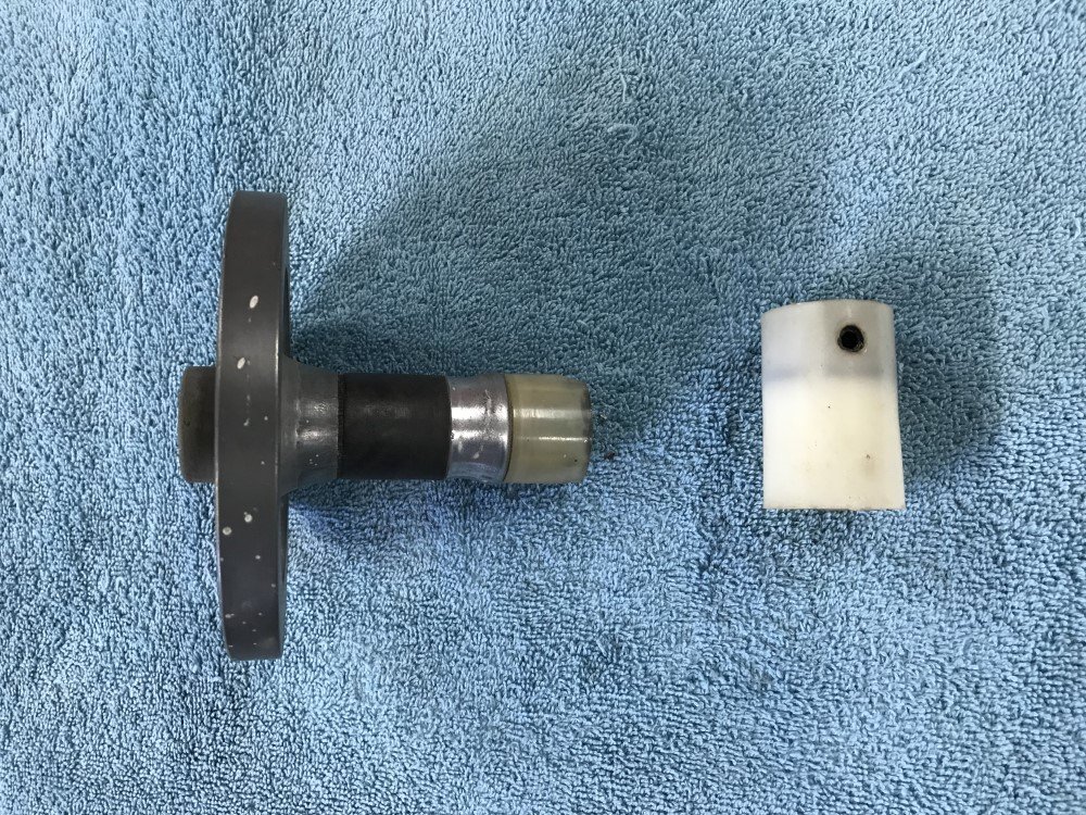

Although the later Magna Compressor aka Magna Sprayer used the same power coupler with a hub molded onto the flywheel, the early Magna Compressor had a partial coupler molded into the flywheel. The Shopsmith Air System which was made by Campbell Hausfeld had a partial coupler that was held on to the compressor shaft by a set screw but could have a hub attached to the compressor shaft instead and use a standard Power Coupler as shown in the post about the Air Compressors. The partial coupler is also used for the Speed Increaser and Speed Reducer.

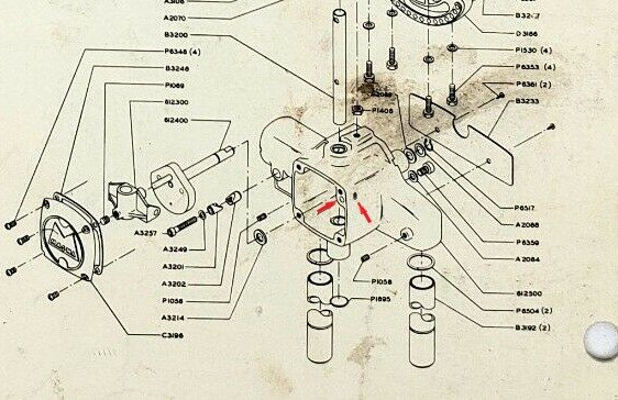

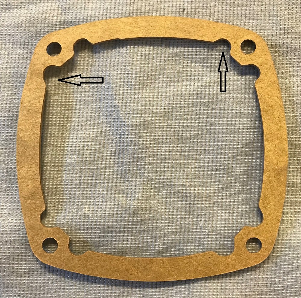

The Model 610 and later 505644 Jig Saw, the SPT for the Mark series tools, being out of production also can present problems for owners needing replacement parts. Two common items needing replacement are the Gasket for the lower housing cover and the plastic part in the Yoke Assembly. Both can be made by the user. The gasket can be made using regular gasket material and following the outline of the housing cover. Do remember it needs the hole in the gasket for the vent on the upper right side of the housing so don’t simply cut out the outside and leave the center covered with gasket material. The picture of the gasket below has arrows that show where the cutout area is all around the gasket for the vent hole.
_
Jig Saw Gasket - arrows.jpg (357.18 KiB) Viewed 90947 times
Although only one vent hole cutout is needed in the gasket the OEM gasket is cut so it can be placed in any direction on the housing and provide the vent hole cutout. The vent hole location is shown on the picture below indicated by the arrows.

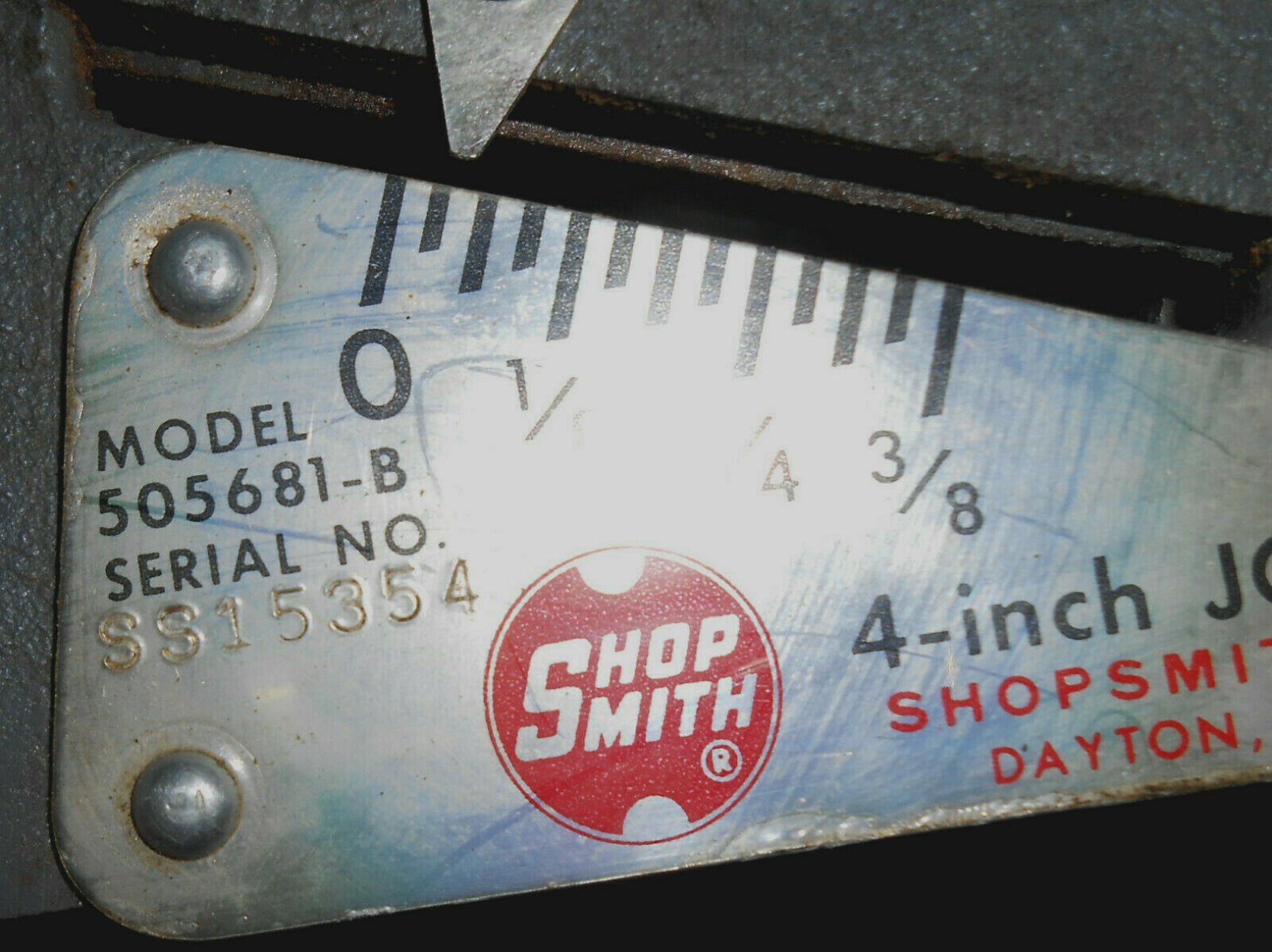

For those of you who have followed my Model 10 What When and Where thread and my Mark 5 What When and Where thread you know I have a curiosity about anomalies.
I found the following one regarding a Jointer. Model 505681-B serial number SS15354 made in Dayton OH would have been made March of 1980 as per the serial number. The Model 505681-B didn’t start until January of 1984 with serial number 70000. At the time serial number SS15354 would have been made they were Model 505681 and were being made in Tipp City OH still. The Jointer itself has the change made to Jointers adding the depth adjustment stop called the Infeed Stop that was added just above the label plate likely at the time it changed to Model 505681-B. Is there a missing digit to the serial number? Making it serial number SS105354 would make it all match up correctly and still be lower than the highest Jointer Serial Number I have seen which is SS106695. The serial numbers are the only variable on these preprinted label plates.

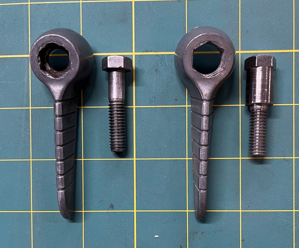

In my first post about Jointers, I listed changes made to them and approximately when they occurred. I purchased a Model 10ER recently which came with a Model 4E Joiner which is serial number 8164. I noticed, as I was disassembling it, that the Fence Lock Handle and Bolt are different from the Model 4E Jointer serial number 2145 I already have. In the picture below the Handle and Bolt from 2145 is on the left and the Handle and Bolt from 8164 is on the right. The first difference is obvious with the bolts. There is a difference in the Handle to go with the Bolts too.
_
Model 4E Fence Locks.jpg (209.39 KiB) Viewed 90271 times
Like a number of the changes made to the 4" Jointer over the years these two parts changed together and the earlier Handle cannot be used with the later Bolt although the later Handle could be used with the earlier Bolt. This change continued with the Model 620 Jointer until the Fence Lock changed as previously mentioned.
