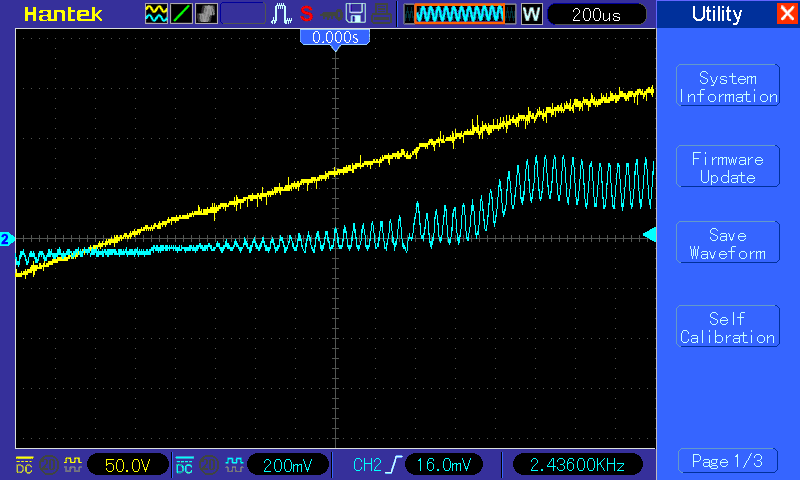

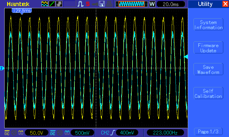

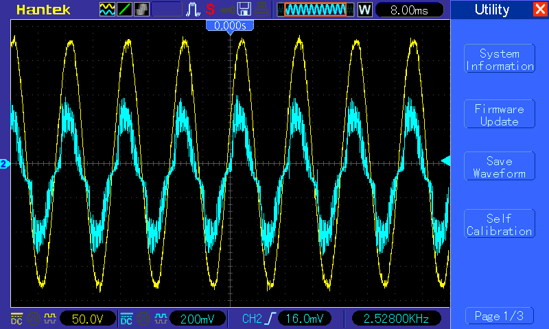

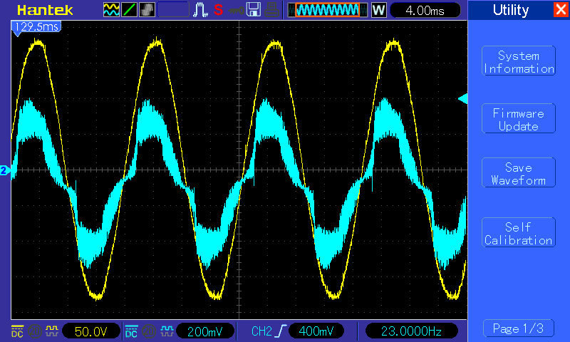

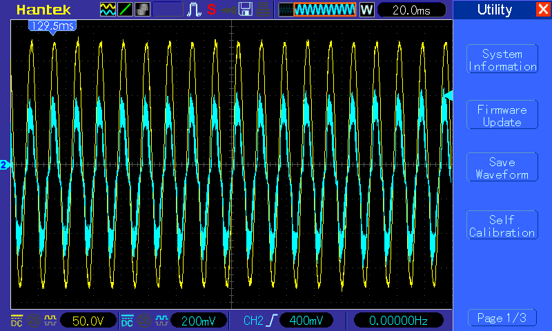

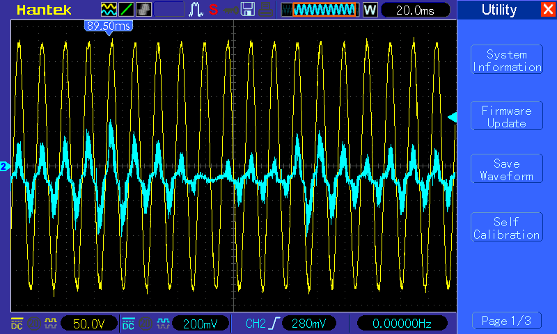

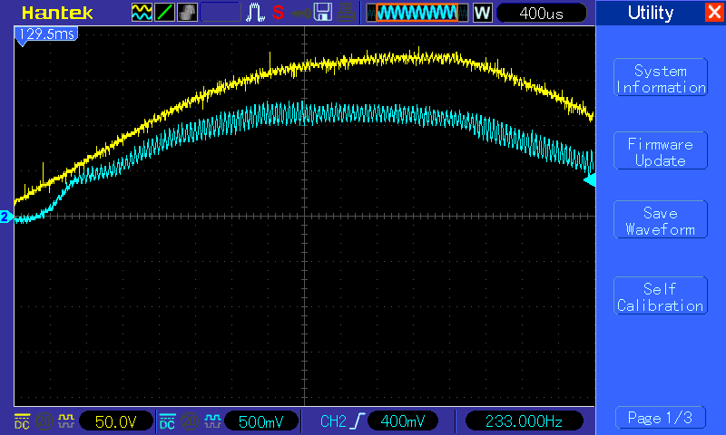

The following traces are with the motor spinning for a 3450 RPM headstock speed. The first two are steady state at 3450, the others are during startup. The current trace is much noisier at the higher current levels. For these I was using the current probe set to 1mV/10mA. On the first trace the scope measured trace 2 at 248 mV RMS (2.48 A RMS) while the DMM indicated 2.04 Amps.
I set the trigger level to catch this, it occurs fairly early in the spin-up of the motor. I'd have a hard time explaining this as anything but software.
This one is triggering near the time the motor reaches commanded speed. Setting to the trigger at a higher level, 600mV for example, results in no trigger at this speed. Note the gradual increase of Amps in each cycle.
- David

I haven't designed motor drives, so I will defer to Dennis here. However, I do have some experience with power management circuits, so from my experience what I see in the latest plots from David is what looks like about a 22.5kHz switching harmonic riding on top of the input current waveform (it isn't noise). I wonder if this 22.5kHz frequency is fixed or varies with speed or load? Keep in mind this is a switched reluctance motor, so both the voltage and current waveforms going to the presumably 3 phases (could be more) of the motor are constructed (see link below). In order to optimize the torque, a custom waveform for voltage and current is created to drive each phase of the stator. It would be interesting to see these waveforms, but may be difficult/impossible to measure them directly on a PowerPro. So, it is not just some switch turning on each phase of the motor, i.e. it is more complicated than that. It is still interesting to observe from the input waveforms to investigate, but you may not gain much insight without knowing what is going on between the motor drive (SMPS) and the motor itself.

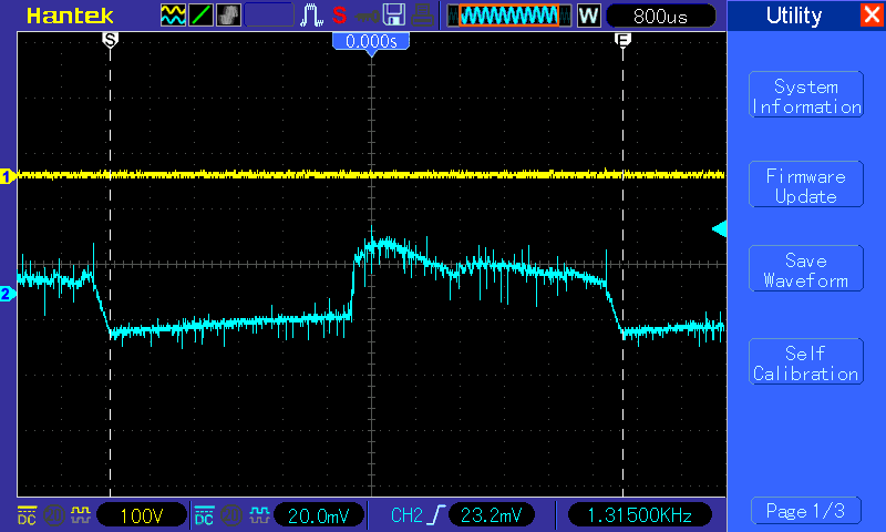

I found the power lines to the motor to be inaccessible without removing the lower belt and tilting the motor. For these measurements only the motor is spinning, without the mechanical load presented by the headstock. So for perspective I repeated the max RPM measurements, it is noteworthy that amps measured with the DMM changed from ~8A spinning the headstock to ~2.25A without the load. First trace is input voltage and current at 10K unloaded:
There are six power lines between the power supply and motor, along with several signal lines. Because of the absence of a load, I don't know how representative these are. The first sample trace:

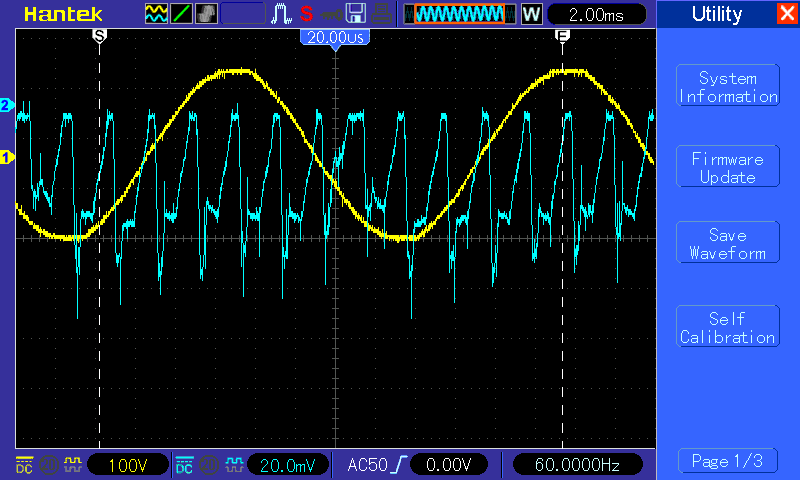

I haven't come up with an idea to present much meaning from the current traces with only one current probe. In the absence of other ideas I decided I could try to run the motor at 3600 RPM to synchronize with line voltage. I calculated a commanded RPM of 6000 at the upper spindles (not turning) would equal 3600 at the motor. There was a bit of drift that was correctable with the RPM control. At 6001 RPM commanded, the current waveform was well synchronized with line:
So if all my math to that point was correct there are eight repetitions of the current drive waveform per rotation. Note that the pulse just right of center on the scope is significantly different than the others. With the scope in normal mode, that timing relationship was constant. I found that interesting, but don't know why it would be that way. Possibly to correct speed?
