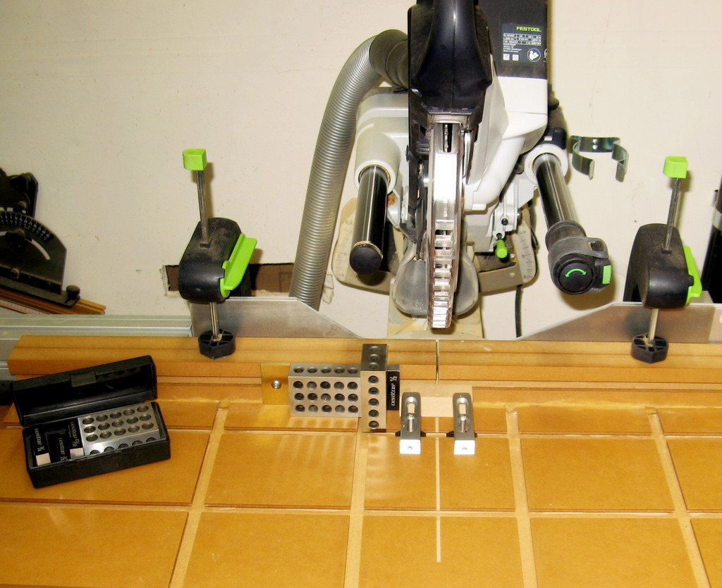

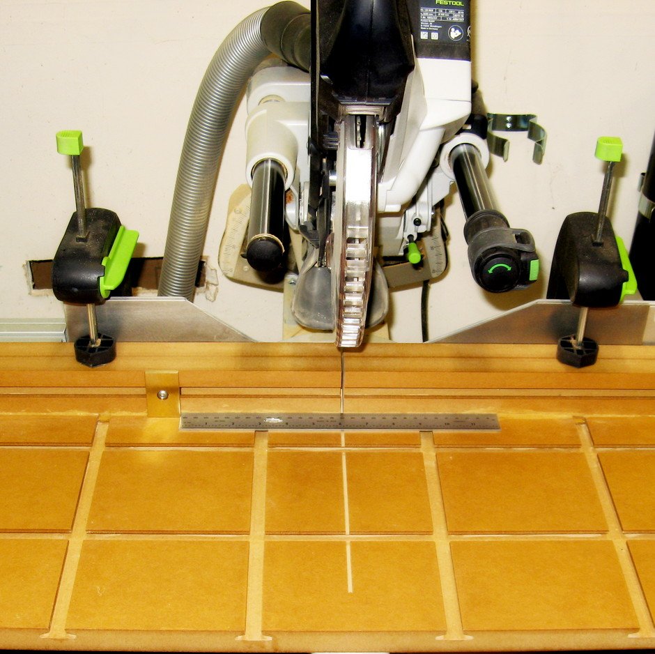

It is time to take a look at some actual clamping techniques using the clamps and stops discussed in the last installment. First is the most basic task of cutting a small work piece to length. For this I establish an accurate known point which I call the primary stop with one of my larger brass stops. I typically set it 6 inches from the blade as a good universal distance and leave it set up for a full session of cutting. Initially I set it up using a rule and the kerf in the base but then make some cuts to really dial it in using a digital caliper to measure the actual length of scrape pieces cut. The calibration for this primary stop should remain accurate until I take down and re-install the fixture board but even then it still should be within .02”.
Once the primary stop is set I use 1-2-3 blocks and the Lee Valley fractional inch setup block set to establish a secondary stop for a small work piece. With two 1-2-3 blocks I can get to any 1 inch increment from the primary stop and with the Lee Vally setup blocks it can be dialed in to within a 1/32”. I find this process to be the fastest and easiest way to get very accurate and repeatable cuts on small parts. The other option is just to set a stop at the desired cut off distance from the blade using the rule and be done with it. If you are young and have good eyesight this might be the preferred method but at my age I have more confidence in the setup block technique. The picture shows a small work piece being held with two Gator Tooth clamps to make a 1.5” cut. Two clamps are used to ensure the cutoff does not go flying off to parts unknown in the workshop. A precaution I take if the cutoff is to be used but I also have had pretty good luck with just using proper miter saw techniques. I usually start by putting the blade down well in front of the work piece and then steadily push the spinning blade into the work piece until the miter saw stop is contacted. Then I stop the saw but do not lift it up from the cutting position until the blade completely stops. If you do not have a sliding miter saw the same technique can be used for a vertical chop motion. The key is to not let the blade up until it stops spinning. This prevents the small cutoff from flying off over 90% of the time for me. When I measured the length of the resulting work piece with a digital caliper it was within .002” of the desired 1.5”. I can typically count on accuracies of +/- .003” using this setup block technique.

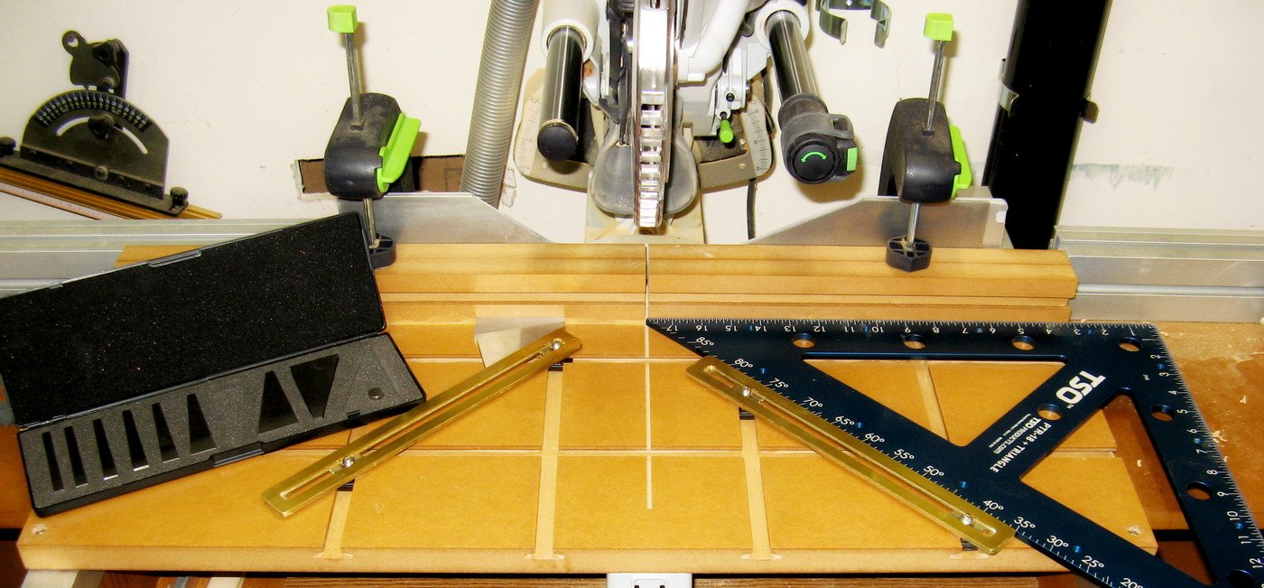

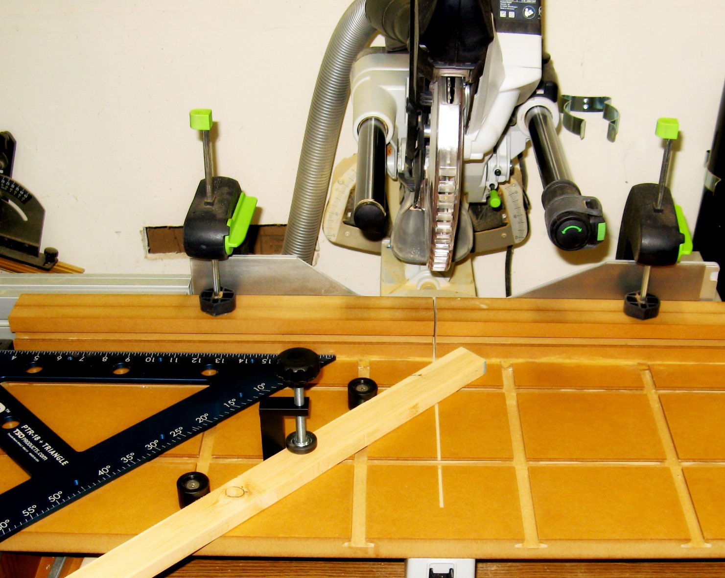

There are a couple of ways to do angle cuts depending on the size of the work pieces. For 45 degree cuts it often is good to establish a secondary fence set with a speed square against the primary fence or in my case I use my TSO triangle. I use my long brass slotted stops as secondary fences to position work pieces and make 45 degree cuts with confidence. If other angles are required I again use a setup block technique. This set of machinists angle blocks works very well and allows angles to be set in 1 degree increments.
https://www.amazon.com/gp/product/B00HZ ... UTF8&psc=1
If you have less need for an endless range of angles you might give these blocks a look. They have the most commonly used angles.
https://www.amazon.com/QWORK-Triangle-P ... 35&sr=8-19
Another option would be to just cut your own setup blocks at the angles you need out of ¼” hardboard which still gives pretty accurate results, can be easier to use and is much more cost effective.

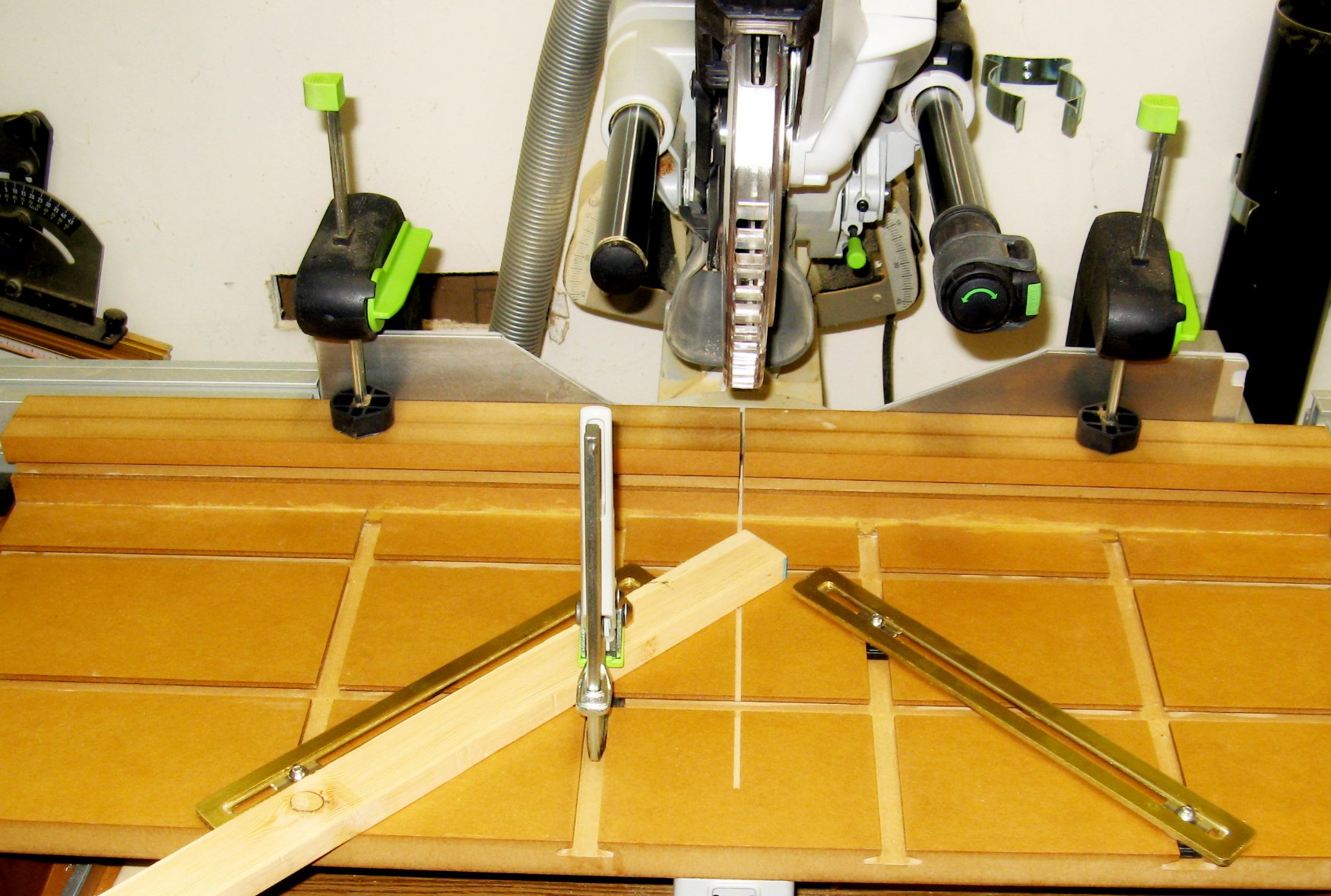

I have found that establishing two opposing secondary fences have advantages for some tasks such as creating perfectly fitting miter joints or making trapezoidal cuts for a segmented disk.
The floating dogs can also be used to establish a secondary fence as shown below.

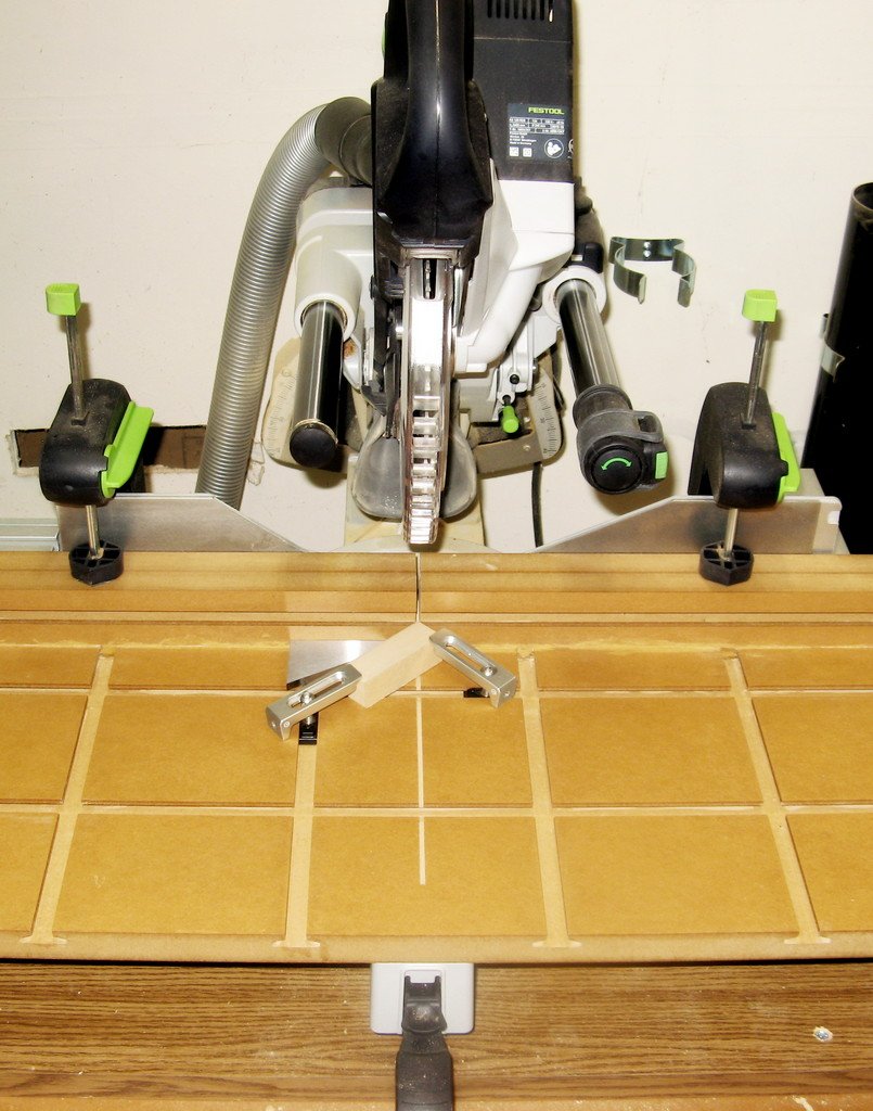

Sometimes work pieces are so small that the secondary fence technique is too cumbersome. That is when I use the setup blocks directly with the work piece and the primary fence as shown below. I feel I have not done justice to the Gator Tooth clamps used here by just showing one of the many ways they can clamp a work piece. They are probably the most versatile clamps I own. Please check out the video. https://www.youtube.com/watch?v=4QjYt_R-bjE

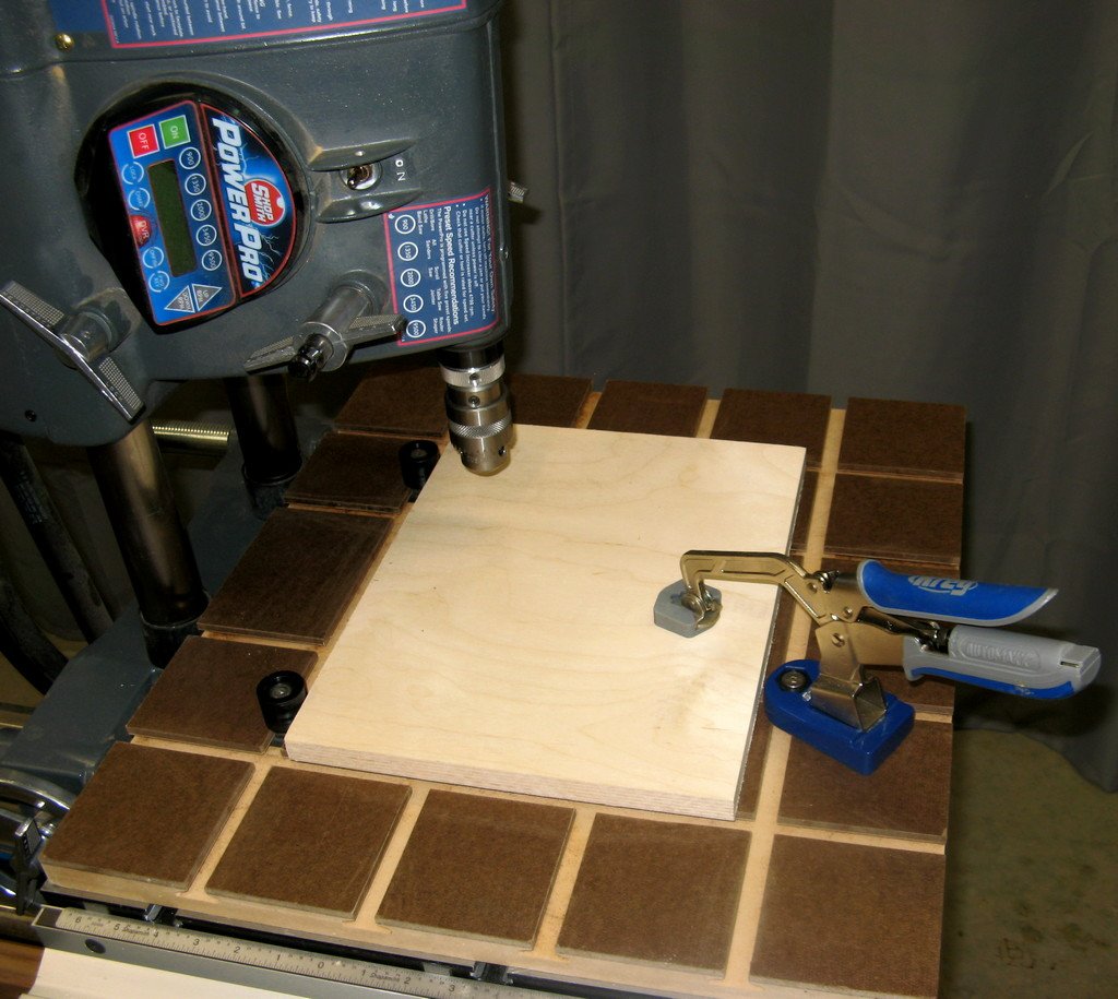

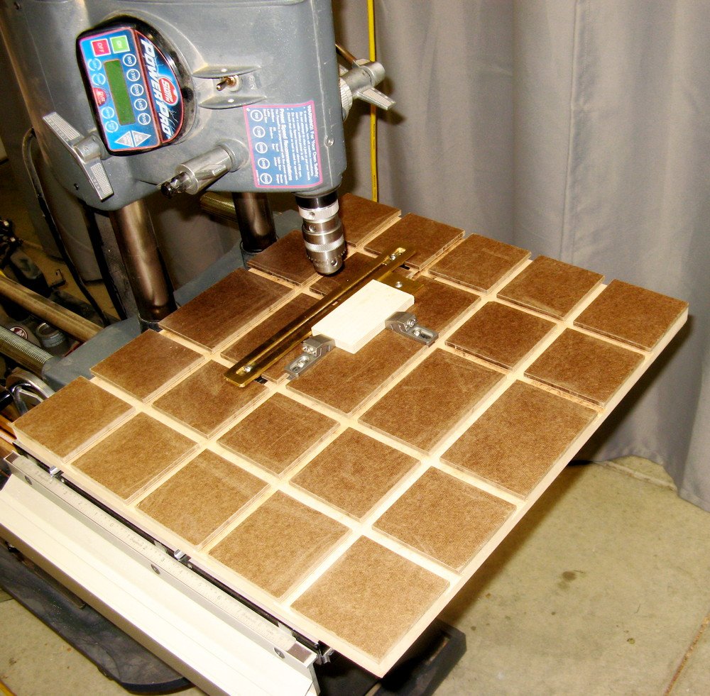

Just to finish this up I want to talk about a fixture board for the drill press and in particular the Shopsmith drill press. One of the first things I built using the ToolQuest array of products was a fixture board for my drill press. I used the technique mentioned earlier of laminating common ¾” MDF with ¼” tempered hardboard. However, since I had limited experience working with WoodAnchor slots, I choose to put the hardboard on top and cut the slots through it. I have been using the fixture board for over a year now and have not noticed any stability issues but still to get the most benefit of the hard board it should be on the bottom uncut. I used my table router and fence to make the slot cuts in a single pass. The fixture board can be used with the same clamps and stops discussed earlier. The picture below shows an example of using the long slotted brass stop to establish a fence with two Tiger Claw clamps and another brass stop. A little bit of work holding overkill but it gives you an idea of how all these can be used for small pieces.
Of course this fixture board can also be used with any size parts as shown below using the floating dogs and the Kreg Automaxx clamp.
