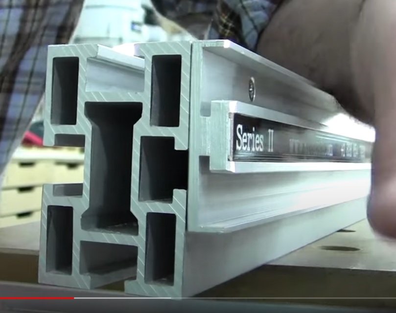

Steve - Very nice. Could you provide a cross-section picture of the extrusion with something in it for scale without disturbing your setup? Are these 'standard' T-slots?

DLB wrote: Tue Aug 03, 2021 11:04 am Steve - Very nice. Could you provide a cross-section picture of the extrusion with something in it for scale without disturbing your setup? Are these 'standard' T-slots?
- David
They are larger than standard T-slots. Look at the first YouTube video in the post at the 7 or 8 minute mark. They show some close up views of the rail and the size of the T-nuts on the stop assembly. The rails feels much heavier than the standard 80-20 extrusions I have work with in the past. Let me know if you would still like me to take some pictures.

sehast wrote: Tue Aug 03, 2021 3:46 pm
- David
Yeah, if you look at the 1st video that Steve posted you can see the end cross section of the extrusion at about the 8:05 mark in it. What is more telling is to look at the fence stop which hints that those T-tracks are massive. Definitely looks bigger than standard 80 20 stock extrusions. Below is a mechanical drawing with some dimensions.
