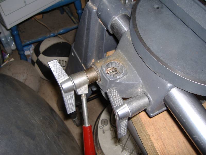

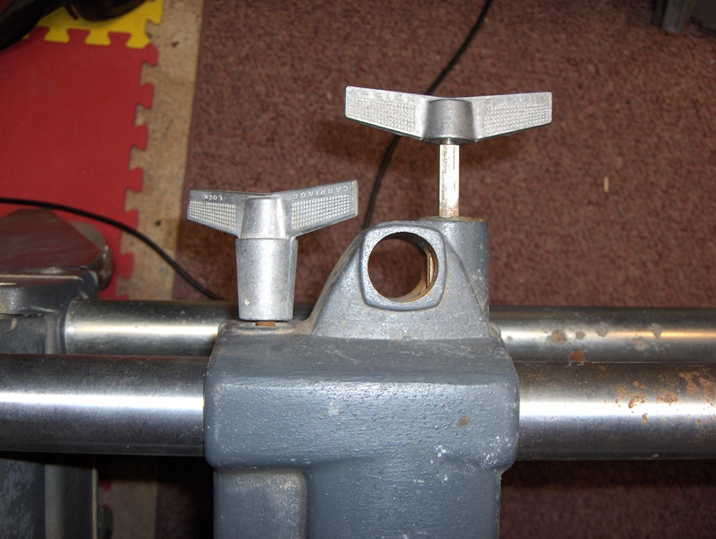

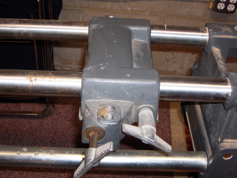

[ATTACH]97[/ATTACH]
[ATTACH]98[/ATTACH]
[ATTACH]99[/ATTACH]
[ATTACH]100[/ATTACH]
[ATTACH]101[/ATTACH]
I think that i have been able to re size them and attach them
rear 2.JPG (208.98 KiB) Viewed 19041 times
under 1.JPG (212.32 KiB) Viewed 19039 times
So besides needing a little tlc you are missing parts.... the shaft should have the pinion lock (ref #166) 504260, the pinion knob (ref #168) 5052619, the table height handle (ref #167) 513058 and the flat washer (ref #169) 120388.
Without these parts the table will not lock.
A quick guess is you are missing about $20 worth of parts or maybe they are in some box somewhere???
Were you able to look at the exploded parts list for this model 500 carriage assembly? If not you need to...... if you want me to I can take some pictures of what this should look like and what the parts are that you are missing but I will not be able to do that for about 20 hours........
Bruce
