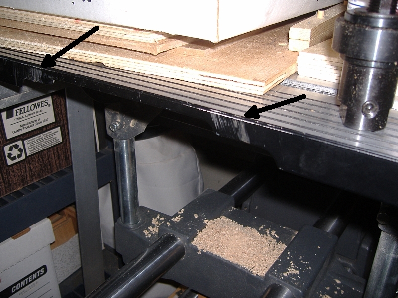

Hi,
Just in case you want to see what happens if the sandpaper at the seam lifts and folds back like what happen to me.
It also took a while to get the piece of cedar cleaned up for the wagon seat bench I was building.
[ATTACH]2564[/ATTACH]

I have just one of the conical discs and keep 80-grit on it. I had no trouble getting the paper off and stored it on the orginal backer paper. When I put it back on there was no indication that a problem was happening... sort of like the O-ring on the shuttle... but sure enough several pieces into my sanding operation a loud pop sort of sound and then a grinding sound of my main table. I had the machine off in very fast order and found the seam must have caught somehow. The paper folded on itself so the grit side and edge were tucked against the steel and the bulge this caused was sanding the table. It did it with a lot of force and the seam was tightly made with maybe an inch of the edge folded under near the top. This sort of thing had never happened when I replaced the sanding discs with new. I never wanted this to happen again and I have since just replaced with new sanding discs and for that reason only use 80 grit. Someday I want to buy a second one to keep 150-grit on.
