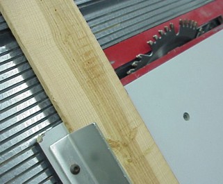

Turns out my fear was ill founded about leverage of the extension table preventing the table from staying at true 45 degree. The SS table has hard stops at that angle, so it can't physically move once those are aligned precisely. So that concern disappeared.
My objective was to cut multiple boards to the same precise lengths with 45 degree bevels one each end. I needed a way to put a stop block in place. Here'e some pix showing how I'm now performing this cut. The current solution was to use the sliding table and clamping a stop block in place.
Here's some pix of that setup.

And this is seems to work well for the length of the boards I'm working with. However, on short boards this setup doesn't work so well. The blade wants to push the board out of square with the fence. I think I'm going to build a sliding crosscut sled that I'll use just for these beveled cuts.
I saw a crosscut sled design that has replaceable inserts at the blade; one insert for zero clearance on a normal 1/8" kerf blade, others for various size dado configurations. I'll just add one for beveled setups.
