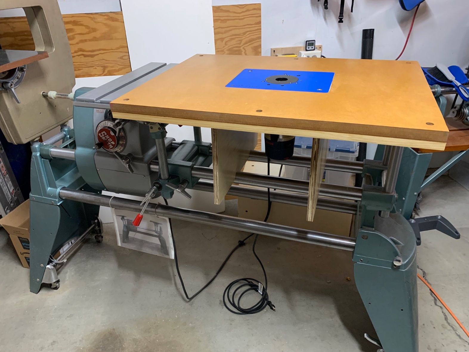

Well, I’ve gotten some great guidance from you all, as usual. I also was doing some research on how others have finished their tables. I ended up doing something similar to what edma194 and someone on the Fine Woodworking magazine forums suggested. I wiped two light coats of Old Masters Tung Oil Varnish, used 0000 steel wool to buff it out, then two more coats of the Tung Oil Varnish. I got a bit distract when a couple neighbors showed up at my open garage door, so wasn’t careful on the last coat and wiped it on a bit too thick. That took longer to dry, and ended up gripping like it was a rubber table too. I let that set for two days, and then buffed it down with 0000 steel wool again. It feels nice and hard, and very smooth. I did three coats of Johnson’s Paste Wax, and now the top is slick! I did consider laminate, but it had three things going against it at this time: I was going to have to spend more money to get it, I was going to have to learn something new (and I just wanted to get it done), and it was going to add even more time to this project (with all the running around to get it, learn how to install it, and then install it). I may add laminate in the future.

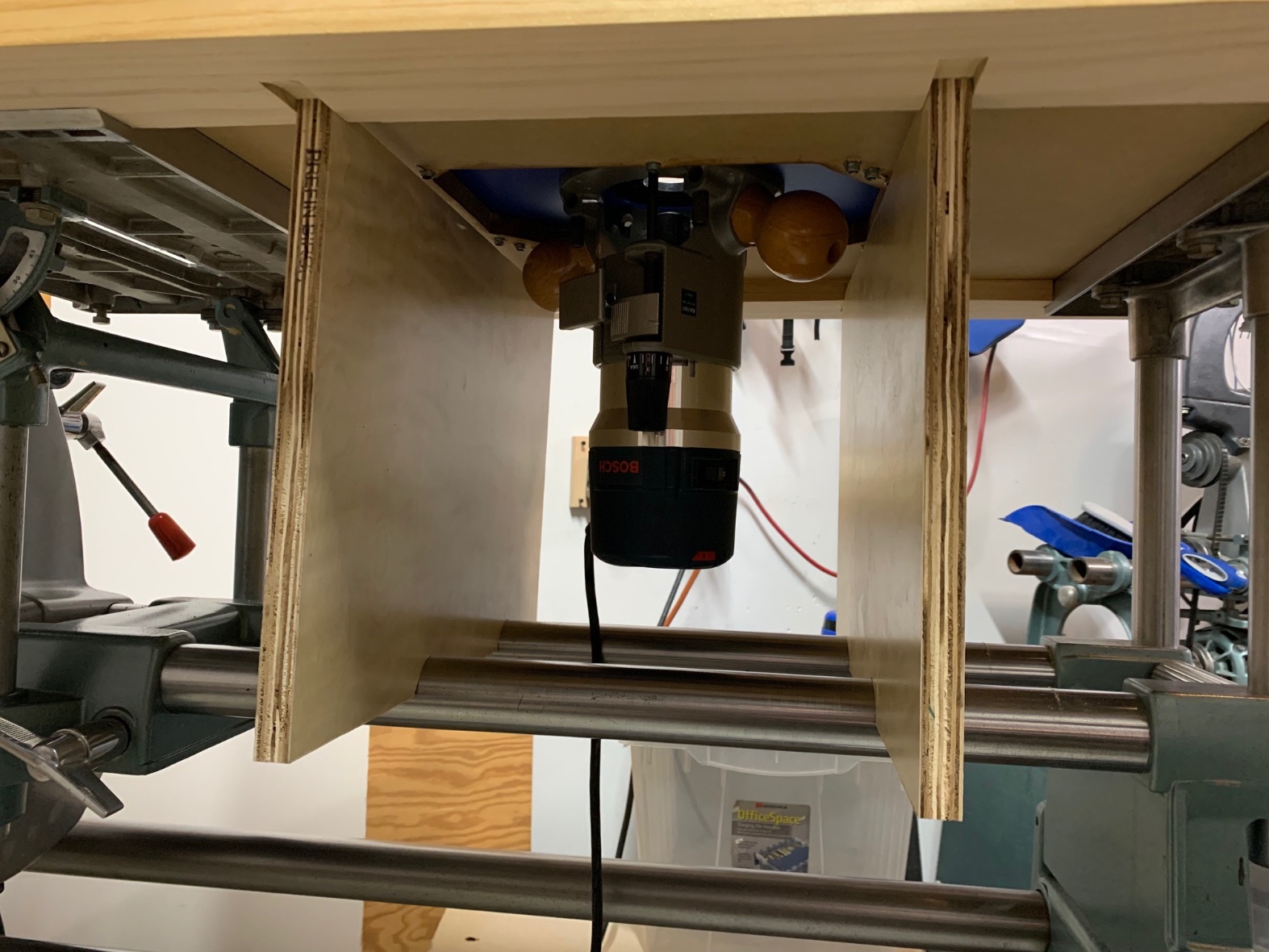

Although it’s not in its final stage of completion, I think this table ready for me to use on my immediate project. Just need to finish leveling the inserts a little, but it’s ready. I only really need it to shape the edges of some smallish Baltic birch plywood pieces for my latest project (the cat scratching post), then I can finish two other projects that are in progress. After those are completed I can return to finish this table. I think I’m going to do as Hobbyman2 suggested and use T track for the fence and a miter slot. I already have some plans to build a fence, and it will use the T track. And yes, RFGuy, as you can see below, I did keep the height of the router in mind, but thanks for that reminder. I think there’s also enough room to add a board under the router, in the future, to enclose it for dust collection.
Below are some shots of the table in its ready to use state. It’s not fully complete, but I can use it to get some work done. The photos show how I used the front and back 3/4”x4” cross supports to grip the tables to keep the router table from moving in the x-y axes. Once I sit the router table in place, I can push the main table tight against it and then lock it down.
Thanks to everyone for their comments, suggestions, and kind words about how it looks. It’s not as good as what I’ve seen some of you experienced woodworkers do, but I’m just a beginner and learning a lot from you all with every project.

I have the same or similar router. One suggestion - Pick up a longer T-handle hex key, like a SS Tool Box except size, for adjusting depth of cut from the top. The one Bosch provides is short and likely to interfere with the fence. I want to say it is 3mm, but check before ordering. A poor man's router lift. (I still have to reach under to lock/unlock, something to keep in mind if you enclose it for dust collection.)
