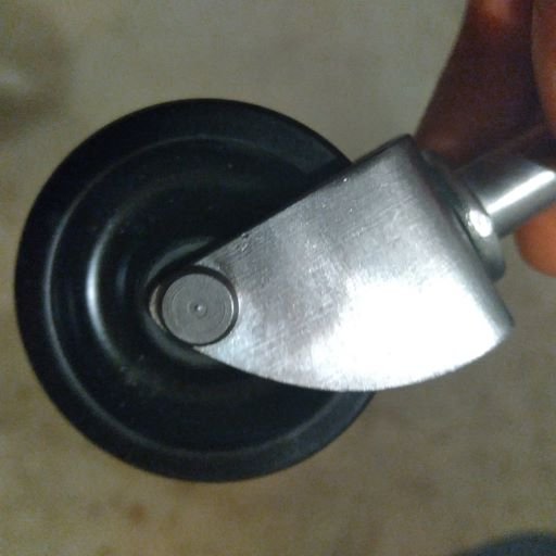

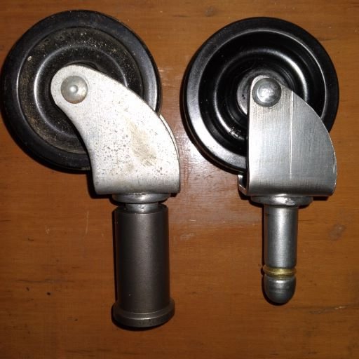

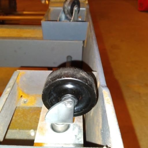

I wasn't really looking for a project or to "reinvent the wheel" (pun intended), but that's what I got. I just wanted to complete the Mark VII with the correct equipment. Somehow the caster assembly I purchased have the wrong wheels. For now I am using the foot lever, rod and cams with my homemade design for the wheel mounting, here: viewtopic.php?f=10&t=25392&p=283521#p283521 which works somewhat, but not as well as it did with my wood lever and blocking device which held the wheel much more rigid. I can always go back to that if I have to. I think if I can re-drill the axle location and move the wheel over closer to the stem centerline some they could work, but that isn't my first choice. I will send some emails and see what they say.

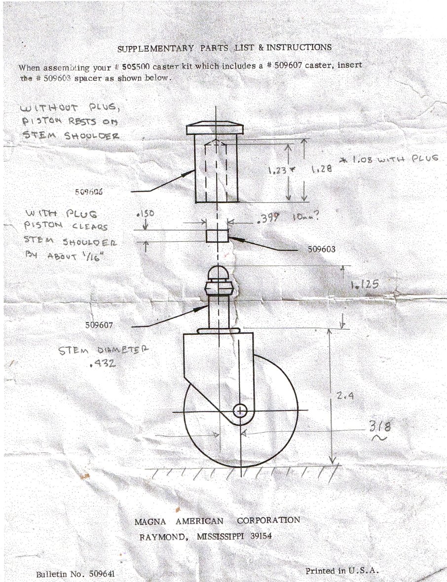

The 3/8" swivel radius is de 'problem'.
M VII caster dimensions.jpg (377.15 KiB) Viewed 6802 times
The 'spacer'/'plug' (509603) appears to be a 10mm hole punch "swarf".

JPG wrote: Mon Nov 01, 2021 10:22 am The 3/8" swivel radius is de 'problem'.
Well, I figured I didn't really have anything to lose as I can't use the wheels as they are so I cut one down, re-drilled and relocated the wheel. I think it looks pretty close to the picture you posted. I haven't tried mounting it yet, hopefully it will work.
Mike -
[Edit] It's going to work. I mounted it, appears to be plenty of clearance now. I just need to turn some new axle pins.
Thanks for the pictures and dimensions JPG, and I appreciate the replies and links from RF Guy as well.
Mike -

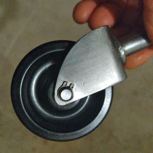

Hi RF Guy, excellent option/suggestion. They are the same wheels that came with the kit I bought off ebay. They just had the wrong part that holds the wheel, but the critical dimension from top of shoulder to bottom of wheel was correct at 2.4 inches, so I just cut off part of it and re-drilled new axle holes closer to the stem centerline. I had to grind off one side of the axle to remove the wheel. I will just make new axles on the metal lathe and either peen the end, or cut a groove for an E clip.

Axle
Finished Caster
Decided to use a snap ring, the E clips were too big.
