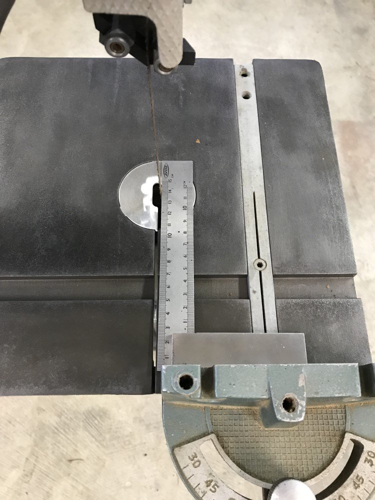

Buz,
If I understand you correctly you are trying to check table to blade alignment using the miter and a square as shown int the pictures below and the manual page you posted.
_
Alignment 1.jpg (143.52 KiB) Viewed 1223 times
Then moving the miter forward.
_
Alignment 2.jpg (129.9 KiB) Viewed 1223 times
This is the same as shown in the manual. The Miter needs to be square or the results will be off. The table would be adjusted by loosening the 4 bolts, re-adjusting and tightening the 4 bolts. If you are repeating the same result I would suspect the Miter is not at 90° and needs correcting or for some reason the table returns to the slightly off position as the bolts are tightened. Keep in mind the instructions in the manual page you posted is for the aluminum table and not the cast iron table I have shown above. With the aluminum table there is some adjustment room for the "T" track itself as noted in #4.
Re: bandsaw blade square through full motion of miter tool
As I now understand it, blade twist will not affect this. The blade is being used as a POINT reference.
The adjustment that needs to take place is rotating the table about a vertical axis(looking down as a bird would).
That rotating force may be applied at either end(front/back) where there is slop in the trunion bolt holes.
After rotating return to the positioning the square 'tip' and repeat checking at the square 'heel'.
After correct alignment is achieved carefully(a small amount at a time on each bolt) tighten the trunion bolts.
Recheck. This may be a tail chasing the dog event. Key is the table not shifting while tightening the bolts.
Post by 80spiders »
I appreciate the input from all. Since I am not mechanical in my process of thinking, I need "coaching" to get me on the correct path. I loosened those 4 bolts mounting the table to the trunnions, twisted the table and re-tightened at least 4 times yesterday without any change in the measurement when I ran the square in the miter gauge along the side of the blade via the miter track. I become frustrated with the idea that shims were needed but I could not visualize how that would help anything relative to my issue.
I will revisit the miter gauge and the square tonight to see if that is where the problem(s) is.
It may help to leave the bolts snug but neither loose nor tight. Then nudge the table by gentle tapping in the direction needed. Gradually sneak up on tightening sequentially around the 4 bolts.
Check the table/trunion mating surfaces for flatness.(also the bolt head to trunion)

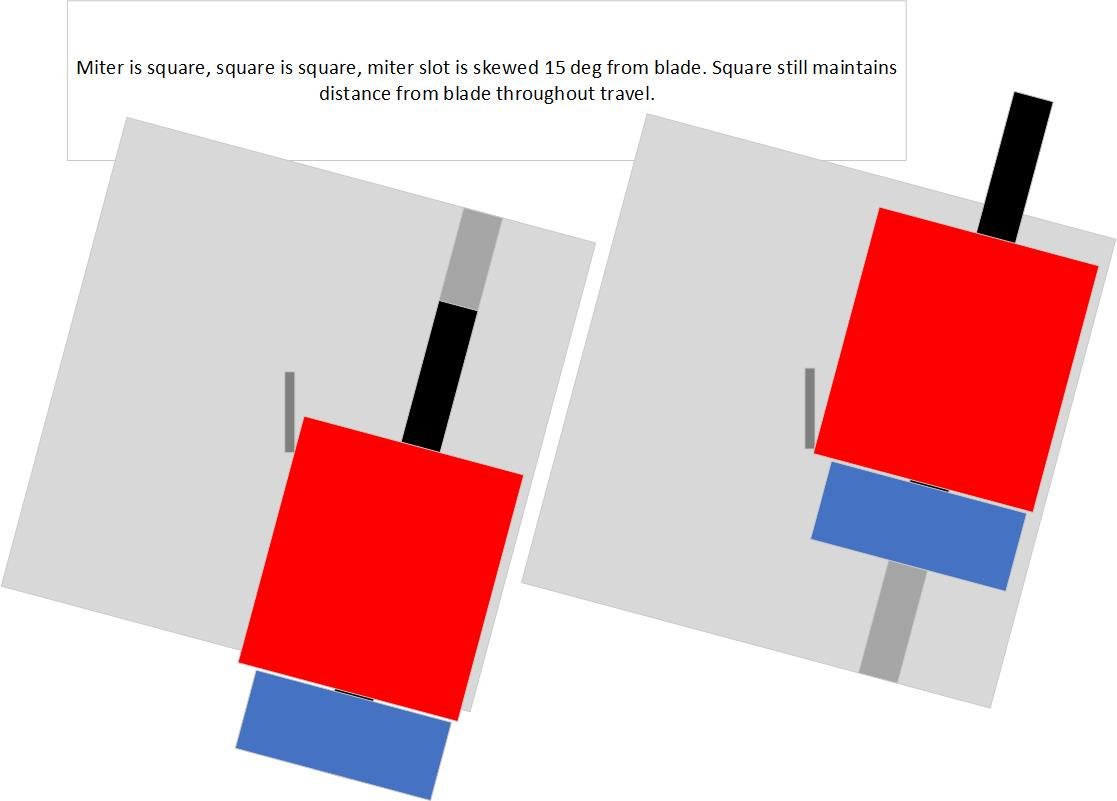

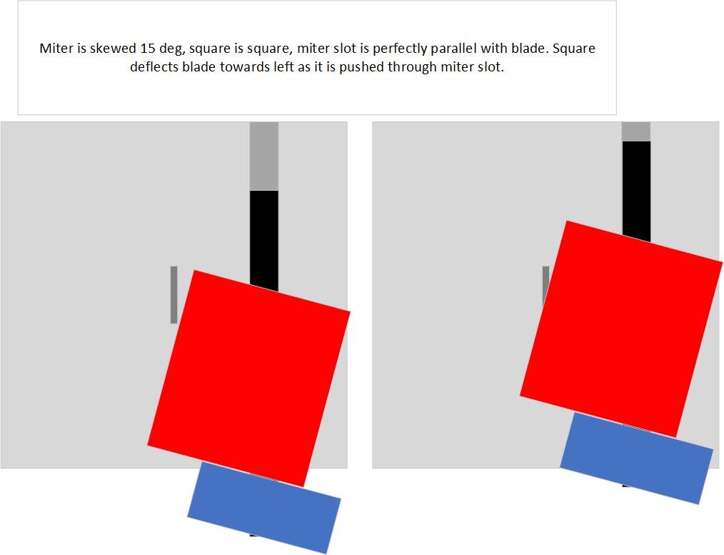

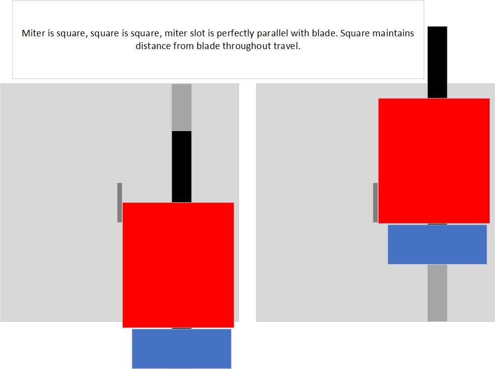

Pardon my lack of fine drawing skills, but hopefully they represent well enough what I believe to be an accurate set of statements. The table is light gray, the miter slot medium gray, the blade the darkest gray, the miter bar black, the miter "head" blue, and the square red.
The above drawing represents when all is perfectly square and parallel. With the square just touching the blade, the distance/touching force between the two will remain exactly the same throughout the travel of the miter gauge.
(Edited to replace Drawing2 with Drawing2a, showing a rotated table rather than rotated blade orientation)
If, however, the table is rotated and the miter is no longer is parallel with the blade, the distance/touching force between the two still remains exactly the same throughout the travel of the miter gauge.
This is what the instructions seem to be telling you what and how to measure for. IMHO, the instructions are wrong.
This is what I think is happening, that your miter head is at a tiny bit of an angle and that as you push the miter gauge/square through the back end of the square, due to the back end of the square being in the direct path of the blade rather than beside it. If you got a gap at the back end the angle would be off the opposite direction.
If anybody else can find fault in my logic, please chime in.
The second pix is somewhat counter intuitive though the end result is correct. It would be more understandable if the miter slot/miter gauge and square were rotated 15° and the blade remained as oriented in the first pix. Rotating the entire pix(s) 15° accomplishes the same.
The procedure is the same as main table alignment(uses slop in mounting holes to achieve parallelness). A differing detail is that travel along the square of a point on the blade is used rather than a point off the end of the miter gauge at front and back of the blade.
I think the procedure is valid, but not easy to accomplish.

JPG wrote: Mon Nov 01, 2021 8:31 pm The second pix is somewhat counter intuitive though the end result is correct. It would be more understandable if the miter slot/miter gauge and square were rotated 15° and the blade remained as oriented in the first pix. Rotating the entire pix(s) 15° accomplishes the same.
Good idea, I replace the second drawing with one where the table is rotated rather than the blade.
