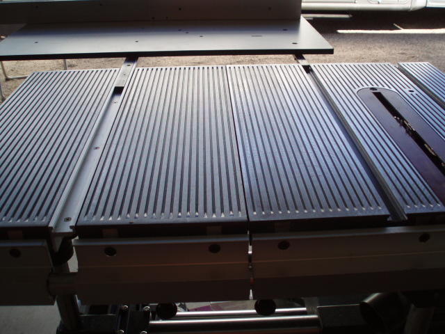

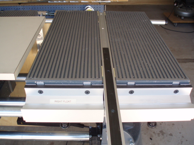

Just think how nice it would be to have a t-track in or on that extension table.
Notice the dual miter bars on the Shopsmith Sliding Crosscut Table.
Installation Dry Fit 2.JPG (152.34 KiB) Viewed 3166 times
Crosscut Capacity Expanded.JPG (164 KiB) Viewed 3166 times

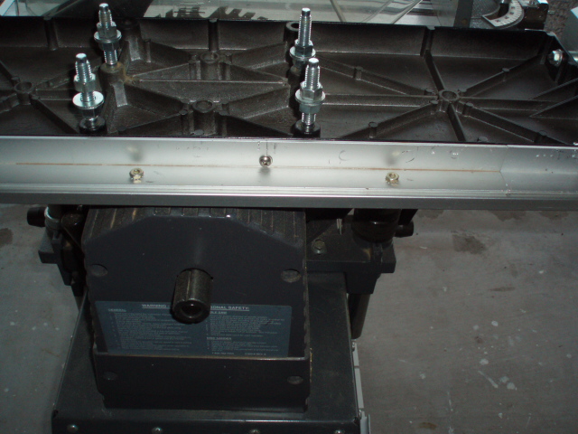

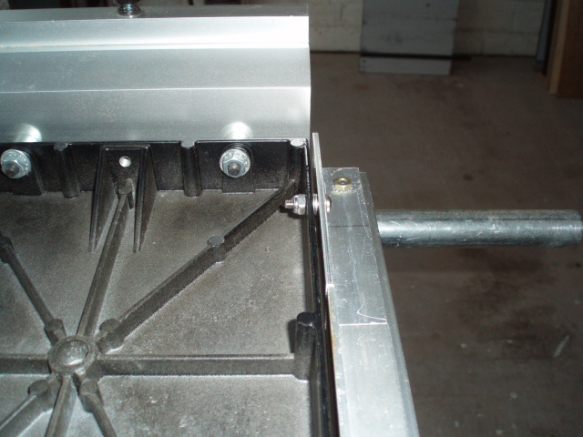

it looks like you cantilevered a T-track that was mounted somehow between an extension table and a floating table. I don't see how you mounted it or how you stabilized the extended track so that it doesn't twist or buckle.
please share more. you definitely have my attention.
Ivan

iclark wrote:my wife is getting really tired of hearing me say "how did he do that?":D
Ivan
I have a couple pics that may answer your question. If not, re-post your question and I'll try again.
Basically, I mounted the t-track to a piece of aluminum angle and the mounted the aluminum angle to the side of an extension table. The aluminum angle and the table were drilled to match. The two are secured together using bolts and nuts.

dusty wrote:I have a couple pics that may answer your question. If not, re-post your question and I'll try again.
thank you. so obvious once you show me. very nice.

Could the feather board idea
Post by dlbristol »
in the second set of photos Be a solution to some of the issues about kick back and the molder head that we had in the last chapter of PTWFE? I sometimes see these things , think they are a good idea and later find out maybe it isn't a good idea. With a feather board on the fence and one of these, it seems to be pretty well clamped down. The third set of photos would seem to allow wider stock and more molder cuts toward the center of the stock. Am I missing anything that might get me in trouble?
