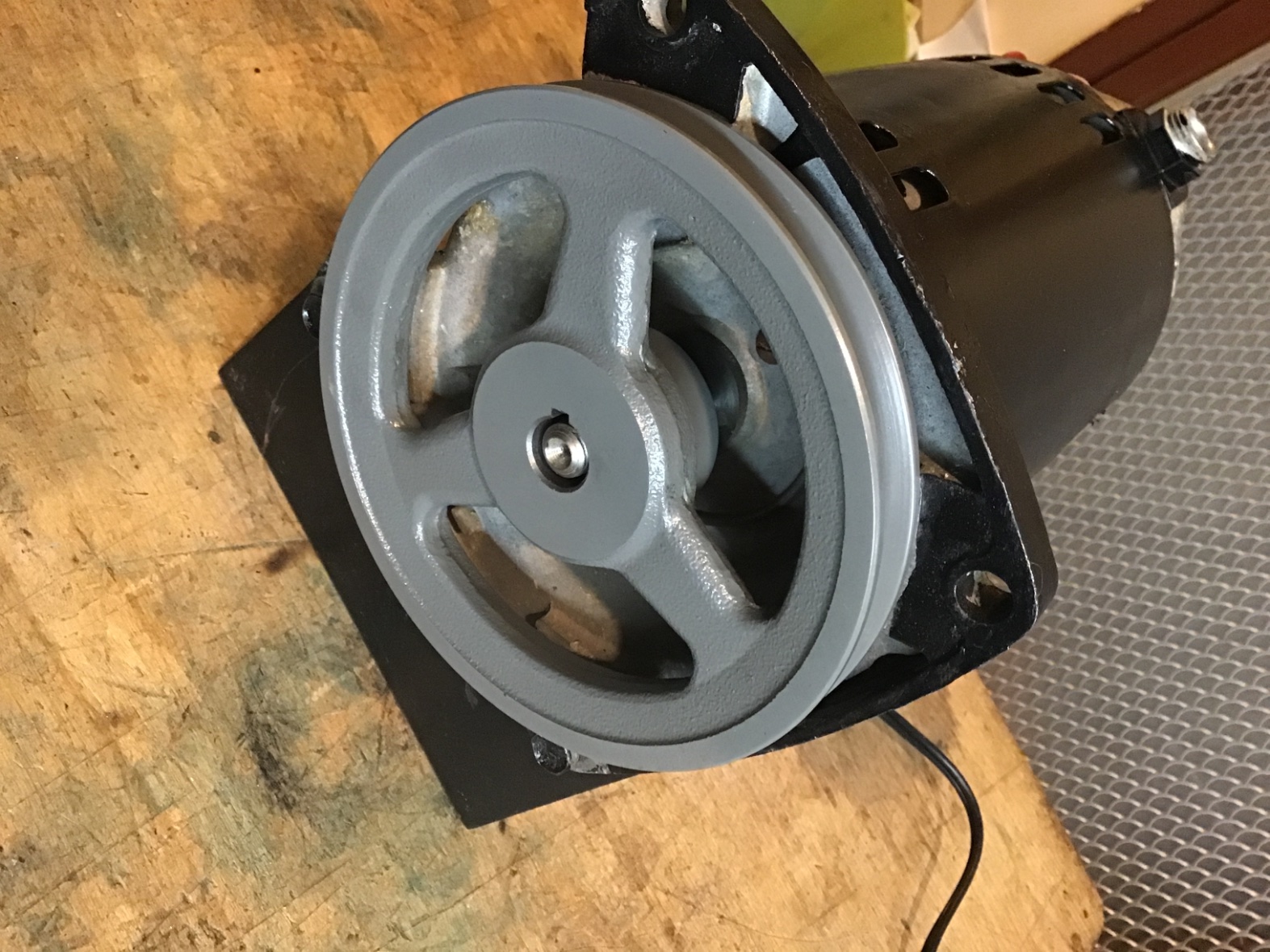

Another follow up. I ordered a new pulley from Amazon. It arrived and I am impressed. It was OBVIOUSLY balanced at the factory and the flange for the set screw has the same profile all the way around the shaft. I'll attach photos. But the best part is i mounted it to the motor and fired it up on my bench. And there is no vibration. Hurrah!
I'll post again after it's all back together.
- Signs of balancing.
- image.jpg (516.29 KiB) Viewed 6004 times
- New pulley
- image.jpg (539.24 KiB) Viewed 6004 times
