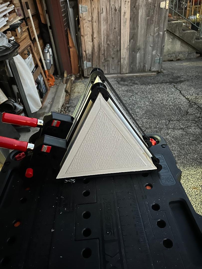

Finally got around to a test fit using masking tape and the flat layout method. It seem to work well and I'm happy with the results. Now to try the glue up one of these days.

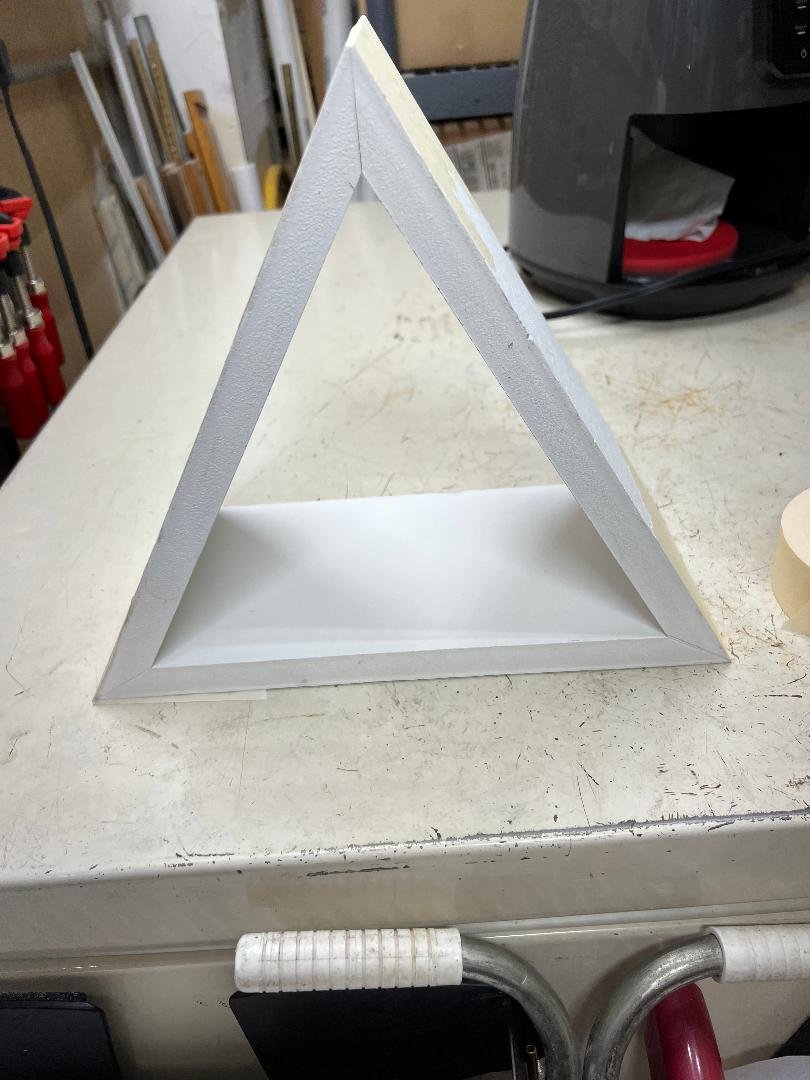

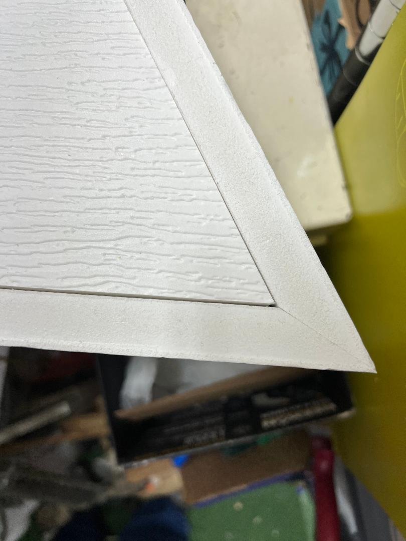

Speaking of that I glued it up today and it is in clamps for now. More then likely done but so am I, so clamps come off tomorrow. For the front and back I need to glue to pieces together to get the height. I traced the inside on the glued up parts and then cut them with the track saw. In the picture you can see the front top to the right. Back is inside and was cut just a little short on the bottom to allow rain to leak out.
So all that is left is the hole and then I think 6 screws, more then likely the blue kreg ones since I have been using them for such projects.
Re: Dec 2nd in IL, nice day for projects
Got er done before the new year!

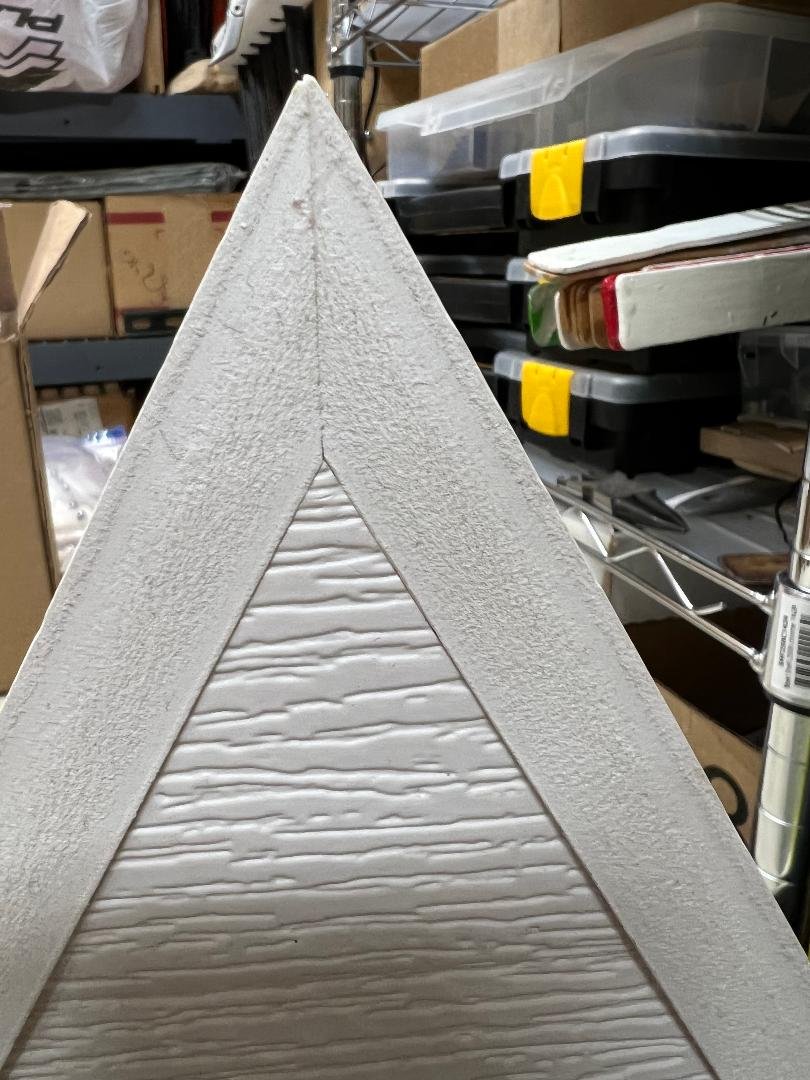

First a shot of how the joints look. I did not go to the very edge of the material to line up the cut as I did not want a razor edge cut for a bird house, so I'm pretty happy with how that worked out.

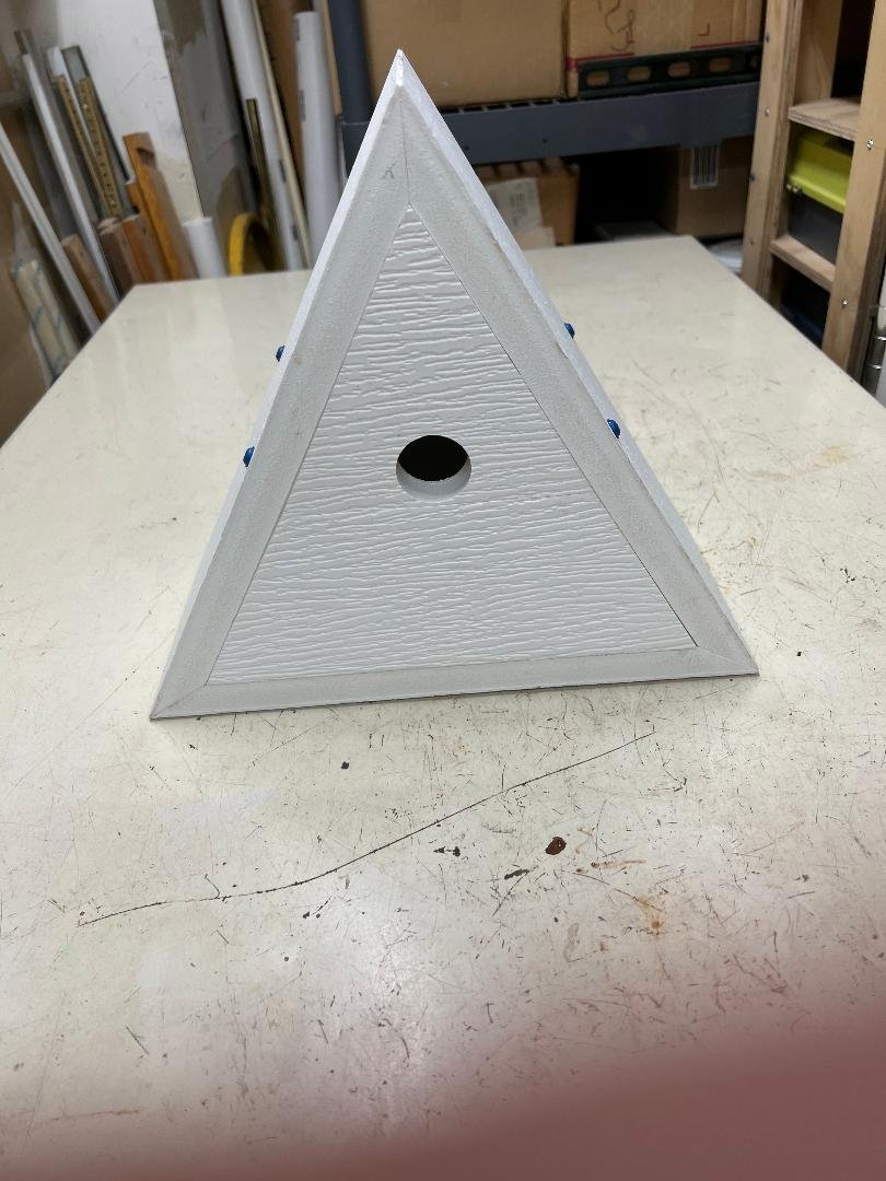

On the back I cut the piece just short to provide for drainage. I'm not sure if this will be enough but after a year of use I can redo it slightly when I empty it out.

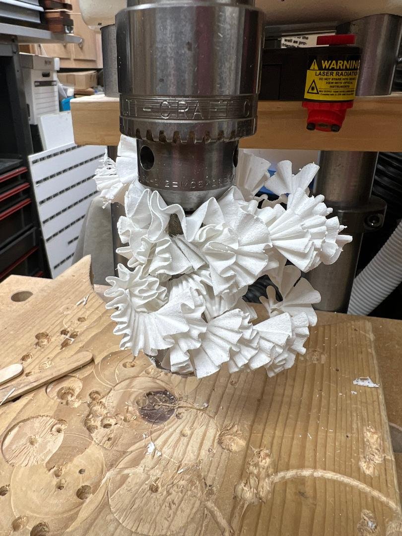

Next is the material from the hole. Wish I could make something out of it as it looks so cool, but I bet it is brittle.
And done until spring when I will find a spot for it outside.
This was a 12" point to point version and if I have enough material left I might do an 8" version later. Might make a table saw jig to do that.

Those miters came out great, Ed. Was your 30-degree jig plus Kapex setup dead on on the first try, or did you have to make some test cuts and adjustments?
No actual test cuts but I did go longer then I first planned in case I had to do some adjustments and then have to cut again. The big problem I have with the jig is how to get a decent clamping situation.
I have plans for a table saw version that I might build as it would be a lot easier to clamp the work piece in place. I did the plans sometime ago but never got around to actually making it. It would be great for the flag case and other long angles.
