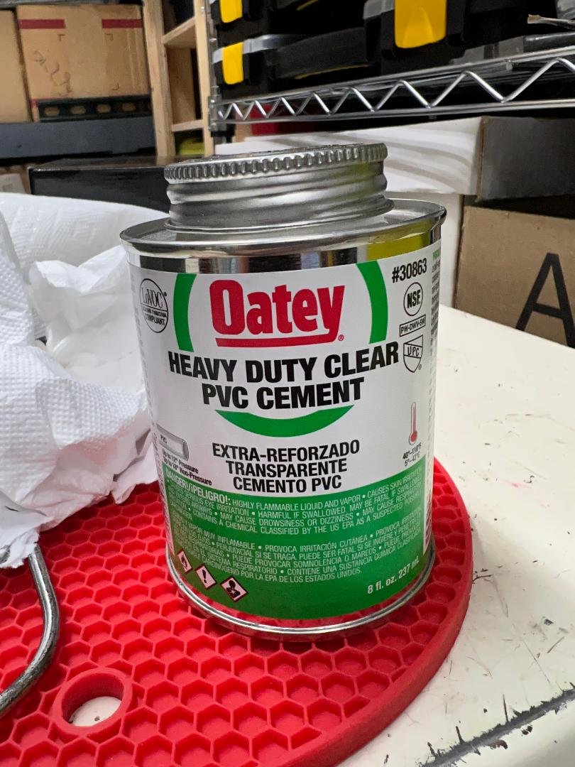

Right now I can't seem to find my can of PVC trim glue. I can find my two part PVC pipe glue but I don't want to see that color. Got to be here somewhere. It looks like a glue up today isn't going to happen.

Well after some hours of searching it is found!
To be honest the search was also a time of cleaning up and putting things away so well worth the effort and time. Even found a few other things that I had misplaced so all is ending well enough. Didn't get to try a glue up but no rush.

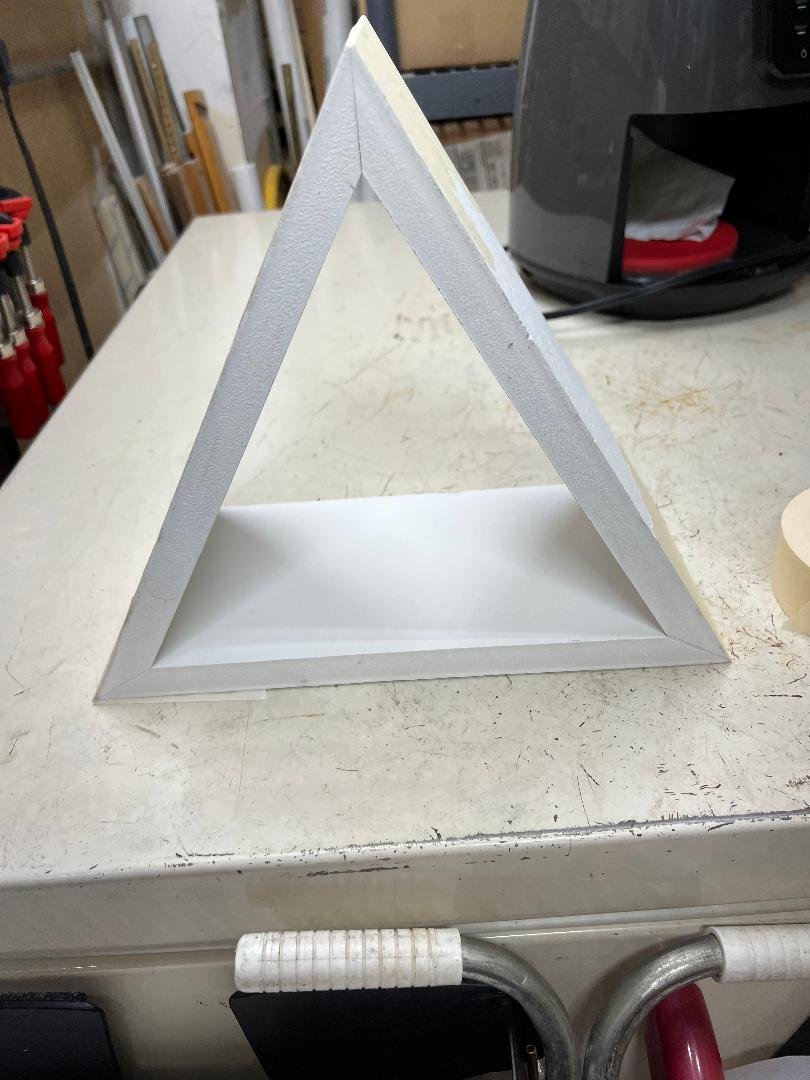

Finally got around to a test fit using masking tape and the flat layout method. It seem to work well and I'm happy with the results. Now to try the glue up one of these days.

The last time I used Oatey PVC Cement was in 2007/2008. Not a thought toward that type of project for years!
BUT.... this Sunday afternoon I went down to the basement for something, and heard my sump-pump burning itself out with a stuck switch. Off to the store for a new pump, some PVC piping bits, and Oatey PVC cement! The old stuff (purple primer and clear cement) was only good for the purple can, so I restocked my cement ... thinking about Reible's post throughout :)

As I recall I started using Oatey because that is what they sold at the Menard's store when I went out to get some. It worked so I just kept using it.

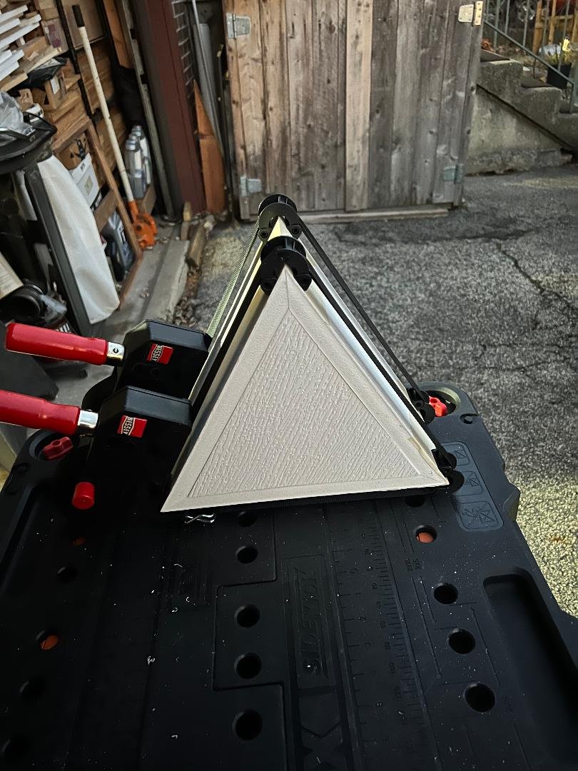

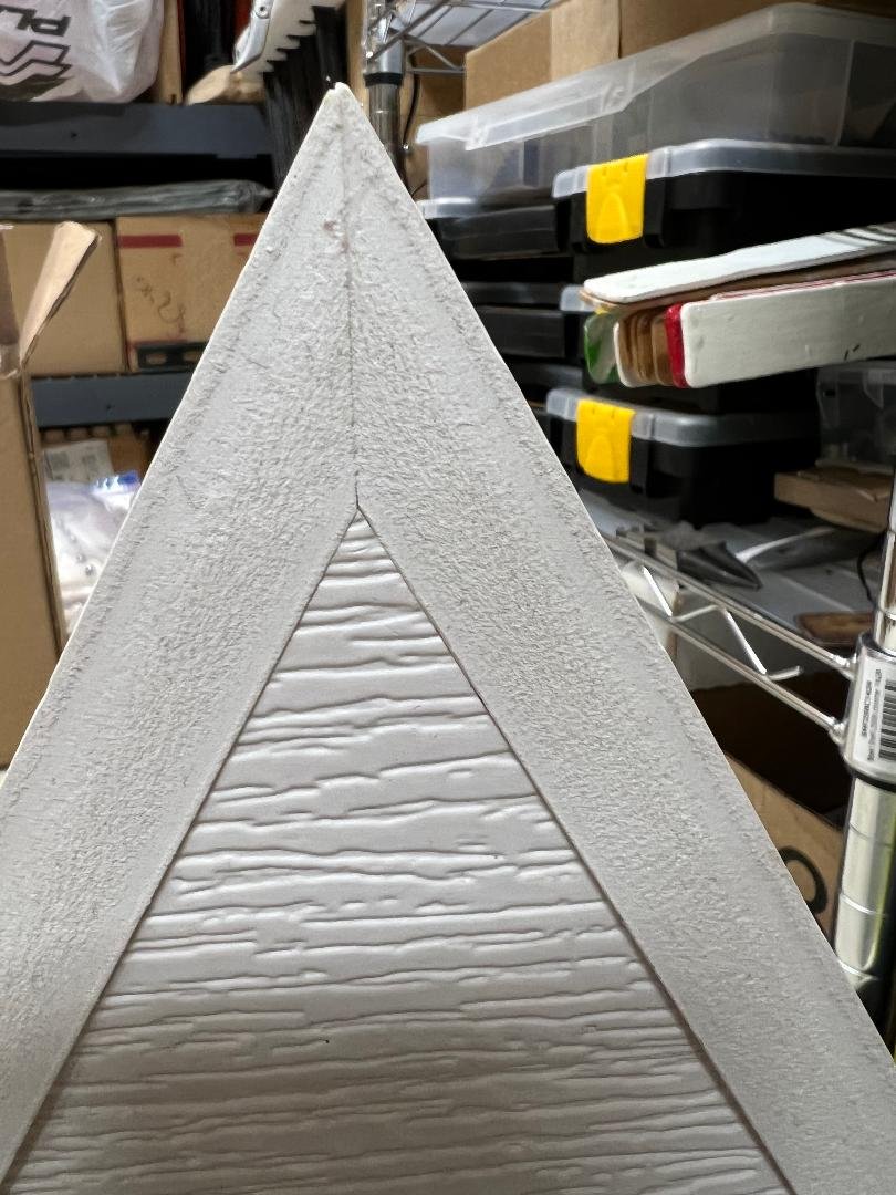

Speaking of that I glued it up today and it is in clamps for now. More then likely done but so am I, so clamps come off tomorrow. For the front and back I need to glue to pieces together to get the height. I traced the inside on the glued up parts and then cut them with the track saw. In the picture you can see the front top to the right. Back is inside and was cut just a little short on the bottom to allow rain to leak out.
So all that is left is the hole and then I think 6 screws, more then likely the blue kreg ones since I have been using them for such projects.

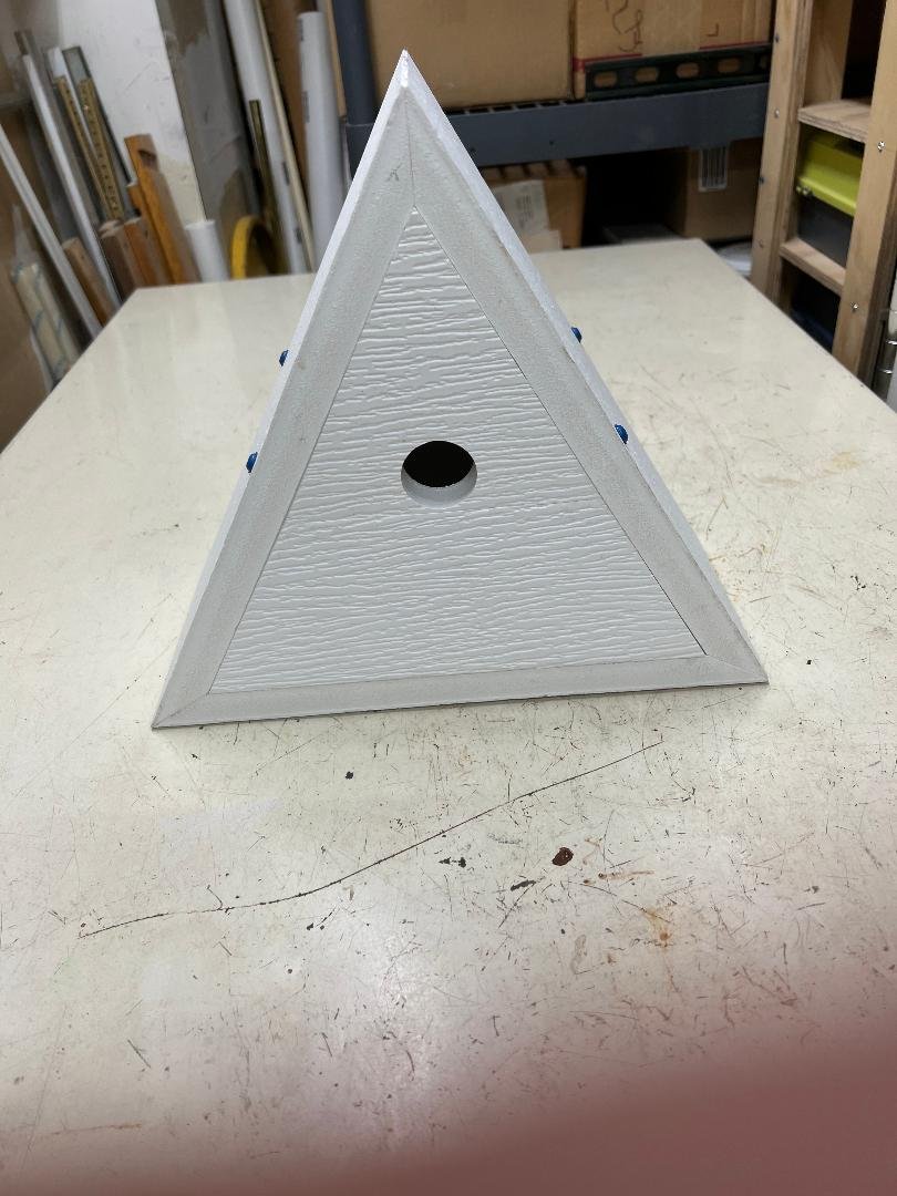

Got er done before the new year!

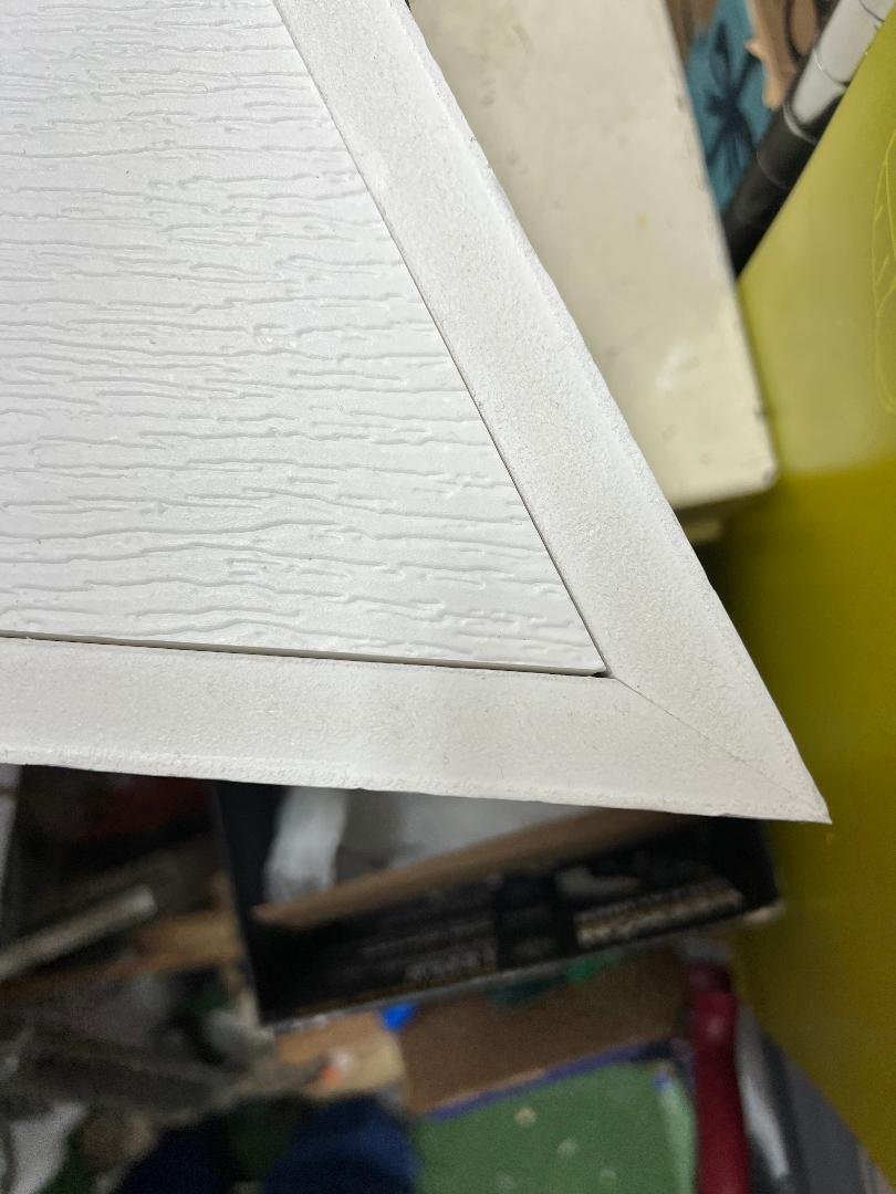

First a shot of how the joints look. I did not go to the very edge of the material to line up the cut as I did not want a razor edge cut for a bird house, so I'm pretty happy with how that worked out.
On the back I cut the piece just short to provide for drainage. I'm not sure if this will be enough but after a year of use I can redo it slightly when I empty it out.

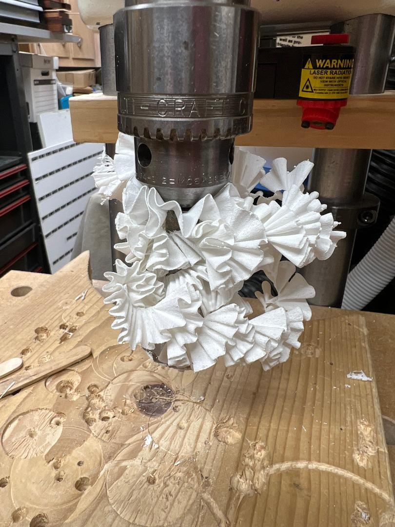

Next is the material from the hole. Wish I could make something out of it as it looks so cool, but I bet it is brittle.
And done until spring when I will find a spot for it outside.
This was a 12" point to point version and if I have enough material left I might do an 8" version later. Might make a table saw jig to do that.

Those miters came out great, Ed. Was your 30-degree jig plus Kapex setup dead on on the first try, or did you have to make some test cuts and adjustments?
Re: Dec 2nd in IL, nice day for projects
Posted: Sat Jan 01, 2022 5:57 pm
by reible
No actual test cuts but I did go longer then I first planned in case I had to do some adjustments and then have to cut again. The big problem I have with the jig is how to get a decent clamping situation.
I have plans for a table saw version that I might build as it would be a lot easier to clamp the work piece in place. I did the plans sometime ago but never got around to actually making it. It would be great for the flag case and other long angles.
