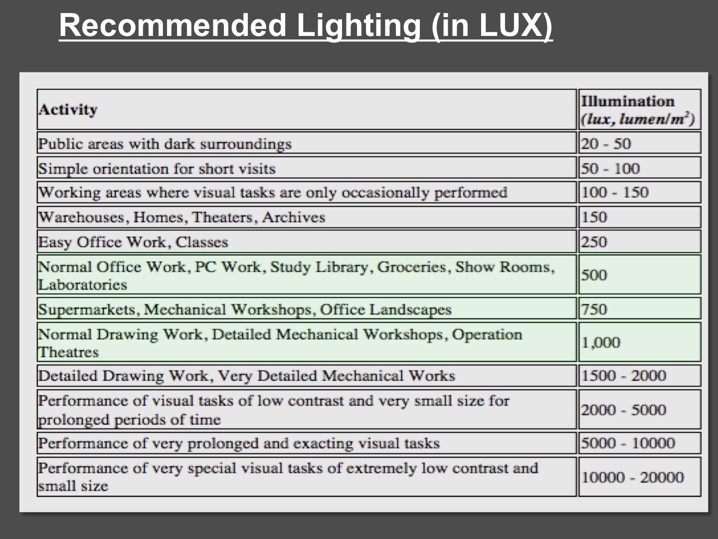

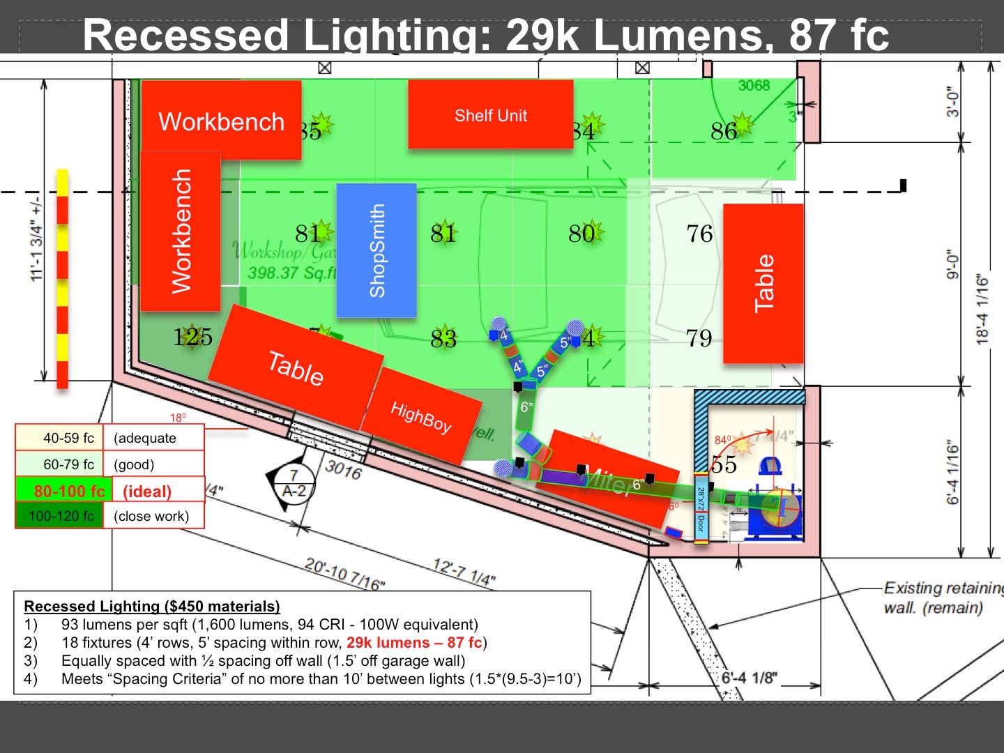

I went down the lighting rabbit hole a couple years ago when I built my shop. I learned a couple of things which might be helpful to others. The first is that you need between 500-1,000 lumens per square meter for good lighting (see the attached table -- note that 1,000 lumens per square meter is approximately 93 lumens per sqft). Another piece of advice was to adjust the spacing of the lights such that they overlap at the height you typically work at. To understand this you need to know the height of your ceiling, 9.5' in my case, and the hight of your typical work surface, about 3' in my case. When I did that calculation the math suggested the lights should not be more than 10' apart.
In the end I settled on 1,600 lumen, 94 CRI LEDs that I spaced about 4.5' apart (rows are 4' apart, lights within rows are 5' apart). That spacing delivers an average illumination of 87 lumens per sqft with no shadows or holes. I also get a little extra light during the day from the garage-door windows (on the right) and the light well on the bottom. It's really nice to have great lighting. I'm glad I went down the lighting rabbit hole!
