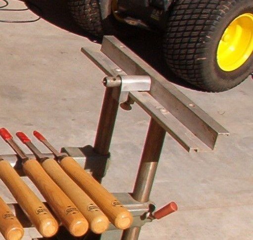

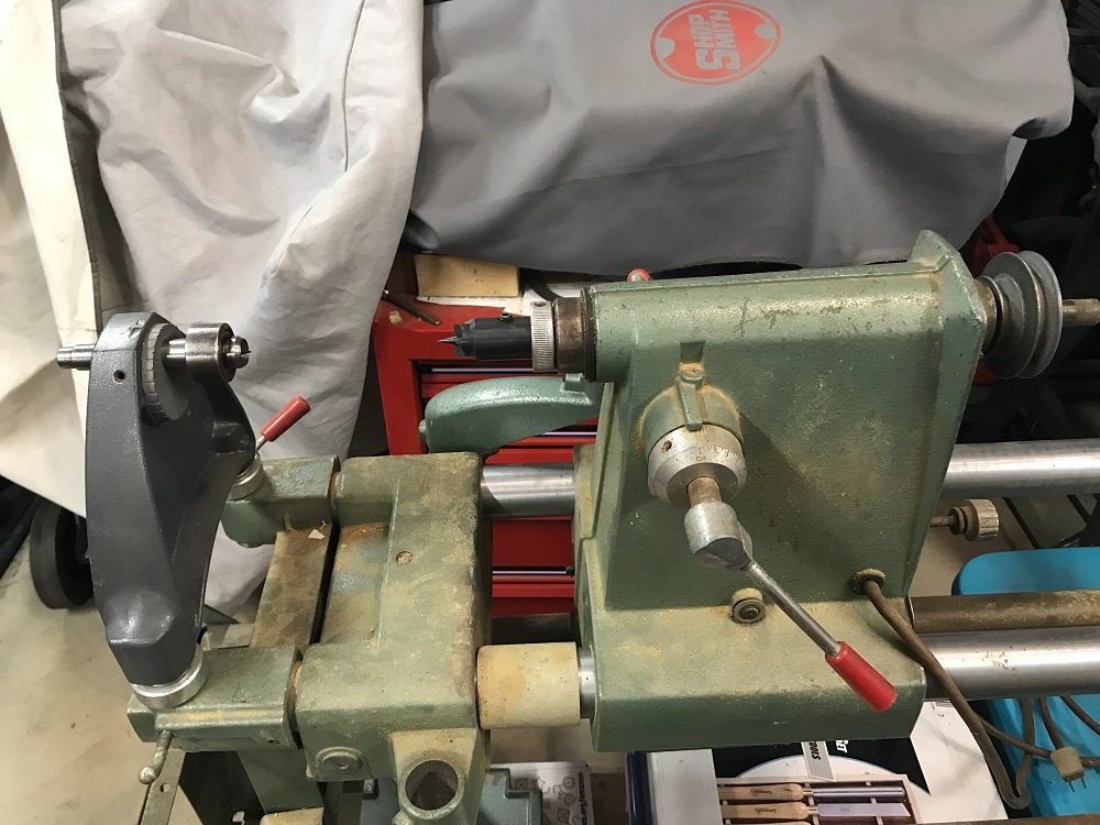

Chad, you asked,
I can't say I'm a fan of the lathe tailstock on the MK 2 though. Probably great for doing off center work. How does that perform?
I haven't used it since I wanted to restore the Mark 2's including replacing the power cords. A safety thing. It can use the Mark 5 Tailstock in place of the "Tailstock" part that clamps onto the Extension Table. Definitely more work for change overs to align it each time you want to use the Lathe function. Both vertically and horizontally.
_
Mark 2 Tailstock mounted.jpg (52.34 KiB) Viewed 1091 times
With Mark V tailstock.jpg (130.96 KiB) Viewed 1091 times
Re: My Bride is Gonna Kill Me! Buying a Shopsmith Mark 2 on a Business Trip!
IIRC the M2 tailstock is positioned horizontally by a notch in the 'extension table'. The vertical is controlled by stop rings same as a M5. Horizontal is adjusted by the mounting of the extrusion to the legs.

JPG wrote: Fri Mar 18, 2022 6:12 pm IIRC the M2 tailstock is positioned horizontally by a notch in the 'extension table'. The vertical is controlled by stop rings same as a M5. Horizontal is adjusted by the mounting of the extrusion to the legs.
Sounds like a lot of work and checking the setup just to use the lathe tailstock on the MK 2. The MK V tailstock would have to be much more solid than the tailstock setup on a MK 2. Being I don't own a MK2 and have never used one, but I do own and use 3 MK V's, and knowing how simple and accurate the tailstock of a MK V is; I'm just speculating here.
I wonder why they didn't simply include a MK V tailstock with the MK 2?
I guess the thinking might have been either they figured most owners wouldn't do much between centers turning on their MK 2, or the cost of a MK V tailstock would have broke their targeted selling price of the MK 2...?

Russ, does a MK 2 have a depth stop lock on the quill? Doesn't appear to have one, in the picture you posted.

Chad wrote: Fri Mar 18, 2022 6:36 pm or the cost of a MK V tailstock would have broke their targeted selling price of the MK 2...?
This exactly! If you were to see one in person, I’m guessing you’d be astounded at how cheaply made it is. I know I was… Lots of sheet metal parts, thin castings, and small surfaces. I find it a quaint nostalgia piece that warrants a restoration, but I’ll never be a hard-core advocate of these.
