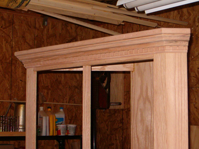

Just got in to this thread - found the "songofthegreatlakes" web site to be agreat one to offer to anyone contemplating a shopsmith purchase.
When reading this thread I once again found a "listed" shortcomming of the SS that I just cannot agree with. What is this business of saying a SS can't handle mitering a long piece of crown moulding (or for that matter any type of moulding)? All one needs to do is first cut off the longer piece to make it shorter. Using a straight 45 (as opposed to a compound) cut off a 4 foot length. Then saw your appropriate miter on the other end. All that is needed now is to put the two pieces back together when installing. Simple and tight fitting! All that may be needed is slight filler and sanding.
Look! most walls and celings of homes are not perfectly square or plumb. You will have to do some touch up filling and sanding anyway.
I Just made a piece of crown moulding from red oak and installed it below the top of a corner china cabinet I am building. The compound mitre joints fit so well that there is no filler needed. Also the grain runs continously around the crown moulding. Made up some dentil moulding to fit below the crown. It all fits very well. Used the SS for all operations except use of a router for the upper line of the moulding.
[ATTACH]90[/ATTACH]
Charlese

The cabinet shown in your last post looks like it is going to be really great. The detail in your crown molding really gives it a professional touch. Yes, miter joints are a very good way to increase the length of a piece of finished molding; this works much better than a butt joint.
Don't overlook the sanding disk. While you have that table or miter set to trim molding, without changing settings, change from saw blade to the sanding disk. Touch those miters with the sanding disc, glue the joint when you install it and you'll hardly be able to find it. It will disappear completely if you're painting.
This requires a bit of forethought to prevent having to change back and forth between saw blade and sanding disk but it works.
