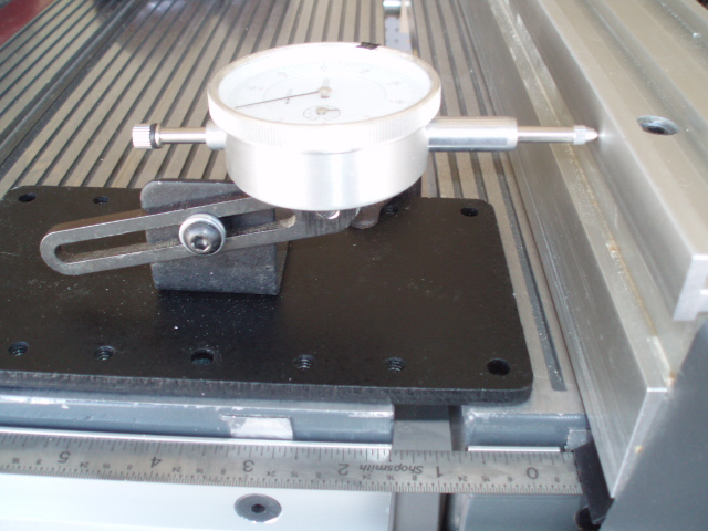

I have had the same problem with the dial indicator not standing stable in the miter track. I have resolved that by mounting it on a metal plate. The plate has been drilled and tapped with an assortment of holes to which I can mount the miter bar.
Dial Gauge on miter bar.JPG (151.16 KiB) Viewed 16857 times

Now that is what I'm talking about! This would solve a lot of it except for the part about the loose fit in the miter slot. (Thought about selling those??? it looks good enough to.) I've even thought about using oak or rock hard maple with an adjustment to get it to a tight fit in the miter slot.
dusty wrote:I have had the same problem with the dial indicator not standing stable in the miter track. I have resolved that by mounting it on a metal plate. The plate has been drilled and tapped with an assortment of holes to which I can mount the miter bar.
