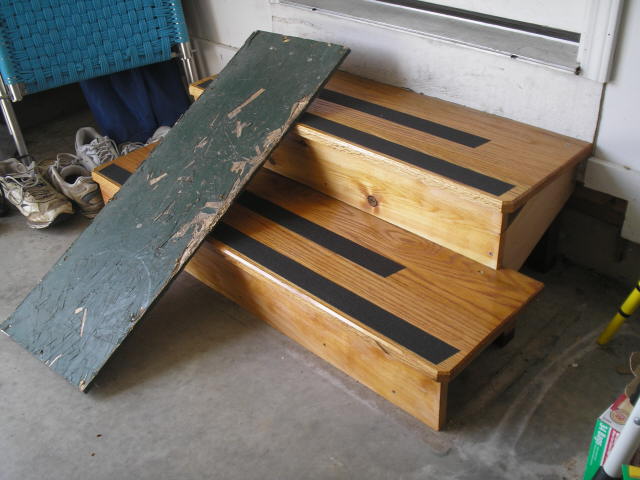

nuhobby wrote:Hi,
I have not really "stairs" but 2 "steps" from the garage to the kitchen. They are aging OSB or some other composite wood, and are starting to look really bad.
I have enough recycled scraps of Oak (probably red oak, I think) to build these steps. They would not ever get direct rain, but they would see temps from the 10s to the 90s during the four seasons. If I account for wood expansion in the design, is oak a good wood here? Or should I go for some ultra-stable wood?

Hi Ed,
Your description is correct. I do have some ignorance on the exact construction method. Rather than stringers & step-boards, it is more like a large torsion-box ('step A') with a smaller box ('step B') on top of it. All in this ugly OSB painted green and chipping away with the "sands of time."
It's very cold now so I haven't pried around to see how these things mount to the wall or the concrete floor. Good point on the wood/concrete chemistry; I'll keep that in mind.

Hi again,
Thanks for all the tips! Finally I got around to this job. I used some recycled oak (for steps) and recycled cedar (for risers). I basically pre-fabbed all the new step pieces, then started demolishing the old junk. Then the new steps went in pretty fast.
Here shown is the new set of steps (with part of the old Green OSB sitting across them).
(Spring is Here)
