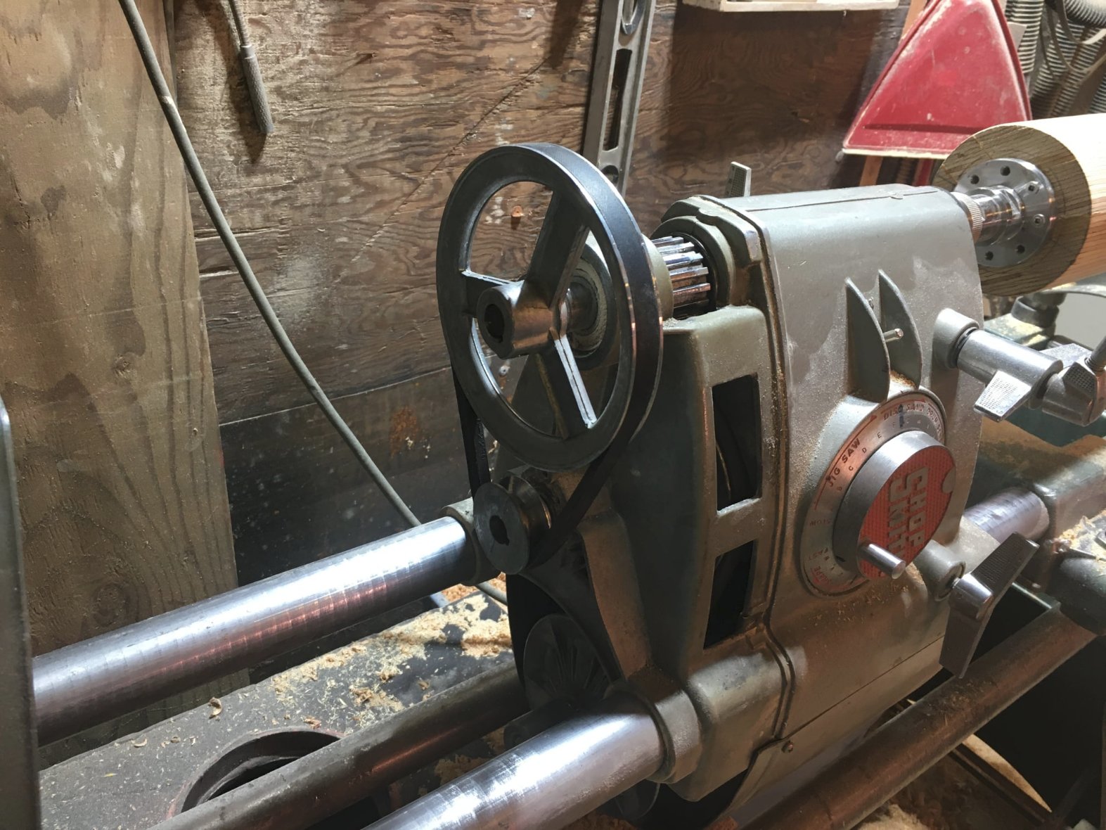

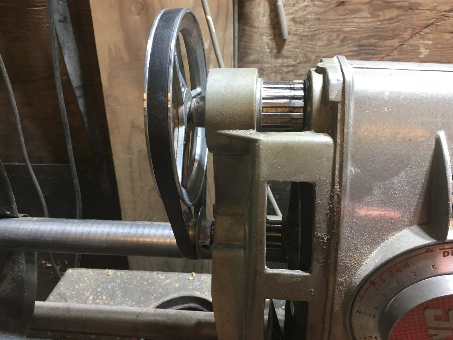

On the Facebook Shopsmith Owners group, member Aguy Increston, posted a mod he had made to his Mark V.
https://www.facebook.com/groups/6844615 ... 0945907992
Message quoted here for those who don't do Facebook. There are also some videos, but I am unable to copy them over.
He has the belt cover off for clarity, a user made external belt cover would also be advised.
Aguy Increston
dSrt10e11otv28mN4g 1b202e20,4 3r ·
$ 50.00 SPEED REDUCER !
I've been trying to figure a way to reduce the speed of my Shopsmith for lathe work , this is what I came up with and it works great , I have two headstocks and one is a dedicated lathe/sander/boring machine and table saw , so I don't need access to the shafts for power couplers .
I removed the Gilmer belt as you can see in video/photos and installed a two inch pulley on the intermediate shaft , then I installed a six inch pulley on quill shaft for some serious gear reduction.
I still have use of the stock speed control , on low speed , it turns at about 300 rpm , WAY lower than the stock minimum of about 700 , and I still have way more top speed than I will ever need.
As a bonus , I won't ever have to do a major disassembly to change a failed Gilmer belt.
The cover is off just for picture purposes , but it goes back on and the pulleys clear it just fine on the outside .
300 rpm seems just fine for any of the out of round or bigger pieces that I turn , and it saves me $500 or so buying the speed reducer and having it shipped to Canada.

Sounds like an excellent idea for serious turners. Even if you don't have an old machine using the Gilmer belt you can often find an inexpensive one, around here $200 and under for Greenies. They will only have a 3/4HP motor but since the mod is more than doubling the torque it should still work well.rpd wrote: Mon May 30, 2022 11:46 am On the Facebook Shopsmith Owners group, member Aguy Increston, posted a mod he had made to his Mark V.
sluce has a 1-1/8HP Emerson, were any of those put on machines using the Gilmer belt?

That is really ingenious, my hat's off to that guy in Crestom I thought he was replacing the gilmer type gears in the machine. That is an incredible option to have for anyone who works at low end RPMs. And you could change the external pulleys to return to normal speeds.
I have wondered why Shopsmith didn't use changeable drive wheels as on the Mark 2. I can see that the headstock body strengthens the drive shaft on top so you can mount accessories, but it isn't doing anything special on the bottom. Considering how thick the main body of the shaft is I'd think it would be strong enough to have an accessory shaft also, but the current design is certainly strong.
