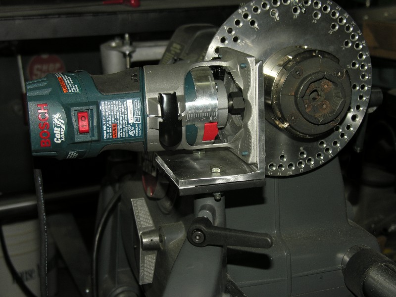

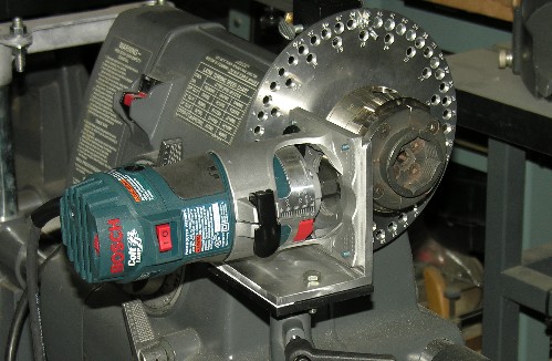

I finished the project of mounting a small router to the tool rest of my 520 to use with the index wheel. With the quill unlocked the work can travel to the router bit or the quill can be locked and the router moved. I don't know how much I will use it, but heck it was fun to built with my SS. Any comments or questions appreciated.
ldh
[ATTACH]3219[/ATTACH]
[ATTACH]3220[/ATTACH]

I like it, ldh!
Chris

The router mount looks great. Thanks for posting the pictures!

ldh wrote:I finished the project of mounting a small router to the tool rest of my 520 to use with the index wheel. With the quill unlocked the work can travel to the router bit or the quill can be locked and the router moved. I don't know how much I will use it, but heck it was fun to built with my SS. Any comments or questions appreciated.
ldh

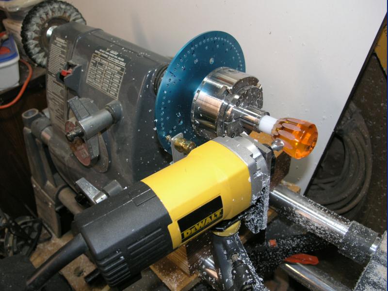

Awesome idea!!
http://www.shopsmith.net/forums/showpos ... ostcount=1
[ATTACH]3260[/ATTACH]
