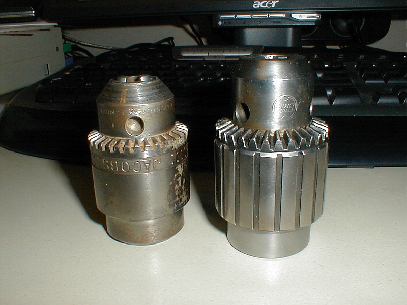

Hi all,8iowa wrote:This has been an interesting discussion. I have just pulled both my old and new chucks out of the tool chest and find]My new chuck, I'm assuming is a Jacobs, however the only marking is the Shopsmith logo.[/color] Both chucks have 30 teeth. However the key hole on the Cushman chuck is drilled for a key with a .172" tip. The tip on the Shopsmith chuck measures .166. Thus the older key will not fit in the new chuck. The key from the newer chuck will fit in the Cushman, but the fit is loose and the operation is sloppy.
In my qwest for a keyless chuck, I e-mailed several pictures of my chuck that came with my Mark V to Jacobs. It is the ribbed one with only a SS logo for identification. Jacobs told me that it is knot a Jacobs chuck.

I wonder....what does this chuck look like? Sure wish I could see some of those photos, the ones that Jacobs looked at.a1gutterman wrote:Hi all,
Hi,
Here is a picture of the two types of chucks I have. They all use the KK key.
Maybe we could get a few other types posted as a reference???
[ATTACH]3178[/ATTACH]
