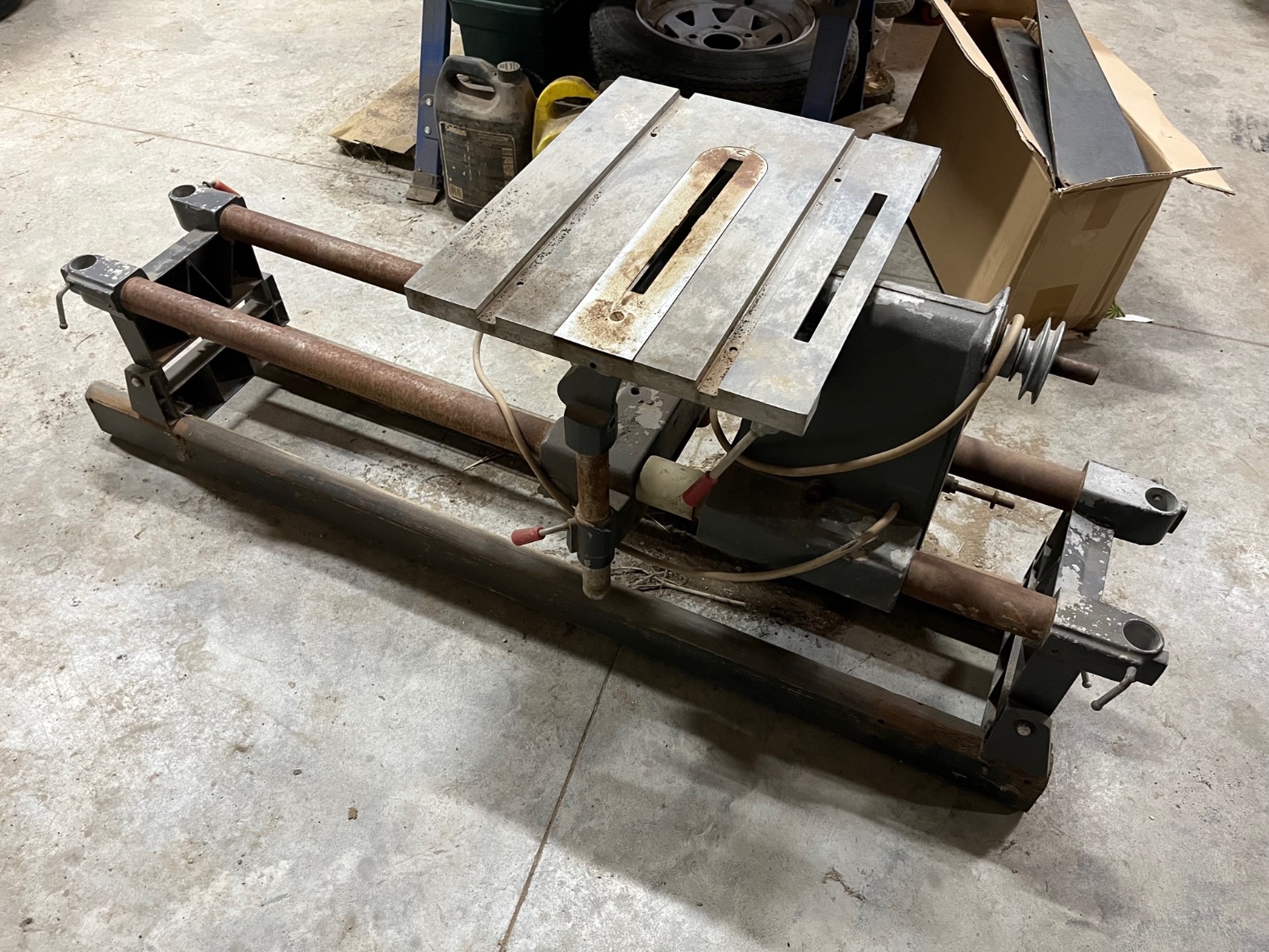

Finally got a chance to pick up the second Mark 2 this evening. It was for sale around Wichita, KS and the guy brought it to the Kansas City area for me to meet him. Still an hour drive but it was better than just getting a few parts and paying the shipping. Here is a picture of the one I picked up.
The main thing wrong with it that I can find is that somehow the support for the table has gotten busted up really badly. The wheels don’t want to raise and lower that well right now so I’ll have to clean them up and see if I can get them to work. I haven’t plugged the motor in to see if it runs but it does spin very easily so I’m guessing it should be okay. You can tell on the saw blade, it hasn’t been sitting for an extremely long time.

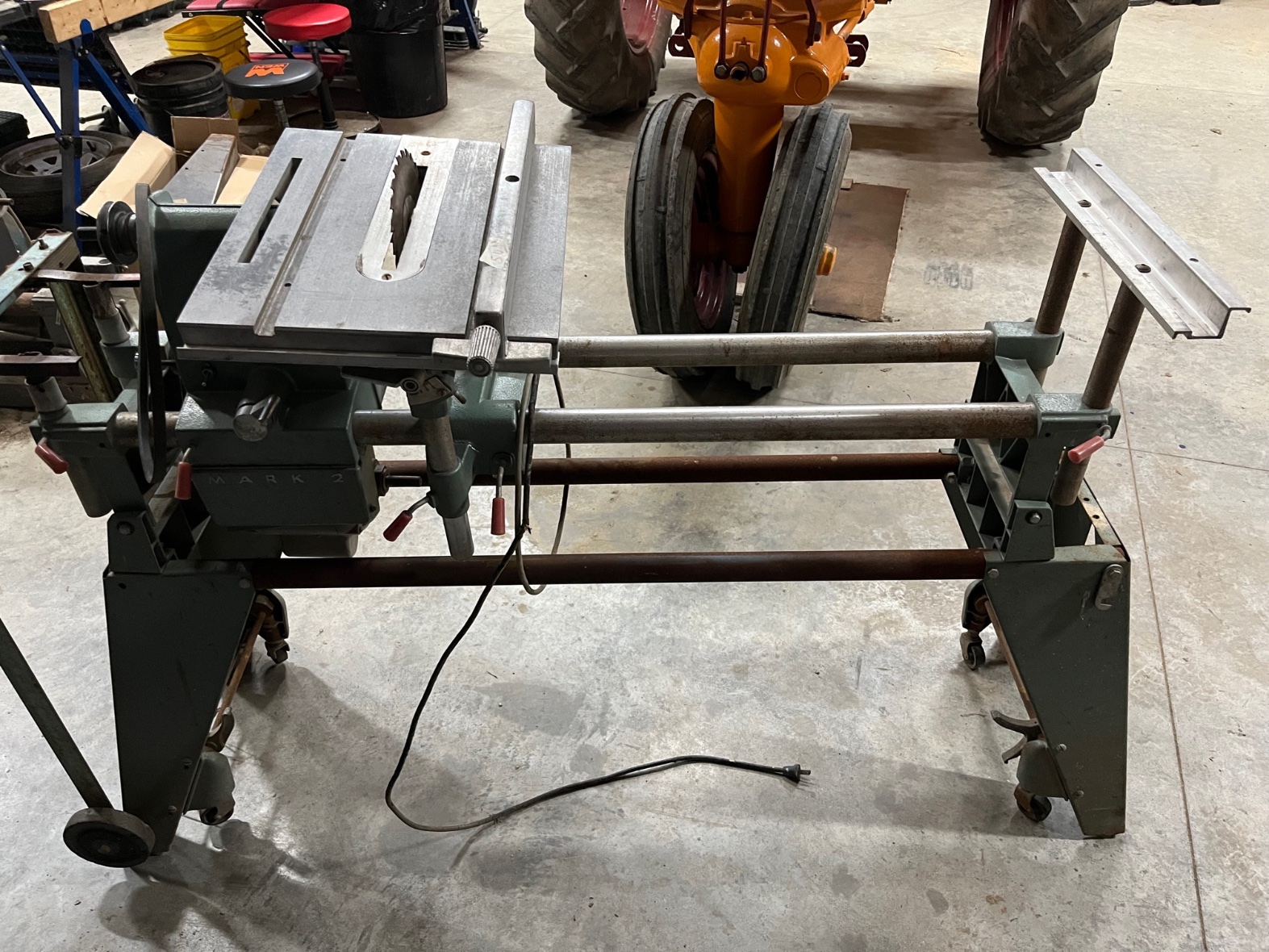

This is a picture of the one we started with. It isn’t all put together because we hauled it home in the back of our Explorer.
I do like the metal instead of the wood and I know our headstock isn’t wanting to turn very easily right now but I haven’t looked at it real close. I’m not sure if we’ll take the table support from ours and put it on the second one we got or try to take the motor off and move it over. After looking at all the pieces my Uncle sent, we have two arbor for the saw, I believe everything for the lathe, the chuck for the drill press, and the sanding disc. I feel I can make one out of the two.
So I do have one more question, when did they change the color? After looking at the serial numbers, the one I picked up today is older than ours and it is more of a green color. Ours is kind of a grey color. I didn’t realize they changed colors and I figured the wood rails were used on the older models and not the newer ones…

Both parts are broken, the Tie Bar and Carriage mount. It look like it was maybe dropped at some point or someone put something heavy on the table. I’m kinda leaning toward putting the motor on the gray one and switching the wood and pipe tubes around.
