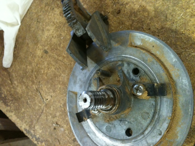

Total Shop broken part
Post by fwade »
I have attached a picture of a part that broke on my Total Shop. Any ideas on where to find a replacement? Speed control is what I think it is called. This is my first post so if it is not posted correctly someone please tell me how to post.

Each Total Shop that I have seen that did not operate had the identical problem, broken speed control assembly legs. The bracket material (legs) cannot be brazed or welded, a pot metal type material. Luckly, the Shopsmith speed control assembly legs bend and not break most of the time.
I was able to machine and jury rig a Shopsmith speed control assembly one time but was not happy with the results and labor was excessive. It is not a bolt in change. If you wish to contact me, I will dig around to see what solutions and fixes I offered years ago. I still have a Total Shop headstock that I can use to check out any solution I may be able to find or think about. The Total Shop was a better and stronger HP machine at that time.
The last few Total Shop owners with problems accepted my solution by using the Shopsmith headstock as a replacement. The Total Shop has 1.675" way tubes but by filing out any wear on the lock wedges, I was able to determine that the Shopsmith headstock will lock down and maintain correct alignment, just a little lower overall. My Shopsmith headstock rebuilding jig uses a Total Shop base, base arm and half length way tubes.
