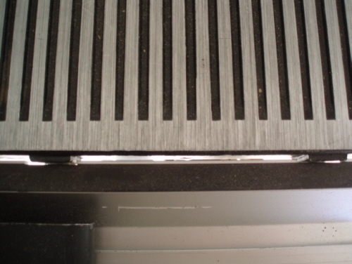

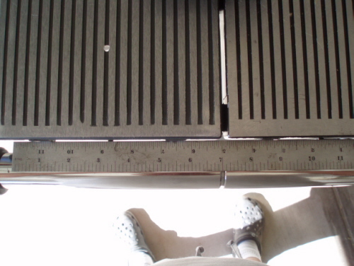

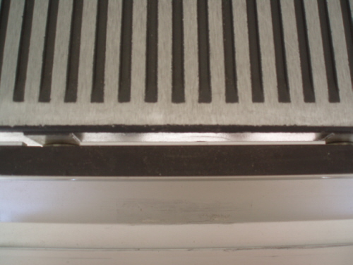

I am relatively certain that all of my tables were manufactured by Shopsmith but they do not all look alike. That being the case, I decided that I better make some quick measurements.
The tables that I have all measure very, very close to 22" (maybe 21 31/32"). I don't have anything to mic something that large so my measurements were made with a long steel rule.
It is important to note that these measurements are all taken from the front boss to the rear boss. The edges of the actual table surfaces are not consistent but the bosses are.
With two tables on the front rail, side by side - the bosses line up exactly (both front and rear). The bosses, however, differ somewhat from table to table. I have one table whose bosses are considerably thicker than the others.
[ATTACH]4465[/ATTACH][ATTACH]4466[/ATTACH]
[ATTACH]4467[/ATTACH]
- Thinner Bosses.jpg (65.22 KiB) Viewed 8634 times
- Thicker Bosses.jpg (85.15 KiB) Viewed 8630 times
- Front Bosses on Adjacent Tables.jpg (86.19 KiB) Viewed 8635 times

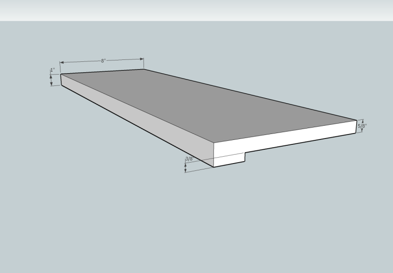

As a result of this thread and my own inability to envision what the problem might be, I changed one of my main tables and a floating table back to a 510 configuration.
I then proceeded to do a complete table alignment. To make this an honest effort, I loosened all of the nuts that secure the rails to the two tables and started from scratch.
What did I learn (if anything):
1) The tubes that you use for this process must be straight. A bent tube can be detected by simply rolling it on a flat surface. I set aside one tube that I have been using regularly in my setups.
2) The alignment of a 510 table set is a bit more demanding than the same procedure for a 520.
3) The distance from the plane of the tables to the top of the rails (front and rear) is 3/8". I am going to make up a jig that can be used for this alignment. I believe it would make the procedure much less painful. The jig will serve the same purpose for the 510 as does the aluminum gauges that are recommended for use with the 520.
4) Once properly aligned, the 510 is every bit as accurate as the 520.
5) To complete the alignment, I ended up using a .043" shim on one end of the extension table. I sorted through a few flat washers to get the right one.
The jig that I am going to make will be something like this. Except that I left off a critical dimension. I will make it 26" long so that it will span both a main table and an extension/floating table.
[ATTACH]4479[/ATTACH]
- Extension Table Alignment Jig.png (31.56 KiB) Viewed 8586 times
