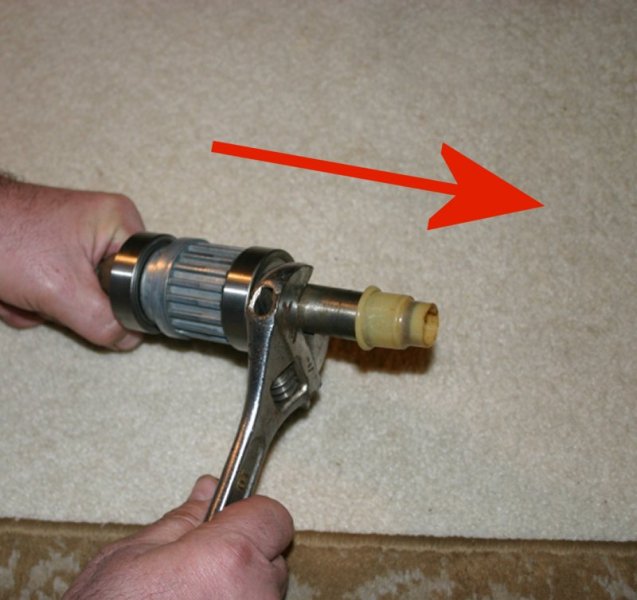

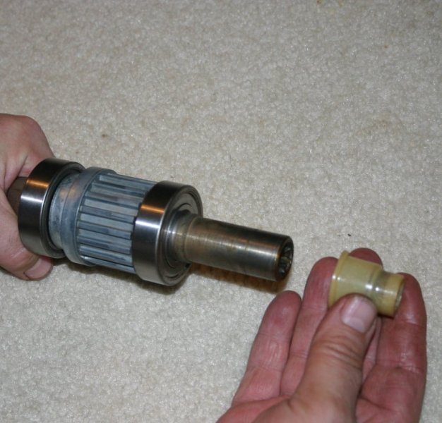

Tried removing the nylon piece with the screwdrivers but it was not budging. Instead, took an adjustable wrench and used it to "thunk" the thing off. Took about 10 wraps but it worked pretty well.bettyt44720 wrote:the nylon drive can easily be removed with two screwdrivers (one on each side) and pop it off. it has a spring type retainer. then pop it back on when ready. i have pressed several sets of bearings on in my machinst type vise using sockets the proper size. never press on the balls of the bearing or the outer race.

There was no "spring type retainer" like you mentioned. At least I didn't see anything other than the nylon piece.
Can't figure out why the nylon part description (part #57) is "drive and ring assy". All I see is a single piece of nylon. Not much of an assembly.

You have 'encountered' the differences between a gilmer belt and poly v belt drive shaft(sleeve) assembly. This difference is one reason the 2 bearing quill is not compatible with the gilmer version. No it does NOT have a retaining spring.

i'm sorry. i did not follow the thread close enough. i was talking about popping the nylon drive on the poly v system. the plastic sleeve on the gilmer does not drive the quill shaft like the one on the poly v does. the poly v main shaft does not have a metal spline, the gilmer does. not sure of the purpose of the piece that you show but am familiar with it.
On the Gilmar drive the nylon piece acts as a dust shield. It is missing on my Greenie and the lack of one has not caused any problems. I don't believe you can purchase a replacement.mickyd wrote:Tried removing the nylon piece with the screwdrivers but it was not budging. Instead, took an adjustable wrench and used it to "thunk" the thing off. Took about 10 wraps but it worked pretty well.
