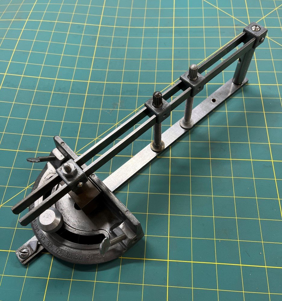

So after watching that video and skimming the instructions for the hold down kit... Did I miss the answer to the question of what the threaded hole near the end of the early miter bars is for? Does the 'threaded post' fit into it and, if so, is there an application where you'd set it up that way? Tom only used the countersunk hold in the video, and that was all I saw in the manual.
- David
Posts: 4536
Re: Holes on miter gauge
As I said in my first post in this thread referring to the threaded hole near the end of the Miter bar.
The second threaded hole can hold the other post with a threaded end, but that post was generally used in the hole the Safety Grip attached to. I don't recall if there was another use for the threaded hole.
So, I don't recall what the threaded hole on the Miter bar is actually used for and I don't believe it was intended to hold the threaded post from the Universal Hold Down. The reason is the Universal Hold Down came out during the Model 10's production and one of it's uses was to provide hold down functions similar to the Safety Grip. The Universal Hold Down has many other possible uses not involving the Miter. Attached below is a PFD of the instructions for the Universal Hold Down made during the Model 10ER Production.

I am a "collector" of Shopsmith items and this is part of the collection. Just because they are restored now looking pretty and like new doesn't mean they cannot be used. That includes my recently restored Mark 2 and my Model 10E which was part of the original 250 sold to Montgomery Ward that started it all. The Delta Hold Down set up shown in the video you linked above is one I also have. It is mounted on an early Model 10E Miter which is shown below.
