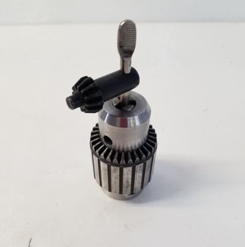

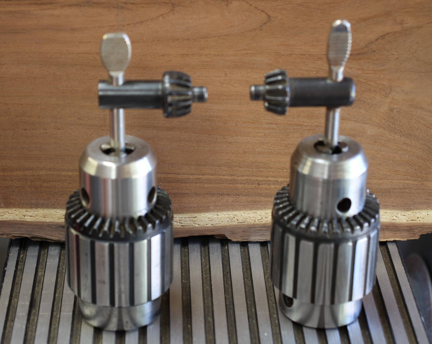

Temporarily skipping over the details, I'm convinced that there are two or more versions of the look-alike Shopsmith Logo drill chucks and that they may require different, though very similar, chuck keys. Digging through some boxes I located a second chuck that exhibits the jamming I mentioned earlier. The 'key' difference is that this chuck was stored with its key. Here is a picture showing the two key versions:
Chuck Keys.JPG (232.52 KiB) Viewed 3861 times
The one on the left works in some SS Logo chucks but is the one that jams in the other. It appears to me to be the same as what the OP obtained from SS. The key on the right is the one I just found, it works in the chucks that exhibited jams and works but is a sloppy fit in the others. Noticeable differences are a smaller gear and a different shape to the thumb pad.
I'm not really able to differentiate between the chucks themselves visually. Therefore, I can't simply look at the OP's post and say definitively that it needs the key on the right. I have one that jams and one that does not disassembled and I'll update here if anything is revealed upon closer examination. Russ mentioned in another thread that there are three versions of the logo itself. Suggesting something. There were no pictures, and I believe the jam/no-jam examples I'm working with have the same logo.
I mentioned earlier that I like the Jacobs better, much more of a quality feel despite being ~twice as old. I will add, though, that the SS Logo chucks close on a smaller diameter. A difference that would be significant for some small bit sizes. Shopsmith says down to 0.020" for the current version. IIRC the Jacobs is a minimum of 5/64", or 0.078".

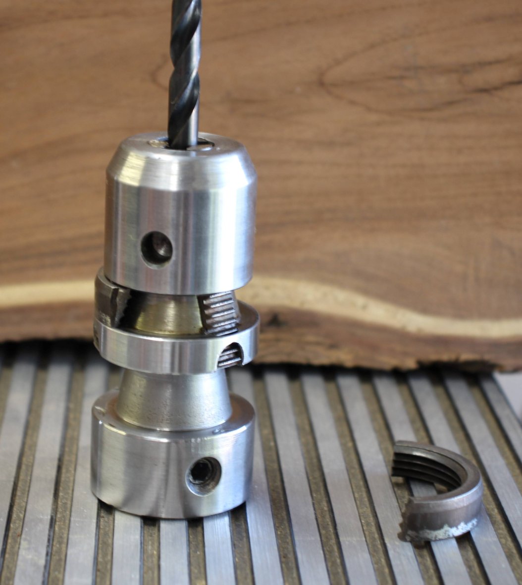

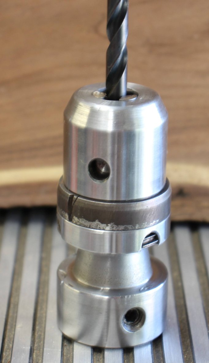

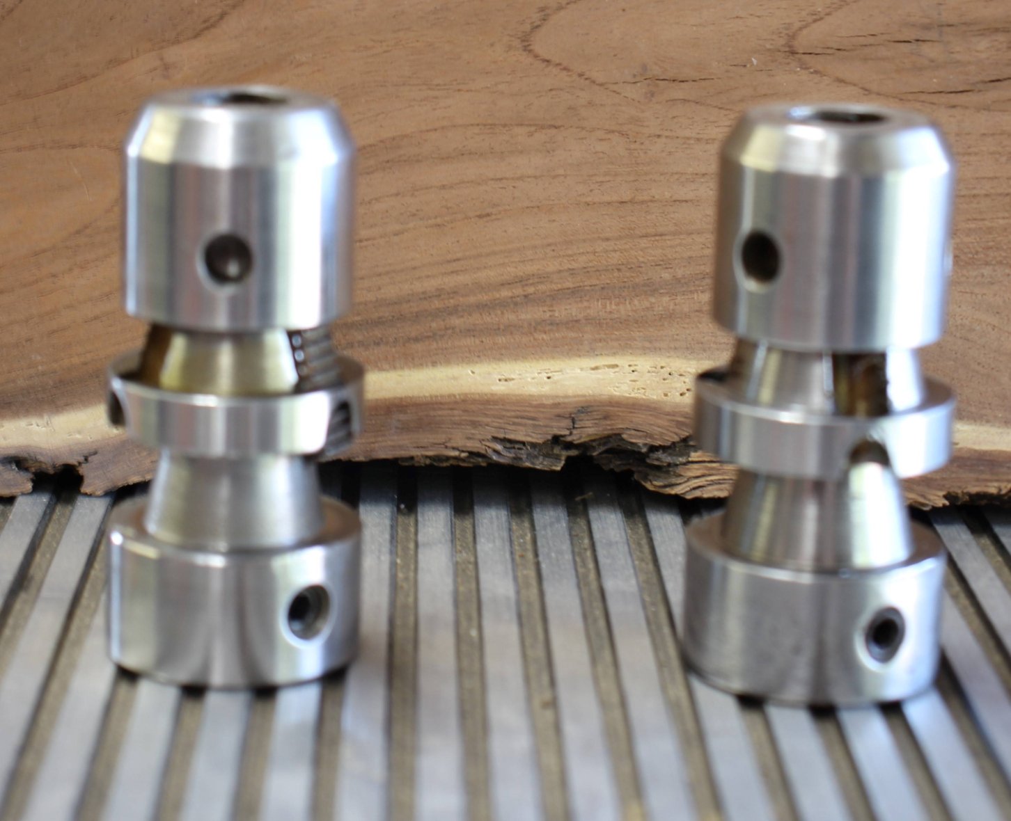

Summary: This post details internal differences between two examples of look-alike Shopsmith Logo drill chucks. The differences, IMO, demonstrate that the chucks are manufactured to different standards, perhaps by different suppliers. And explain why the chuck key currently offered by SS may not be compatible with some of the older look-alike chucks. I'm not confirming that this has anything to do with the problem reported by the OP. I am confirming that yes, I have a couple of chucks that have the same symptoms and am satisfied that I know this is the reason. My conclusion is that there are two or more versions of look-alike Shopsmith logo drill chucks that utilize different keys. The bottom line is that if you buy the current version chuck key, it may or may not work well on a Shopsmith Logo chuck,
The first picture shows the internals of a chuck that jams on the current key. It is fully assembled other than the sleeve being removed. The split nut rides as shown, and bears against the lower (in the picture) seat when snug/tight as shown. The sleeve, which includes the 'ring gear' seats on the split nut. Therefore, the key reference surface for the chuck is the lower (in the picture) seat. So I measured from that reference to a reference point on the chuck key pilot holes. That reference distance varied by 0.062" (roughly 1/16") between the body of Chuck A, that jammed, and Chuck B, that did not. This is a precision part, there is simply no way that this amount of variation could be explained other than two different manufacturing specifications:

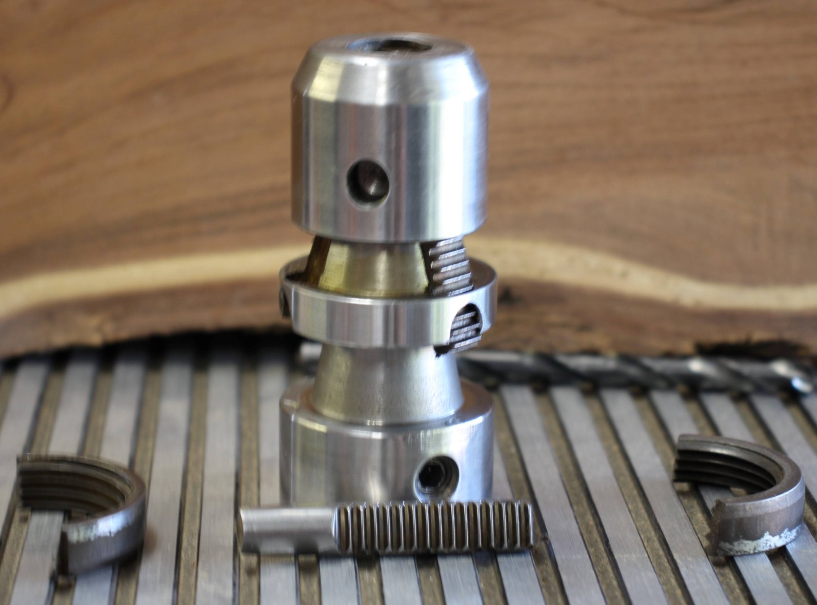

Followed by a few pictures of the internals, progressively disassembled, which are similar in function to the Jacobs:
IMG_9186 (2).JPG (120.95 KiB) Viewed 3820 times
IMG_9188 (2).JPG (167.54 KiB) Viewed 3820 times
IMG_9192 (2).JPG (182.83 KiB) Viewed 3820 times
On the last picture of the two bodiesit is difficult to tell the difference. But there is an ~0.062" (~1/16") between the reference surface for the split nut and a reference point on the chuck key holes. The sleeves are also different.
And the two chucks reassembled and shown with their proper keys.

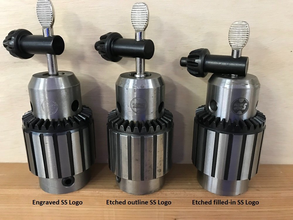

Posts: 4521
Re: Drill Chuck Key Jams
Reading and looking at Davids post above made me curious about the current style Drill Chucks I have. In picture 4 above with the two Drill Chucks disassembled It does appear that the pilot holes are at different distances from the from their split nut's location. There could be a difference in the sleeve to make up for that. In picture 5 above with the two assembled Drill Chucks complete with Keys I noticed the Keys are different. Unfortunately, none of the pictures of the parts or complete Drill Chucks David posted show the actual Shopsmith Logo on them. David mentioned that I stated a previous post that there are 3 different labels for the Shopsmith Drill Chucks since the change from the Cushman Drill Chuck that replaced the Jacobs Drill Chucks. That's all for the Drill Chuck history lesson for today. Below is a picture showing the 3 different labels of the Shopsmith Drill Chucks.
_
Current style Drill Chucks - labeled.jpg (124.69 KiB) Viewed 3800 times

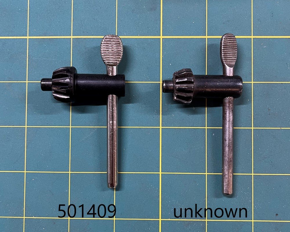

It is the filled in Etched Label that is the current one. On the current one notice the Key is sitting lower in the Chuck. This chuck is open inside all the way through. The other two label version Chucks are not. David showed in picture 5 two different Keys in his Drill Chucks. I have that also and they are shown in the picture below.
_
501409 and unknown Drill Chuck Keys - labeled.jpg (217.13 KiB) Viewed 3800 times
You can see the difference in the unknown part number Key (which may also be P/N 501419) having the open end on the back end of the gear teeth. The gear teeth themselves are different between the two Keys. I have 5 of the Shopsmith labeled Drill Chucks. Two of the engraved Logo, one of the etched outline Logo, one of the etched filled in Logo and one with the Logo worn off which I believe was the etched filled in Logo. The Chuck with the worn off Logo is also open inside all the way through as noted above about the three different labeled Chucks. I have 4 of the 501409 Keys and 1 of the unknown P/N keys. I do recall ordering sometime in the past a replacement key for one of the Chucks that was missing it. It is one of the four 501419 Keys. As for how well the two different Keys work in the Chucks, the closed end Key works pretty well in all 5 Chucks while the open end Key works a bit rough but still able to do the job. Oddly enough that key is with the Drill Chuck that the Logo is gone and is the Drill Chuck I use the most. Really not that bad at doing the job.
For the ones I have, both types of these Keys have a 17/64" pilot as per my measurements. The outside diameter of the closed end Keys is 49/64" and the open end Key is 47/64" just slightly smaller. I don't believe that makes a difference in their function. I believe what does make a difference in their function is the shape of the gear teeth as can be seen in the picture above. Pushing the open end Key against the pilot hole may be the reason it feels rough during use as those teeth may not mesh as well as the tapered teeth of the closed end Key.
For those with older Drill Chucks these are the current Keys they use.
The Jacobs 33B with adapter and 3326 Drill Chucks use a key with a larger gear diameter and a ¼” pilot, Current Jacobs part # 30251
The Jacobs Multi Craft & Cushman Drill Chucks use a key with a smaller gear diameter and a 9/32” pilot, Current Jacobs part # 30250

Both were filled logo before cleaning them up. ;) As near as I can tell, your key labeled "unknown" is the same key that worked significantly better on the chuck on the right in my last picture. I am going mostly by the look of the thumb rest and gear. I think I saw others like both examples on eBay, but it was a couple of weeks ago.

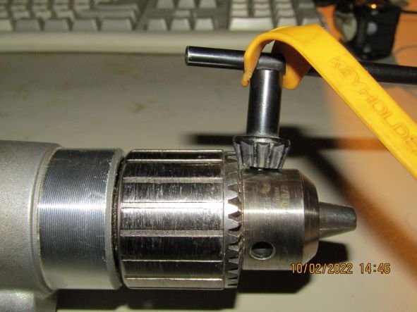

On my drill I measured the pilot shaft and the chuck bore - they are in fact closer than I thought, about .001" clearance (15/64 nominal dia). But the attached photo shows how much play there is - enough to be a problem each time I use this tool. I suppose it could be attributed to a defect in either the key or the chuck.
I do not see tooth mis-mesh or interference. I will say that my chuck is a knockoff, not a real Jacobs, based on the etching on the chuck. Also I think the key teeth are cast (or forged?), as is typical of chuck keys, and this could introduce much variation. I think the pilot shaft is typically cast also.
Another variable affecting mesh is the distance between the center of the radial chuck bore(s) and the chuck bevel gear.
IMG_2482 (3).JPG (41.49 KiB) Viewed 3688 times

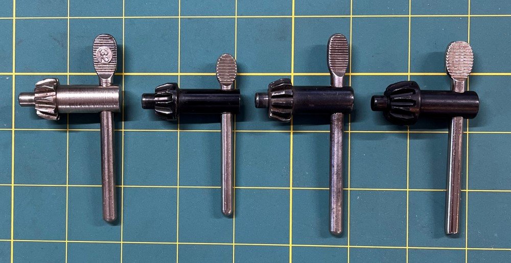

I feel I may have introduced some confusion to this discussion. When I referred to smaller and larger gears on the Keys it was not for the two versions of the current key but was including of the two sizes of the keys for the original Jacobs and Cushman Drill Chuck Keys. The picture below shows the 4 different Keys I have for the Drill Chucks used on Shopsmith tools through the years. From left to right, the first is the Key for the Jacobs 33B and 3326 Drill Chucks. The second is for the Jacobs Multi-Craft and Cushman Drill Chucks. It is that key to which I am referring as having the smaller Gear. The third and fourth Keys are the ones we have been discussing in reference to the more current unknown manufacturer(s) of the Shopsmith Drill Chucks. The difference between those two, from my perspective, is the gear on the third having an open back end and the teeth being different than the fourth Key with the back end closed.
_
Drill Chuck Keys.jpg (114.26 KiB) Viewed 3674 times
Is this still clear as mud or did it help?
The second key above which is current Jacobs part # 30250 is a "T" Handle instead of the Thumb Handle (as they are called) shown above.

chapmanruss wrote: Sun Oct 02, 2022 5:04 pm Is this still clear as mud or did it help?
It helped. I don't have any Cushman or Multi-Craft, so I've been using 'small' gear in reference to the third chuck in your picture, aka 'unknown,' and only in comparison to the 4th. So yeah, I was thrown off.
