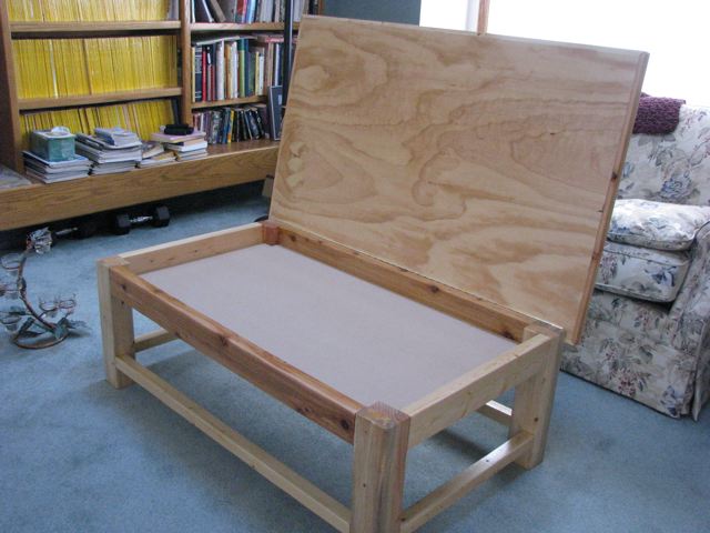

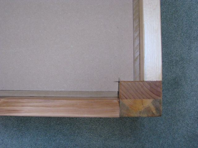

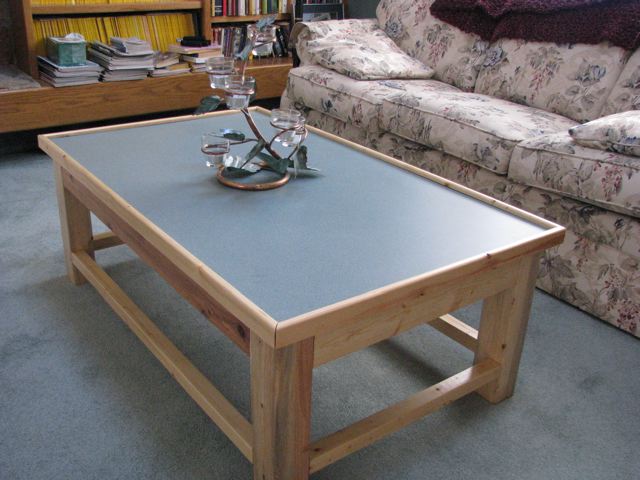

Mortise & Tenons on my SS
Recently I built a coffee table project out of scrap construction-grade 2x4's and plywood - mostly as a prototype and to learn from the experience before I put out heavy cash for expensive wood. Not having the mortising jig or router chuck, I cut the mortises using a 3/8" Forstner bit - with the SS in the drill press mode. I would not do this again - the table is simply not steady enough. I noticed in Nick's demo video, he used the extension legs to steady up the table using the mortising attachment. I think the horizontal mode would work better. I, too, left the ends of each mortise slot rounded and just rounded off the tenons to fit. Some hand smoothing of the mortise slots was required with a chisel.
The 1 1/2" long tenons were cut with the table saw using repetitive passes with a stacked dado blade - again smoothed up with a chisel.
On the next go-around, I would build a jig to ensure exact placement of the mortises on each leg, and I would insure the the legs are exactly square in crossection - not stacked 2x4's - resulting in a rectangular crossection. Oh well - that was the reason for the prototype! Pictures attached.

- a1gutterman
- Posts: 3653
I haven't ever heard of that one. Its a good idea for a really strong joint.JPG40504 wrote:This is going to sound weird, and time consuming, but it does work. A problem with a mortise made with a SS router bit is that the ends are a semi-circle. By routing(similar to drilling) two holes in the tenon piece before cutting the tenon at the distance apart = to the location of the 'ends of the mortise' you can insert two dowels in the mortise and slide the tenon between them. This also reduces the need to control the depth of the end shoulder cut(no shoulder[the dowel hole intersects]). The dowel hole in the tenon piece can be 'drilled' deeper than the actual tenon. The mortise piece can be be deeper 'drilled' similarly.
More work, more exacting, but less stressful than trying to make 'square' holes.
Another approach!:)
Hi, shophaven! Thank you for posting on the Forum and even better, Thanks for posting photos of furniture you made. Your table look real good! Don't really see a big issue with the joints. What did you use for the top surface? I love the way the top is hinged!
