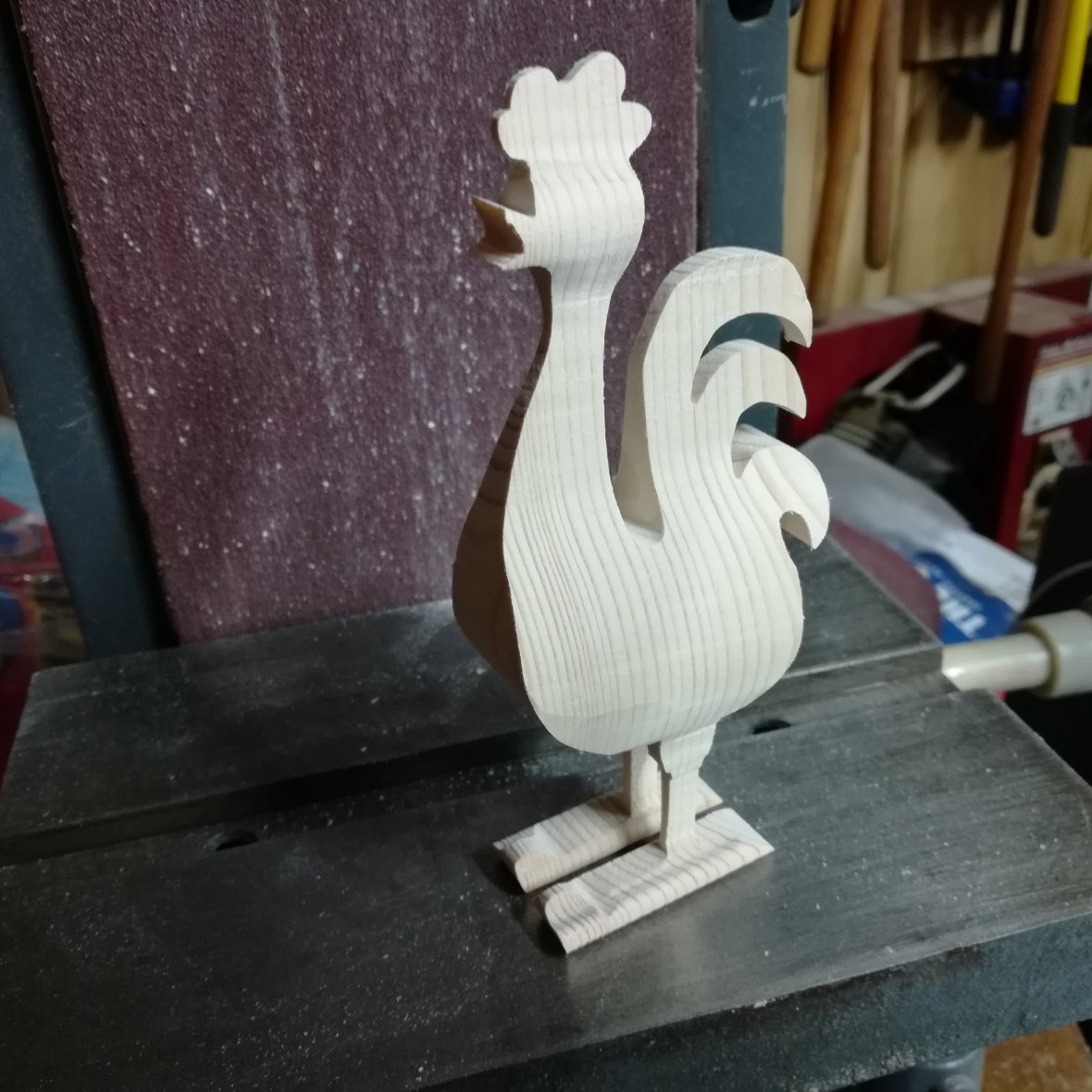

Obviously, you have never watched the demo where they cut reindeer out of 2x4. I cut this
20210102 143747 Toymakers Shop Chicken Rooster Carter Guide 2x4.jpg (181.8 KiB) Viewed 530 times
chicken from a 2x4 using a carter stabilizer and a 1/8-inch blade.

rlkeeney wrote: Sun Dec 11, 2022 8:03 am Obviously, you have never watched the demo where they cut reindeer out of 2x4. I cut this20210102 143747 Toymakers Shop Chicken Rooster Carter Guide 2x4.jpg chicken from a 2x4 using a carter stabilizer and a 1/8-inch blade.
I have been looking at some demos now. My concern here was getting vertical cuts through wood for bandsaw boxes up to maximum depth in the Shopsmith, something just shy of 6 inches. Carter didn't recommend the guide for that usage, although in one demo I see it doing a good job up to several inches deep. My concern with the guide is the blade twisting in the cut. For now, the single stack of bearings I set up at their recommendation is doing a decent job with 1/8" blade, though it is only a little better than using cool blocks.
