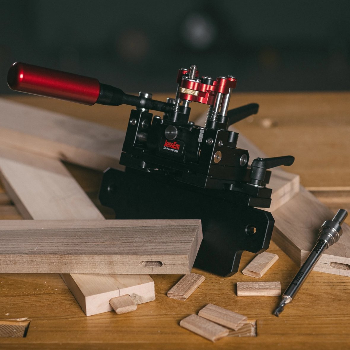

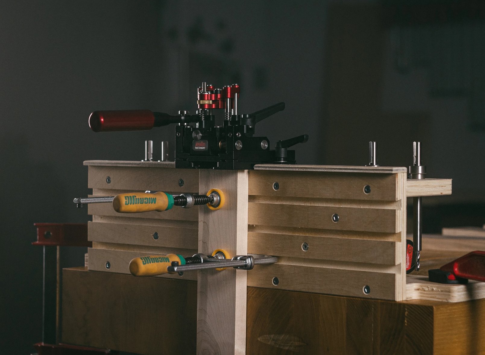

So, it is officially launched as a pre-order now for the bargain basement low price of $349.99 American US Dollars. It slices, it dices, but wait...there's more! :D It's official launch name has been changed to "Pocket Mill Pro - Loose Tenon System", Model # 08250. It comes with a 6mm carbide end mill, but 5mm, 8mm, 10mm, 1/4" and 3/8" end mills are available separately. You are expected to make or purchase your own tenon stock separately. It is also sold as a kit with a Baltic Birch workstation and Micro Jig clamps as an option. I still say it is an ingenious design and it looks well made like all of Jessem's products, but at this price point I have to question the value of this compared to other joinery methods or springing just a few more bucks for a Festool Domino. JMO.
Inside the carriage there are two indexing plates under spring pressure. With each side-to-side pass one of the indexing plates engages with one of the indexing pins as it walks itself down 0.050 thousandths of an inch until the desired depth. Once your cut is complete, simply press the release button and the Pocket Mill Pro pops back up into the start position.
The Pocket Mill Pro has three bearings that hold the End Mill perfectly straight throughout the cut. Add in a custom stainless-steel bushing and this relieves any possible flex from the endmill as it cuts its way through the material.
JessEm is proud to launch the Pocket Mill Pro Loose Tenon Joinery System. No matter what your skill level, the Pocket Mill Pro will make high quality accurate mortises with a simple hand drill. Made out of anodized aluminum and stainless-steel components, the Pocket Mill Pro creates perfect mortises using our patent pending step down process. With each side-to-side pass, the jig automatically drops 0.050 thousandths of an inch, working its way through your material until you have that perfect mortise complete. The JessEm Pocket Mill Pro will take anyone’s woodworking skill to the next level.
Product expected to ship at the end of January 2023.

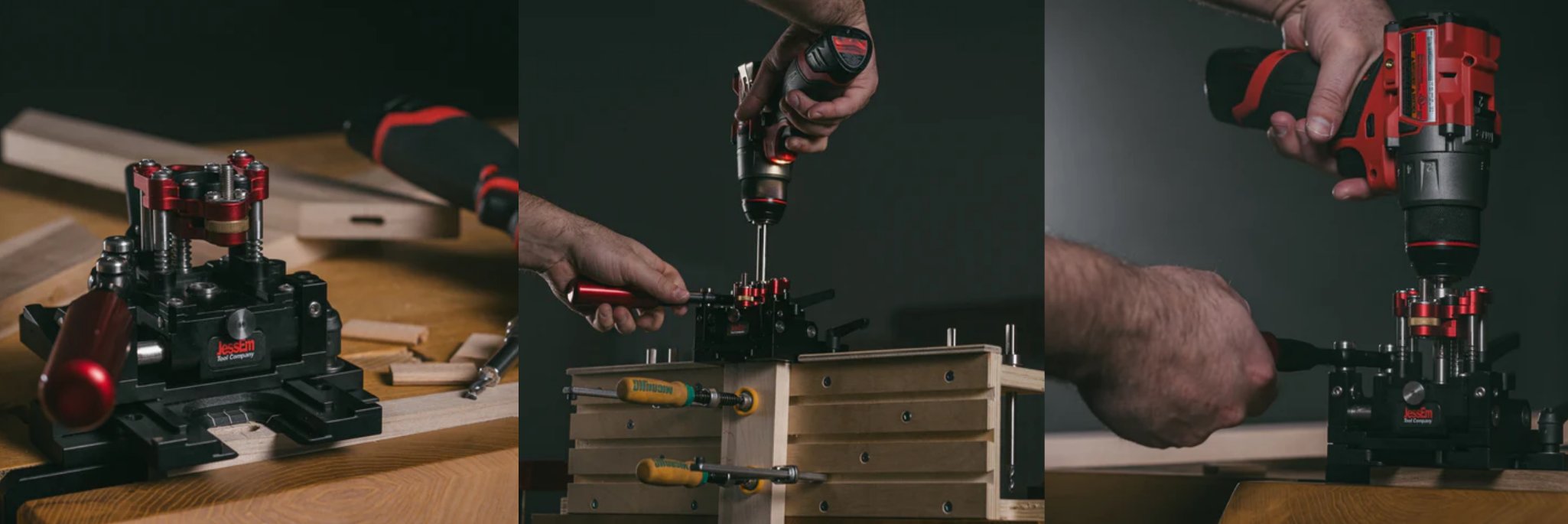

Looks like Jessem added an angle adjustment guide to their Pocket Mill Pro:
📶RF Guy

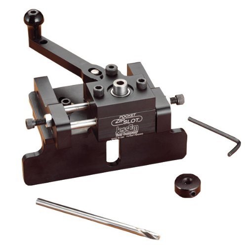

I was unaware that this is the 2nd version of this tool from Jessem. I stumbled across the Jessem "Pocket Mortise Mill" that was available to purchase back around 2013, but went out of manufacture shortly after due to low sales/interest. So, the new Pocket Mill Pro - Loose Tenon System is a revamped version of this older product from Jessem. Online reviews that I found for the original design weren't exactly glowing, so hopefully the new product has improved. I included the video below from someone that owns a Pocket Mortise Mill that describes it a bit more. Jessem indicated that the drop down mechanism for the Pocket Mill Pro steps down in increments of 50 thousandths of an inch on each pass and this mechanism is patented. Presumably this was patented on the original Pocket Mortise Mill design and if so, the patent likely only has a few years left on it then. Hence they are trying to reintroduce this product before this patent expires, or at least that is my guess. Patents are expensive to obtain so this is likely their last chance to capitalize on it before others can copy the design. Hopefully this new one will sell more than the original design for them.
Excerpt describing the discontinued Jessem Pocket Mortise Mill:
JessEm Pocket Zip Slot Mortise Mill Overview
There has never been an easier, more economical way to cut mortises than the JessEm Pocket Zip Slot mortise mill. The JessEm Pocket Zip Slot mortise mill includes a 1/4-inch guide bushing with bearing, a special 1/4-inch drill bit, a stop collar, sample 1/4-inch x 1-1/8-inch hardwood tenons and detailed instructions.
JessEm Pocket Zip Slot Mortise Mill Features
Make a mortise-and-tenon joint fast using a portable drill
Includes a 1/4-inch guide bushing with bearing, a special 1/4-inch drill bit, and stop collar
Also includes sample 1/4-inch x 1-1/8-inch hardwood tenons and detailed instructions
