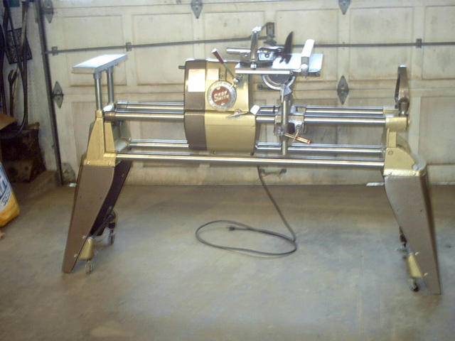

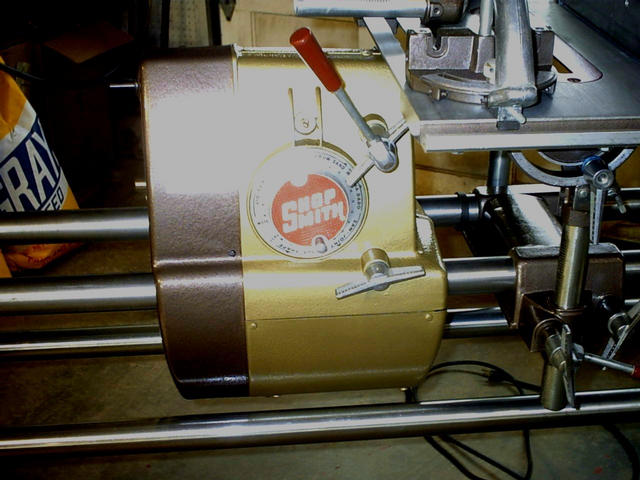

If I did this right here are two pictures of one of my off-color restored Shopsmiths.
Restored Shopsmith.jpg (42.47 KiB) Viewed 5258 times
Restored Shopsmith 2.jpg (57.2 KiB) Viewed 5257 times

Nice looking machine you got there farmer Francis! :D
