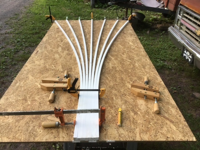

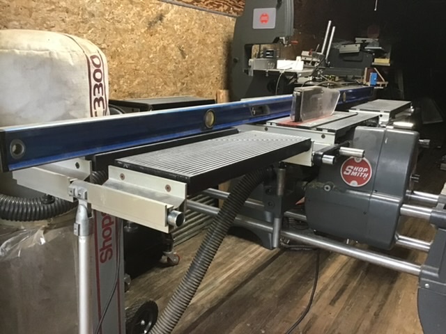

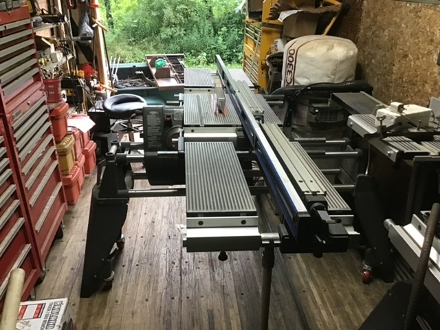

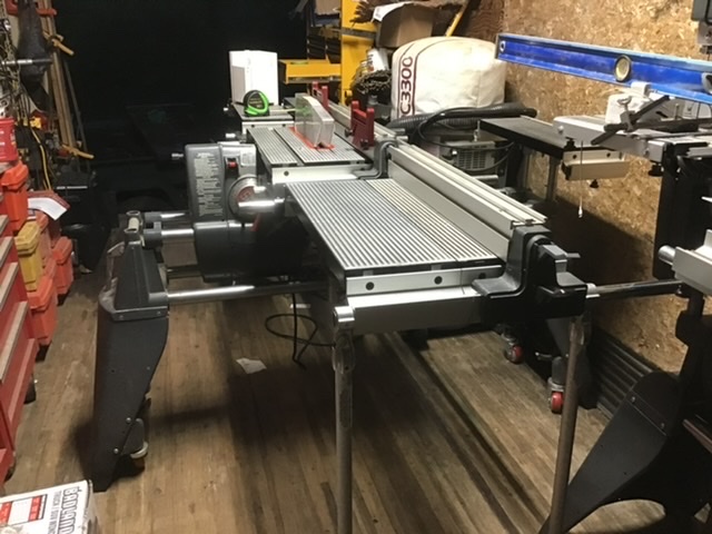

I know I’m late to this. I bought two set when they where on sale so I could do both infeed and outfeed at the same time. I got three 520 table system and this gives me more table place the just off setting the extension table with the floating tables.
At the time I was cutting strip of PVC trim broad to make a few fan style trellises.
My second main table had a damaged rail and the third was loaded down with stuff so I made do with four floating tables
Like the ideal I can use my three main tables this way and the add the floating tables to either or both sides of them for wider tables.
Re: table extension brackets
Posted: Mon Jan 23, 2023 12:07 pm
by chapmanruss
Very creative setup. I like the use of the second fence on the infeed side.
Posted: Mon Jan 23, 2023 12:29 pm
by SkullsquadronX
Hey Russ I don’t recall why I didn’t have the third on the outside. I think it was because I couldn’t slide it in place because the two locking levers wouldn’t hit the one on the main table and I decided I didn’t need it on that side. So I didn’t try flipping the floating table around to see if it would work the other way around.
