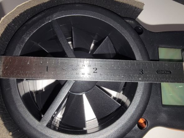

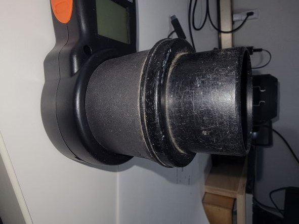

I may have resolved the sealing issue with a piece of self adhesive foam wrapped around the face of the meter.
Port Fit.jpg (40.68 KiB) Viewed 1441 times
Sized to fit.jpg (58.5 KiB) Viewed 1441 times
Quick preliminary test produced 2658 ft/min measured ---(293.57 cfm) calculated. Oh for DC3300 numbers.
Re: Rate of Air Flow vs Volume of Air Flow
I took a measurement on a single port (others closed) with no hose and got 2990 ft/min (330.24 cfm calculated).
I then took another measurement on the same port via a hose and got 2687 ft.min (296.77 cfm calculated).
Both are surprisingly good and warrant verification. I did do a few quick readings with multiple ports open (with and without hose and saw differences that I would expect. Need yet to collect and record that comparison data in a reliable manner. I will do that but not until I am comfortable with the previous results. No value in collecting unreliable data.

Dusty,
I do NOT agree with your calculations. What is the ID of the pipe you are using to connect the anemometer to the DC-3300? It looks like at least a 3" ID pipe. This will inflate the calculation and would only be true if you kept that 3" ID all the way to the tool. Shopsmith uses 2-1/2" dust ports which have an ID of 2-1/4". The only relevant CFM calculation is relative to the final limiting dimension of 2-1/2" dust ports if you intend to connect the DC-3300 up to a Shopsmith tool using a 2-1/2" dust hose.
In reverse engineering your calculations, I see that you are using a 4.5" diameter aperture to calculate CFM. Where exactly do you get this 4.5" diameter from? In order for 2990 fpm to yield 330.24 CFM it has to be a 4.5" diameter aperture, if round. Same is true for the 2687 fpm to yield 296.77 CFM. Can you explain why you chose an area equivalent to a 4.5" ID pipe for your CFM calculations?
📶RF Guy

That suspect pipe is a coupling from an old DC3300 2 1/2" coupling. Now the 4.5" number may be suspect. I assume you come to this conclusion as a result of my using 2.25" measurement in my calculations. That number is intended to be the diameter of the coupling between the meter and the DC.

dusty wrote: Sun Nov 27, 2022 12:50 pm That suspect pipe is a coupling from an old DC3300 2 1/2" coupling. Now the 4.5" number may be suspect. I assume you come to this conclusion as a result of my using 2.25" measurement in my calculations. That number is intended to be the diameter of the coupling between the meter and the DC.
Dusty,
CFM = (fpm * area)
You measured 2990 fpm.
Assuming a 2-1/2" port (2-1/4" ID),
A=πr² and d = 2 * r (for a circle)
So, area = 3.14159 * (2.25/2/12)² = 0.027611631 = 0.028 ft² (rounding up)
Therefore,
CFM = 2990 fpm * 0.028 ft² = 83.72 CFM for 2-1/2" hose aperture.
NOTE: In area calculation above, 2.25" is divided by 2 to go from diameter to radius. Then it is divided by 12 to convert from inches to feet so that units align with fpm in CFM calculation.
P.S. I still think something isn't quite right with your airspeed (fpm) measurement. I get almost 5,000 fpm out of a 2-1/2" port on my DC-3300, so I am surprised that you are measuring about half that with your anemometer. Airspeed is measured and not calculated, so I don't understand why you are only getting 2990 fpm.
