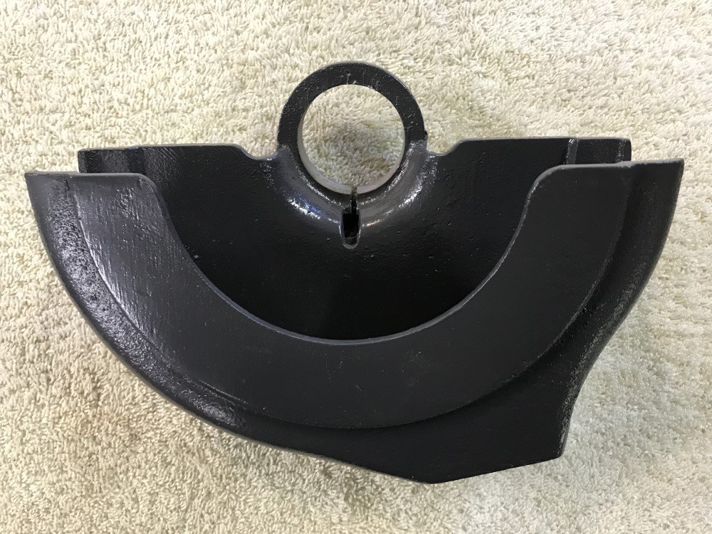

Model 10 Lower Saw Blade Guard.
_
- 162-1X - 12 370 R r.jpg (189.5 KiB) Viewed 30412 times
